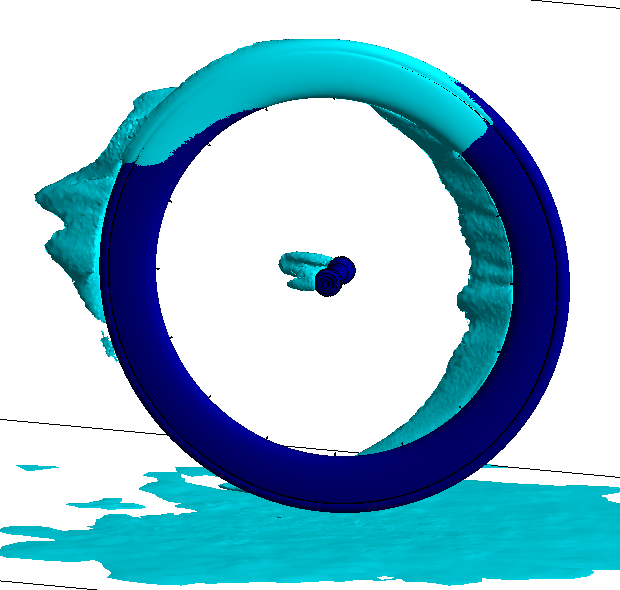

Fair enough. Based on the discussions on this thread, I had some interesting stuff to share like the turbulence patterns off a 404 firecrest or:
or, for those wanting numbers, the drag of a 404 firecrest at 12.5° yaw appears to be 75grams.

In Reply To:
Sorry for raising the thread.
Just curious, but that's a rotating wheel model right? Did you grab the shape off of the cross-section pics that were published?

Rotating wheel(well, moving walls), cross section as shown on zipp site.

Have you also modeled the legacy shape or the V-rim they also show in that graphic? That might provide some interesting comparison.
Was the tire a generic shape or based on some known profile?
