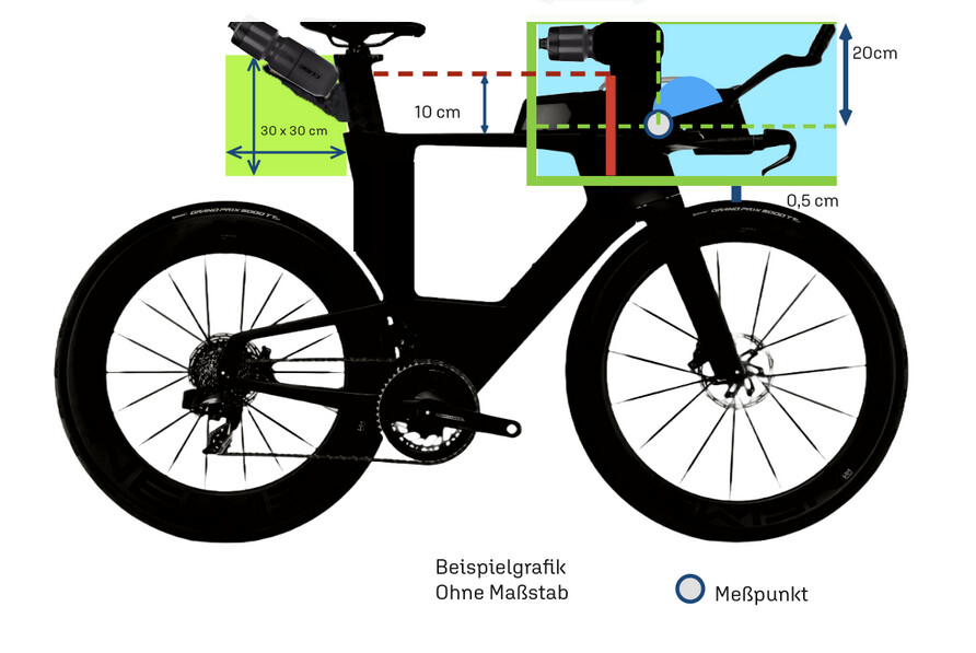

“this box ends at the upper part of the seatpost… which is documented in the rules”
Please share the relevant element of the rule you say is documented. Is this said in the DTU Rule interpretation?
“the front responds to the lower edge of the armcups.”
In the video the demonstrator places the corner of the perspex rectangle on the upper side of the arm rest (ie where the upper forearm rests in the example shown) not on “the lower edge of the arm support”
World Tri interpretation doc: “When measured from the lowest edge of the arm support (if none exists, the lowest edge of the athlete’s elbow in the rider’s intended aero position),”

i am referring to the picture shown in dtu rules…the judge also referred to this picture and the green box. the upper edge of the box ends at the top plane of the seatpost.
This is why he argued with the athlete even no written rule is established. Sorry for my bad english, it seems hard to understand my written posts.

dtu have two templates 30 x 30 for the rear…and one for the front…they are all handmade by the judges themselves :slight_smile: more or less correctly

DTU Rules have been linked upthread by @marquette42 . They seem a faithful translation of the World Tri Rules/interpretation, or vice versa.
The 300x300mm box is both virtual and positioned and orientated merely as an example (“Beispielgrafik”): its lead (front) edge is defined as passing through the attachment point of container/cage to the seat tube, seat post or saddle.
DTU: Grundsätzlich:
Die Regelung für das Heck gilt ab der Sattelstütze entgegen Fahrtrichtung.
23.6 (google translate)
Fundamental: The regulation for the rear applies from the seat post [backwards].
a. Rear: All attached holders, containers, bottle cages, etc. must fit completely into an imaginary box of 30x30cm.
Note the footnotes: “Beispielgrafik” which even my poor German can manage as: 'Example graphic" i.e. this is where a virtual 300x300 square could be placed, defined by its dimensions and passing through the attachment to the seat post. “Meßpunkt” is “measuring point”, the reference datum point (“gemessen von der untersten Kante der Ellbogen-/Armauflage”).
