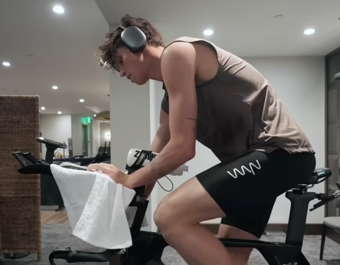

That’s going to be one messy trisuit by the end of the race. :rofl:
It’s hard to tell where the back of the scoop is because of the towel, but from this angle it looks like might be fine?

Here’s a better angle. He probably can just move the whole bottle forward a few inches and be fine though.
With that bottle size it certainly does seem to be illegal, but I guess we’ll just have to wait and see what the bikes look like on course in San Fran this weekend.

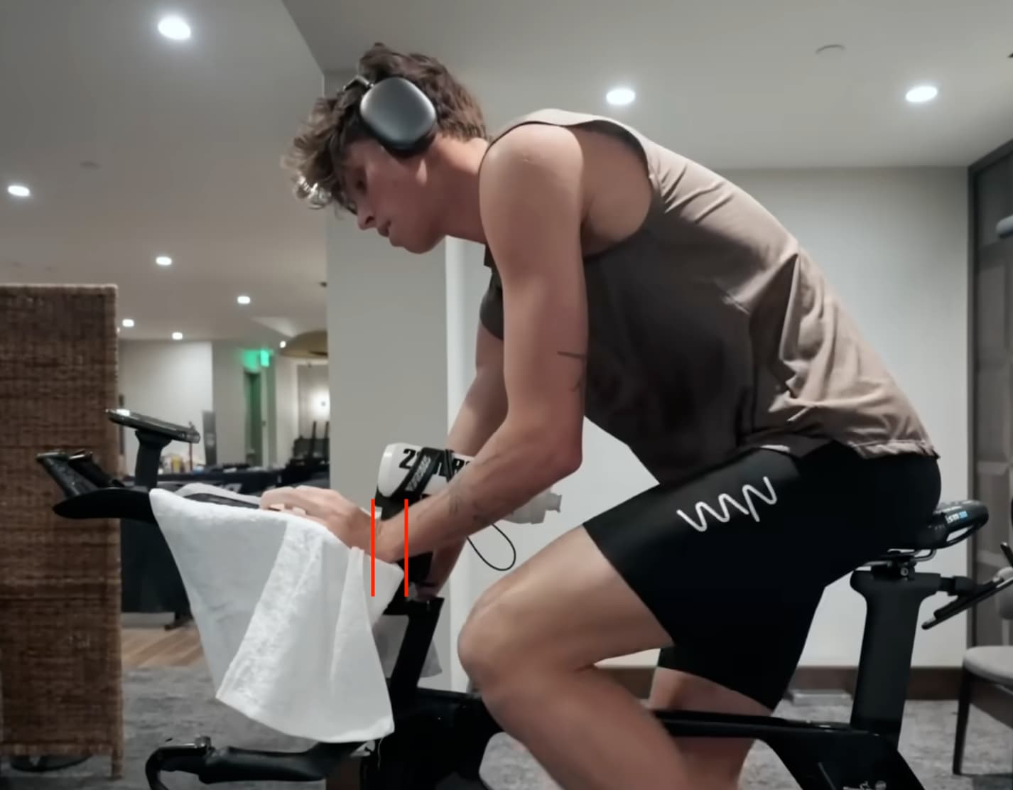

Right, but you can’t really see where the “lowest edge of the arm support” is, and that’s where the measurement is taken, not from the elbow (that’s only when there’s no arm support):
When measured from the lowest edge of the arm support (if none exists, the lowest edge of the athlete’s elbow in the rider’s intended aero position) […]
So I think this one might be fine because the end of the bottle is in front of the back edge of the arm scoop (assuming it’s under the towel where the second line is).
Anyway, I think you’re right that if it’s not within spec it should be an easy fix.
Note that the interpretation document specifies the datum point as:
“the lowest edge of the arm support (if none exists, the lowest edge of the athlete’s elbow in the rider’s intended aero position),”
NOT the “back edge”. (Because otherwise one could circumvent this restriction bay having a massive ‘scoop’ extension on the arm rests.)
