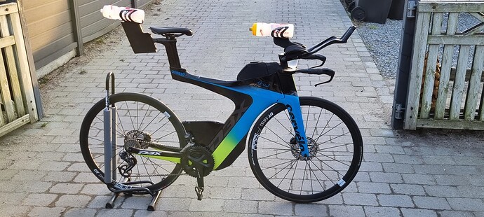

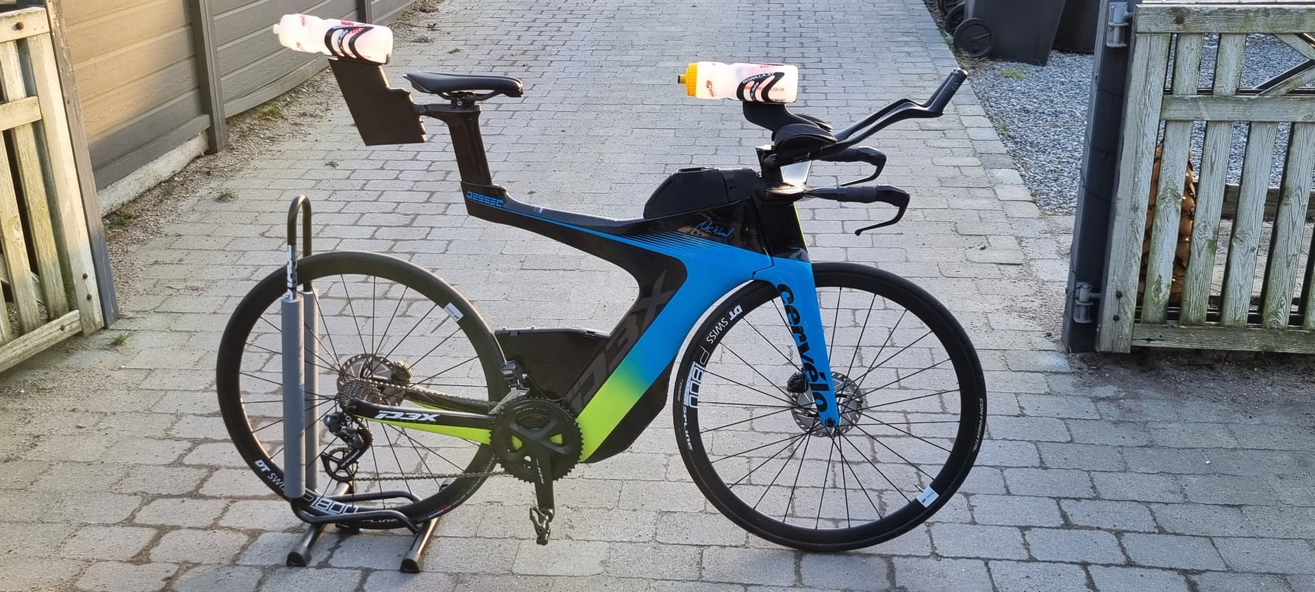

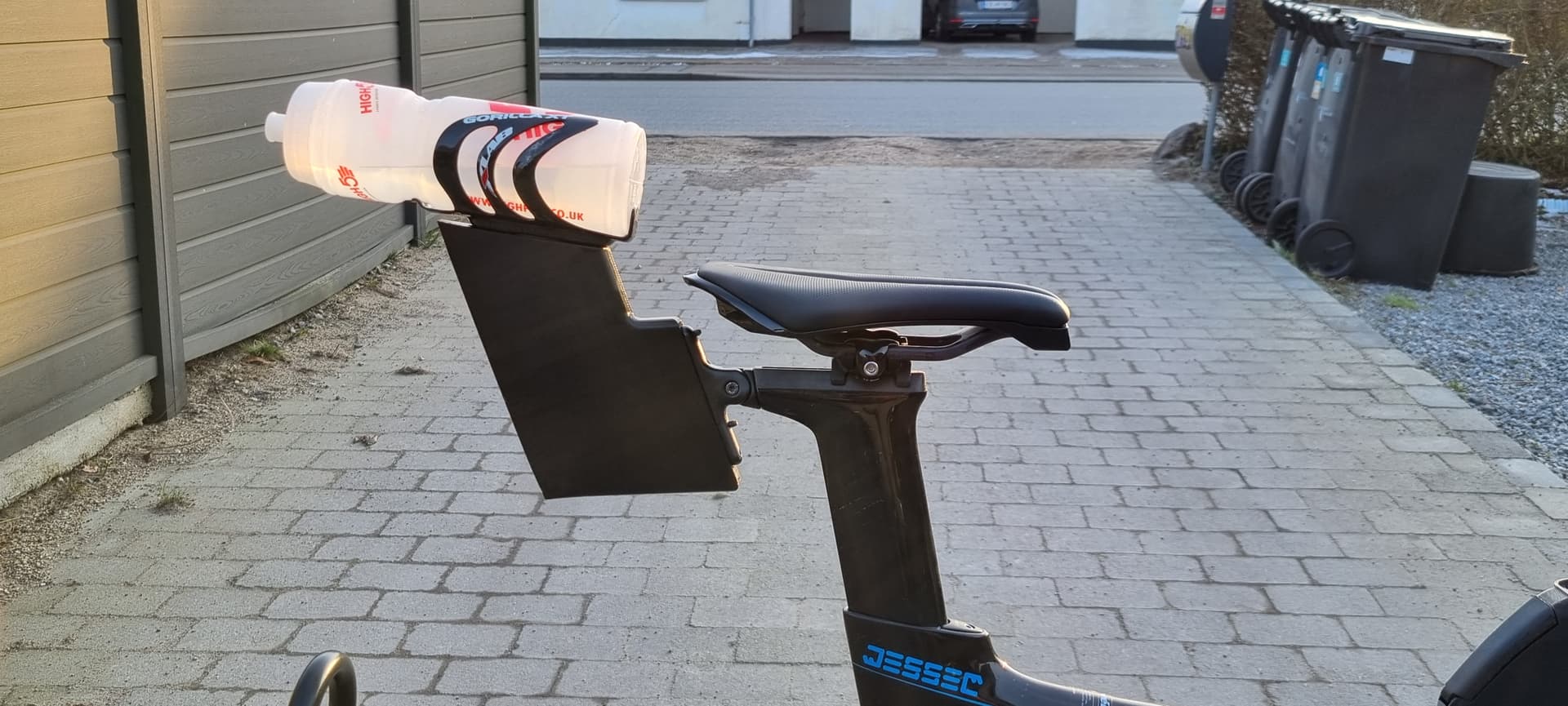

I am in doubt, would this be a legal setup, with my cervelo p3x?
What if i used my internal blatter setup?
Thank you - I reckon you have nailed that. The no rear bottles rule applies only if frames have internal frame liquid storage AND rear-mounted storage.
“AND” Cue further discussion. Want to prohibit a bloody great sail AND two rear bottles.
