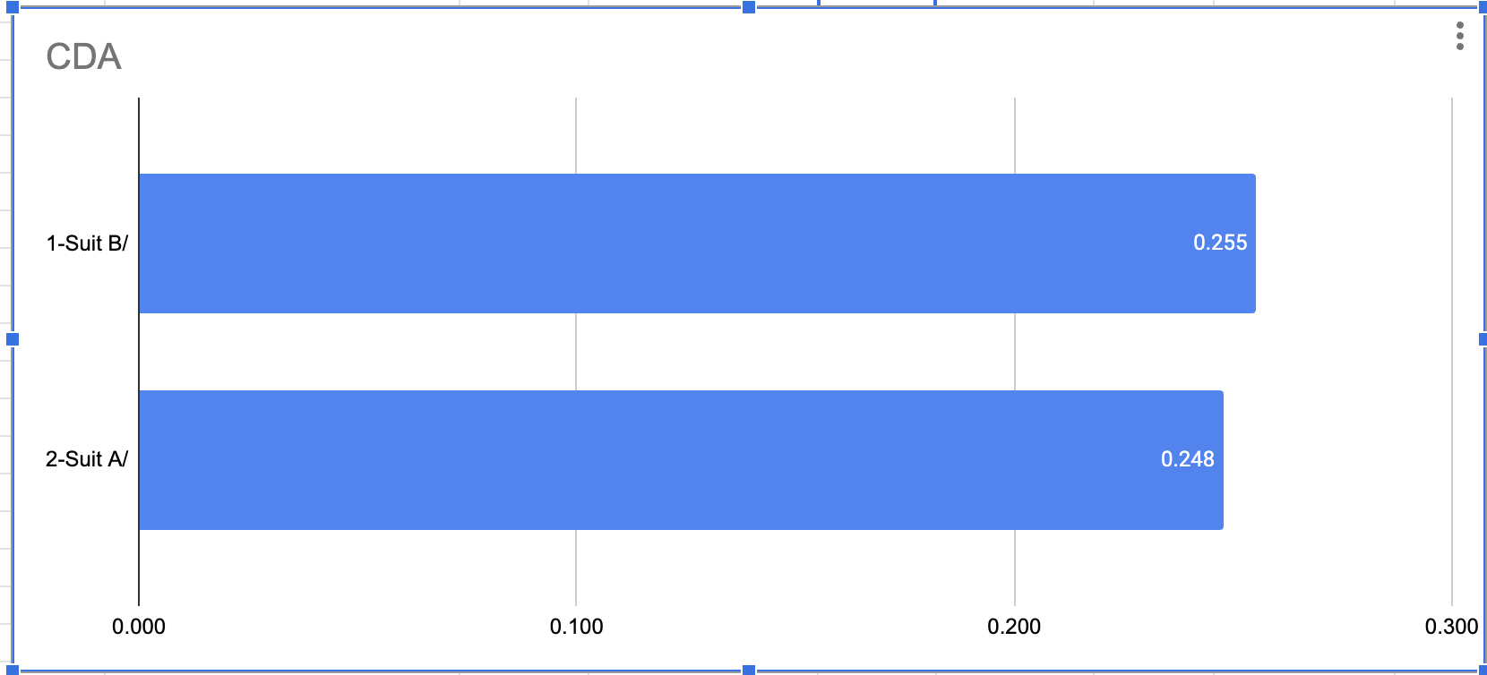

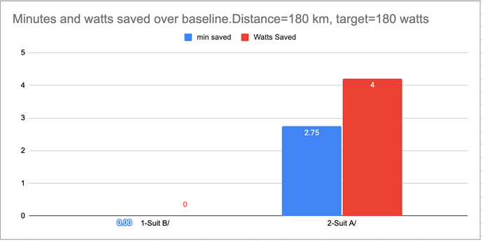

He REALLY likes his Blue Noosa tri suit. In his mind, his other kit, Black Vanquish suit is black and like so many AGers, “how much difference can a suit make”. So I “convinced” him to test today.
2 runs Blue, 3 runs Black, 2 runs Blue
So his beloved “Blue suit” was costing him 2.75minutes at his IM pace
I told him, he looked at me, put on his running shoes and went running for 20mins, came back, “Black suit it is”
Eventually I can tally up all the 3 and 4 watts

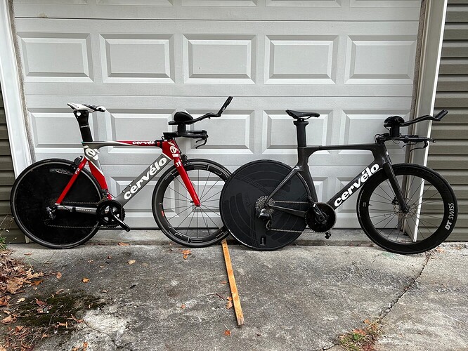

In the month of August I started benchmarking my 2024 Cervelo PSeries (size 56) against a 2025 Ventum Tempus my buddy got for IM Canada. Later I decided to bring my 2009 Rim brake P2 into the comparison. There were over 20 days of testing.
When I started I just tried all 3 bikes “as is”. The PSeries had a decent cockpit (PD Aeria) but was a little messy on the cabling.
First tests done on the Ventum were on a super clean bike but slightly off in terms of fit. I took my buddies fit and my saddle height. He rides shorter, higher.

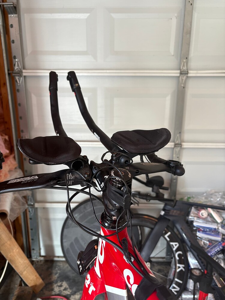

The P2 was a mess in cabling
But all along, the bikes tracked pretty close. There was never a “20 watt difference”.
I slowly cleaned up the bikes and zero’d in on optimal setup, fit and components.
At the end of the exercise the bikes are really really close. I did final tests, skin suit, race helmet…
At the end PSeries got gold, Ventum Silver, P2 bronze, by very little, but not because they are faster in that order. I will explain

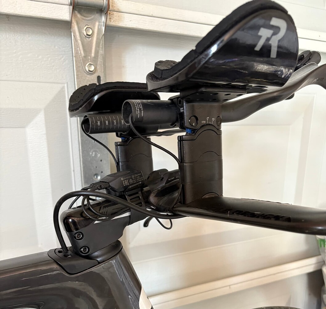

However the PSeries was upgraded with a PD ultimate bar which cleaned up the cabling and allowed SAFE extenders for the reach. Sketchy extenders scare me.

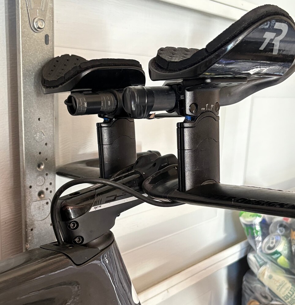

In the back and forths, the profile design ASC 53 and ASC Pro ended up being compared. At first I didn’t see it but eventually tested a bit faster and was more comfortable. The ASC Pro came with the Ventum. I need to convince my buddy he doesn’t want them.

this was the P2 pre cleanup
the PD bar allowed to move many of the cables internally. A move to SRAM would get rid of the DI2 10 speed junction box taped to toptube. The is the PD ultimate bar

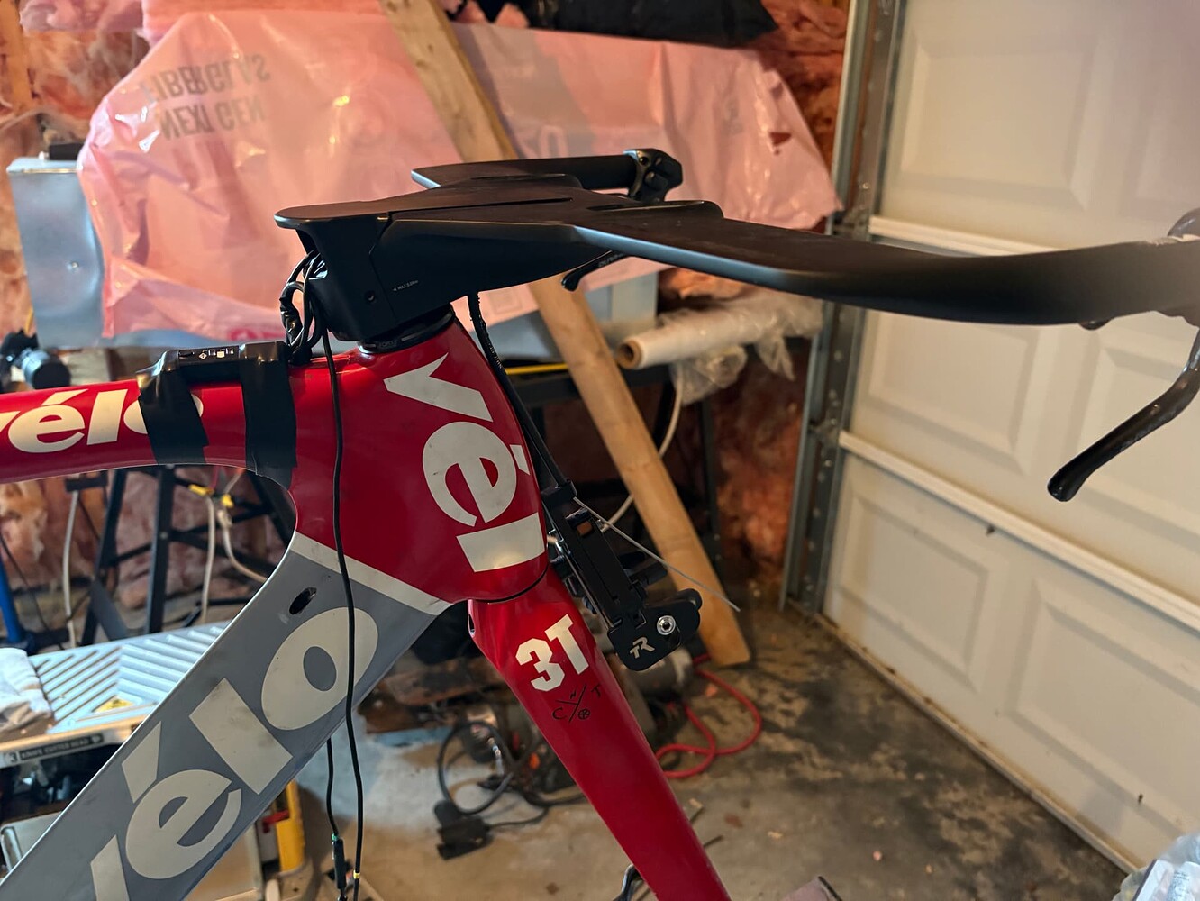

PSeries pre cleanup
Got rid of blipbox
Got rid of all cables. I do need a new cap to hide that last cable behind the stem (on order). It has to be dremelled.

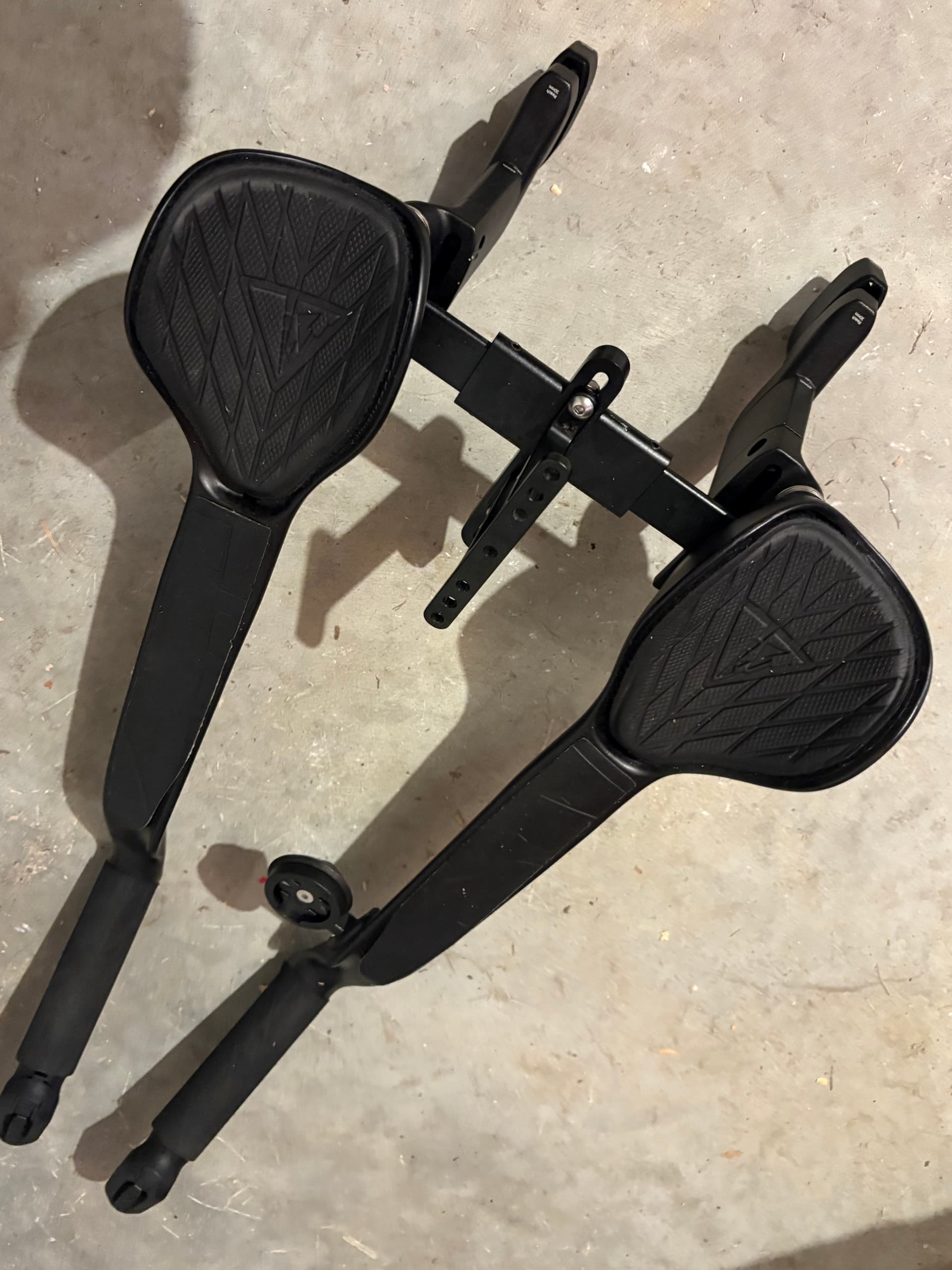

this cockpit, taken from the Ventum is the ASC pro and ended up testing a bit faster

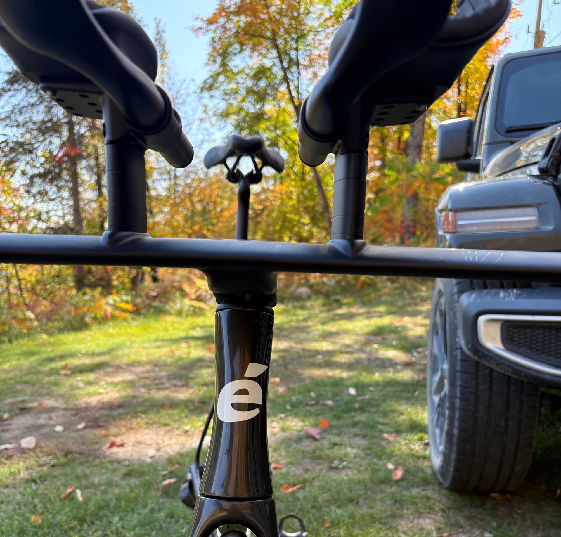

No cables anywhere

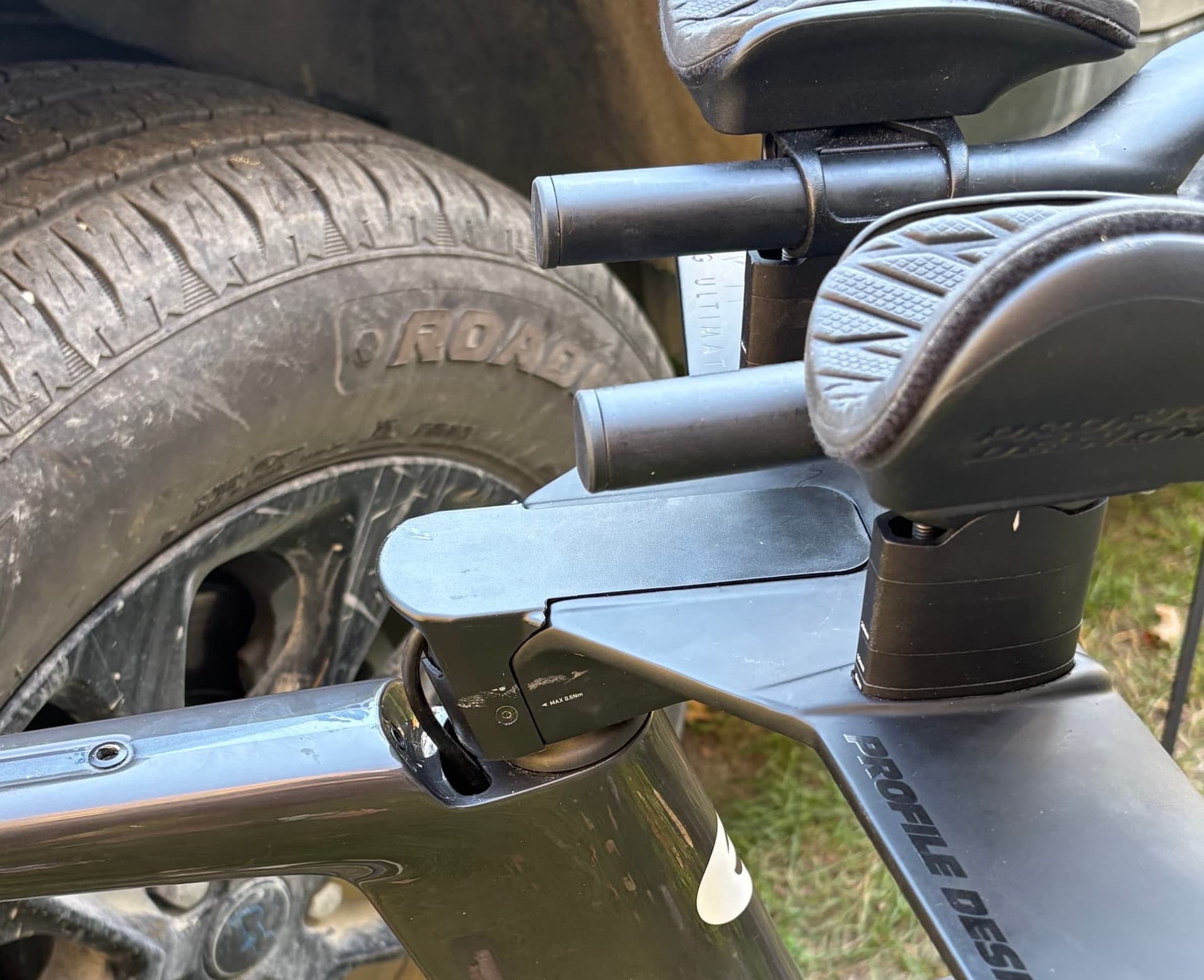

Did you test both bikes with the same aerobar angle? In the picture they are quite different.
But a great write up and again it is proven that it at least seems we are at aero peak on bike design.
Jeroen
But what if we like data……
Any chance of a table showing the steps of time gains?
yes absolutely. Those pics were taken early in the process. As I said, I just rode what was there
but as I progressed I made sure the bikes were as identical as can be. As a matter of fact the differences at first gave me ideas of test routes to go down.
