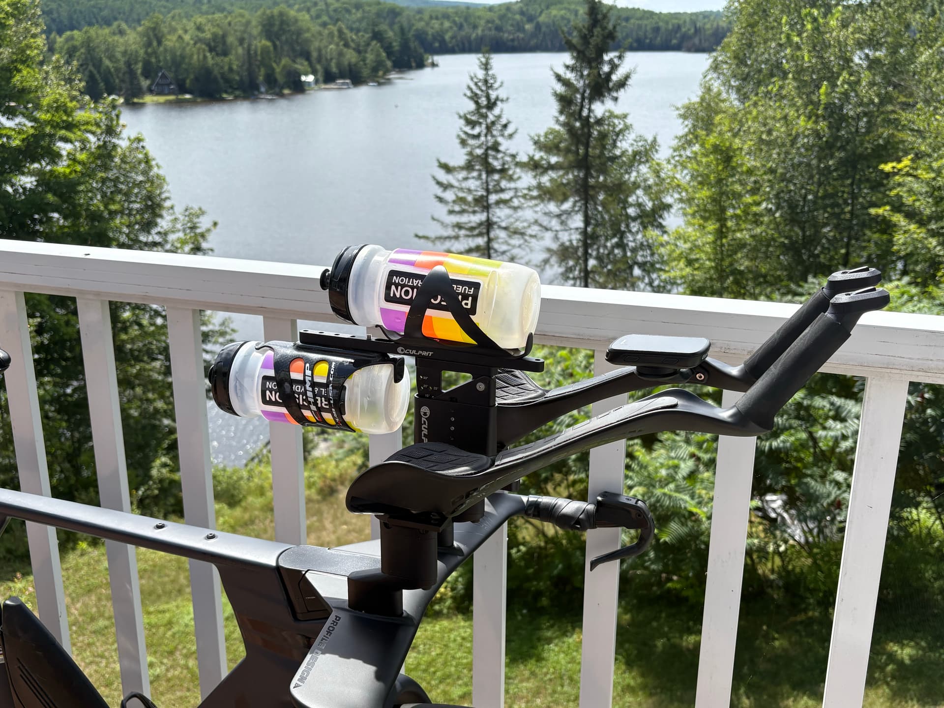

Glenn is on the Tempus with the ASC Pro. Getting a BTA to work was a struggle. We couldn’t find a good BTA for it, but the guys from @culpritbicycles and @anon62099856 saved his Canadian Bacon. This thing is UBER configurable.

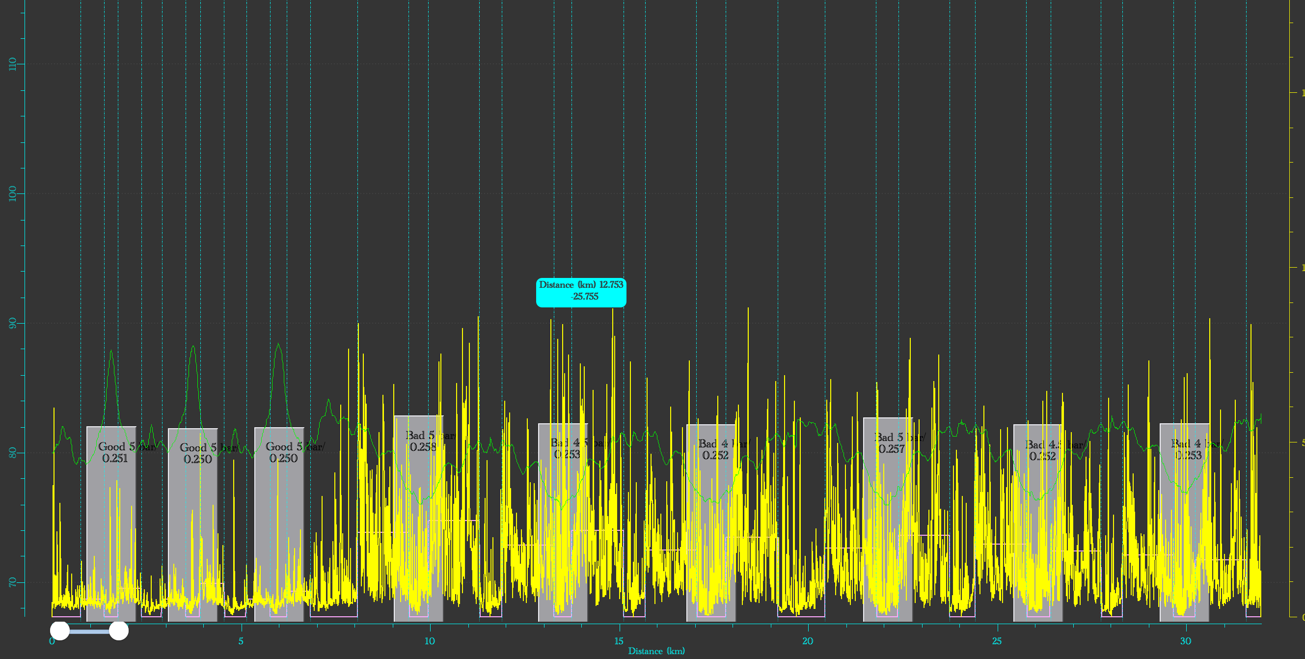

So we needed a unit called a ONJ (Olivia Newton John). For the geeks it’s just the standard deviation of Z axis. We have several IMUs this is just one.
Here are 9 runs. The first three are done on a good road at 5bar.
Then I go over to a really bad section and do 3 runs at 5 bar, 4.5 and 4.0.
Then I repeat that (5, 4.5, 4.0)

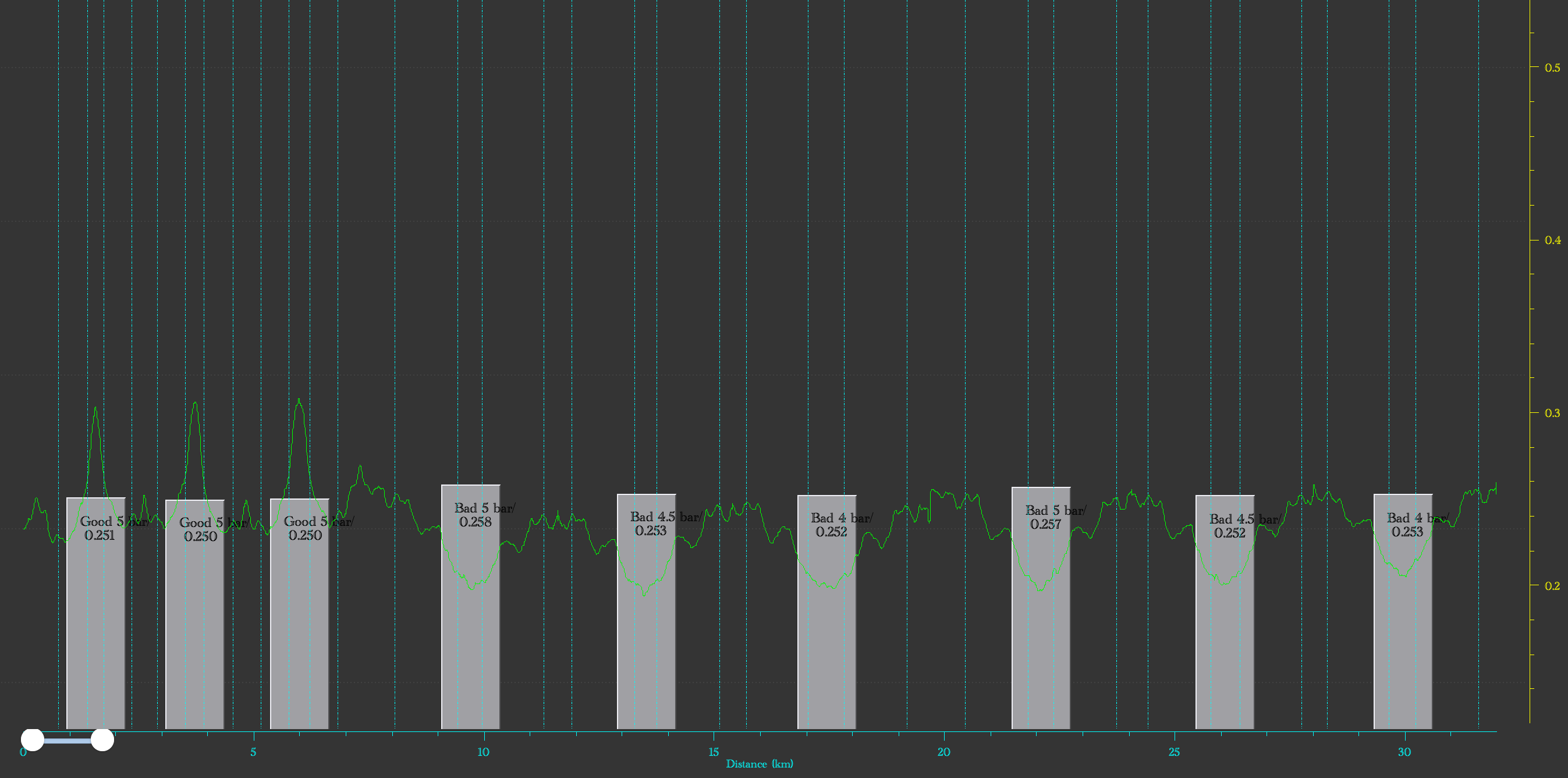

I should not be using CDA for these bars, I should probably use CRR watts, but anyways, smaller is faster. We see the bars shrink as pressure drops

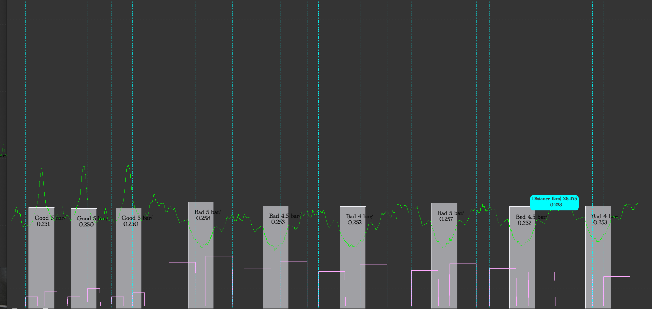

What about ONJ ? Here I overlay the ONJ data
Obviously more bumpy
If I average the ONJs over the out and backs, they you see the pink lines
The Back is higher than the out because the roads are rougher. We see the ONJs going down with pressure, although there is a certain amount of I don’t ride the exact line every test.

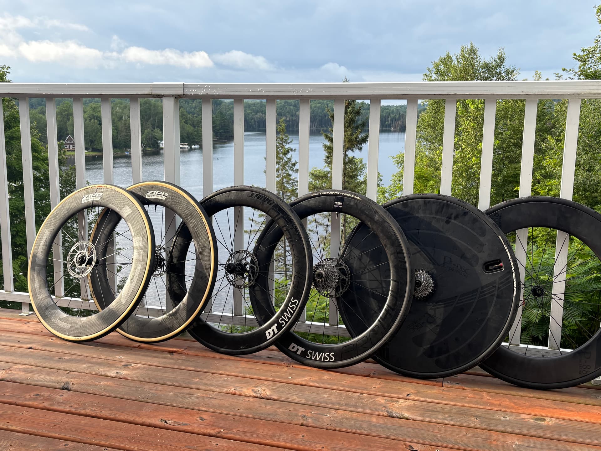

Wheels tested.
Final decision = DT Swiss front, Premier disc.

Why not the Premier front? Too deep for crosswinds?
the DT was marginally faster. From a $/watt perspective the Premier easily wins, but having both, wth a very slight performance and maybe a bit better handling in crosswinds he went with the 60mm wheel, I use the 88 for TTs
The zipp was slowest, about 3w slower than DT for the pair
