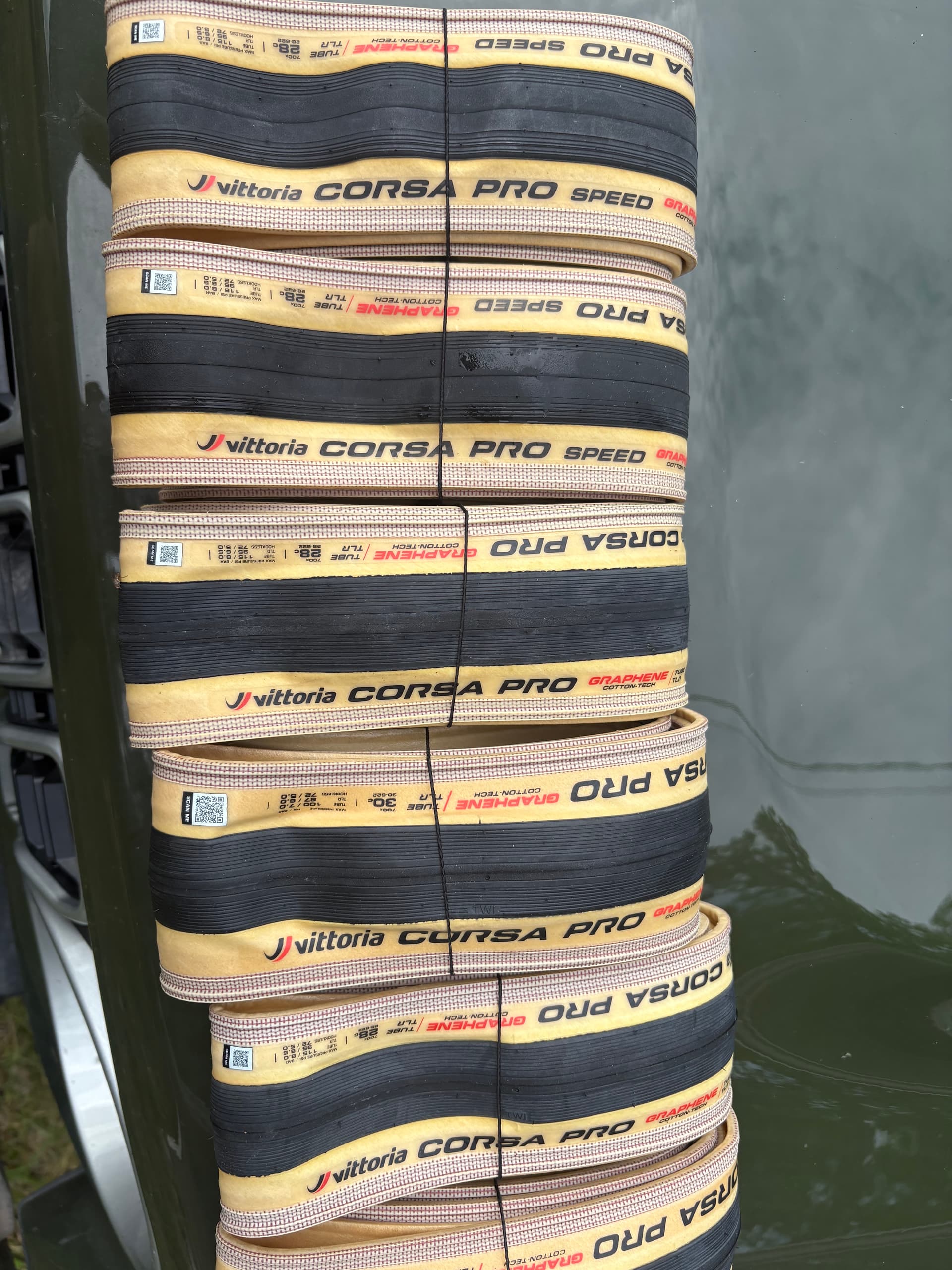

A few tires (5000S, 5000TT, Corsa Pro, Corsa Pro Speed, Pirelli and maybe Schwalbe)

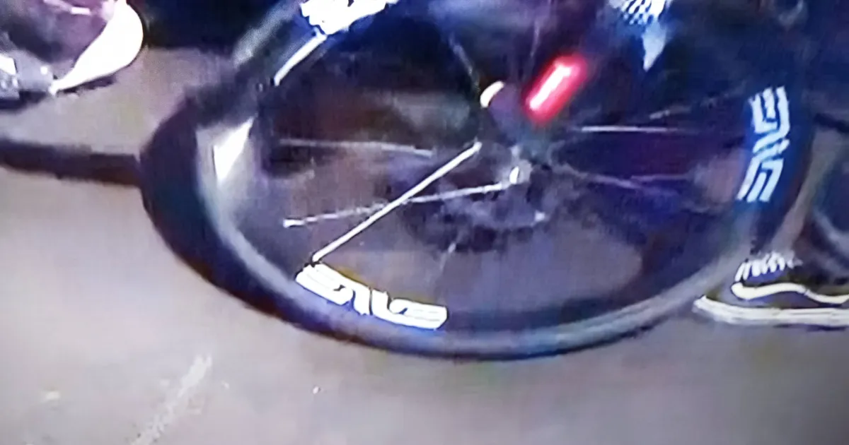

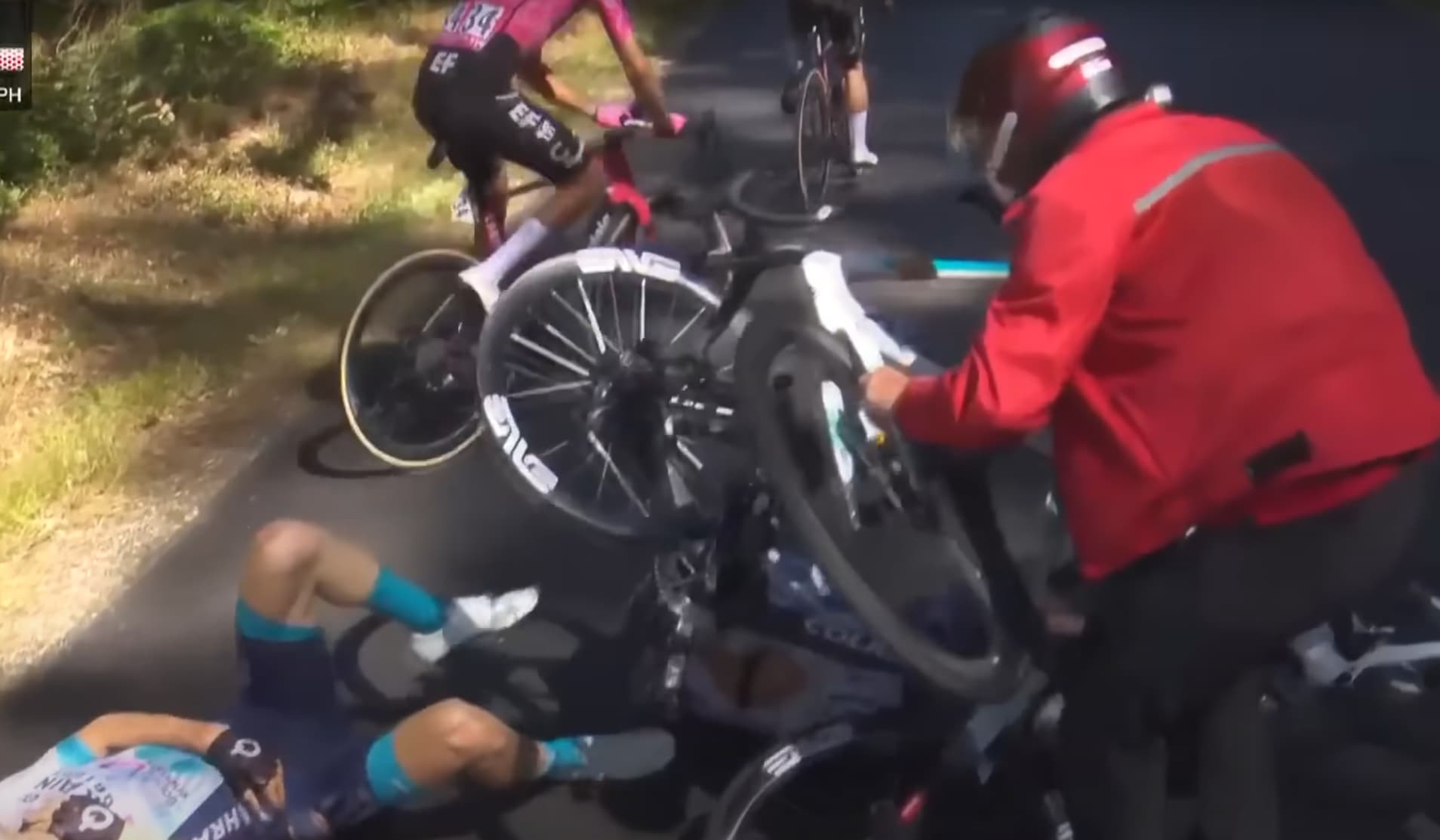

Almeida’s tire definitely came off, no question about it. Folks act like we don’t have 100+ years of seeing glued-on tires blow off rims when bikes go sideways at speed.
Just fwiw, you can see the rim sans-tire here, being pulled off the top of the Bahrain guy by the moto driver -
Also fwiw, after fully Zaprudering the video, I think Almeida may well have gone down first, regardless of what I heard from folks who were there and the fact that Almeida’s bike wound up on top of the BV guys, but nobody is pulling anything definitive from the vid footage.

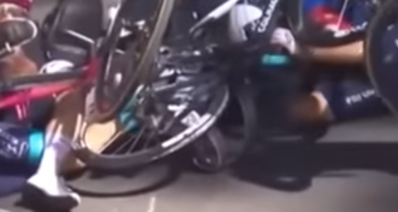

I think the biggest thing I take from it is that the tire seems to have completely disappeared (not with bike , although it’s hard to tell)
Which means it’s had a serious blow out/failure and been snapped in half otherwise it would still be within the bike frame
Nah, it’s there…
…just wrapped around the chainstays down near the BB.
You got 5000TT and Corsa Pro Speed in 30mm? Any hint on where to obtain those? Also Pirelli TT tyres in 30mm or those are their road race tyres?
Hmmmm, waiting for another batch and you are right, no speed 30. Now I question if they exist. If not, good, one less test. Still waiting on new Conti and it seems TT30 may not exist. So maybe I throw in some Schwalbe I have. He will use the fastest we have. Not buying any more tires :rofl:

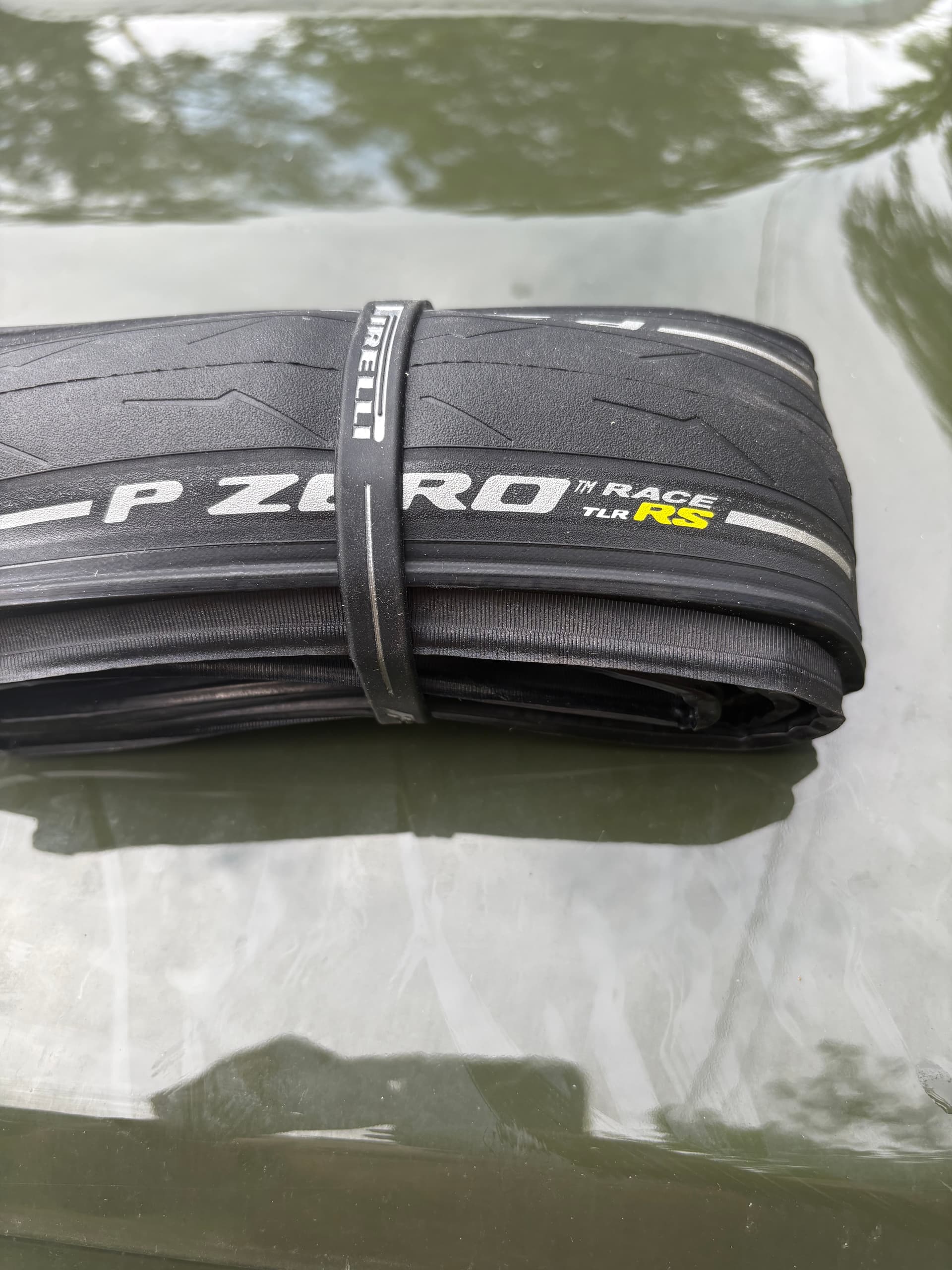

these are the pirelli

Makes better sense - Archetype seems to be the first/only TT-type tyre of more than 28mm (not counting the stuff re-labelled 29mm to officially pass ETRTO 25mm inner width requirements). And the RS I wouldn’t say is Pirelli’s TT tyre, they have one specifically named TT - but again, only available in 26mm and 28mm.
The pirelli were gifted by a pirelli sponsored athlete that I gravel tested. I do some kind of experiment every day it doesn’t rain so I may eventually run out of things
