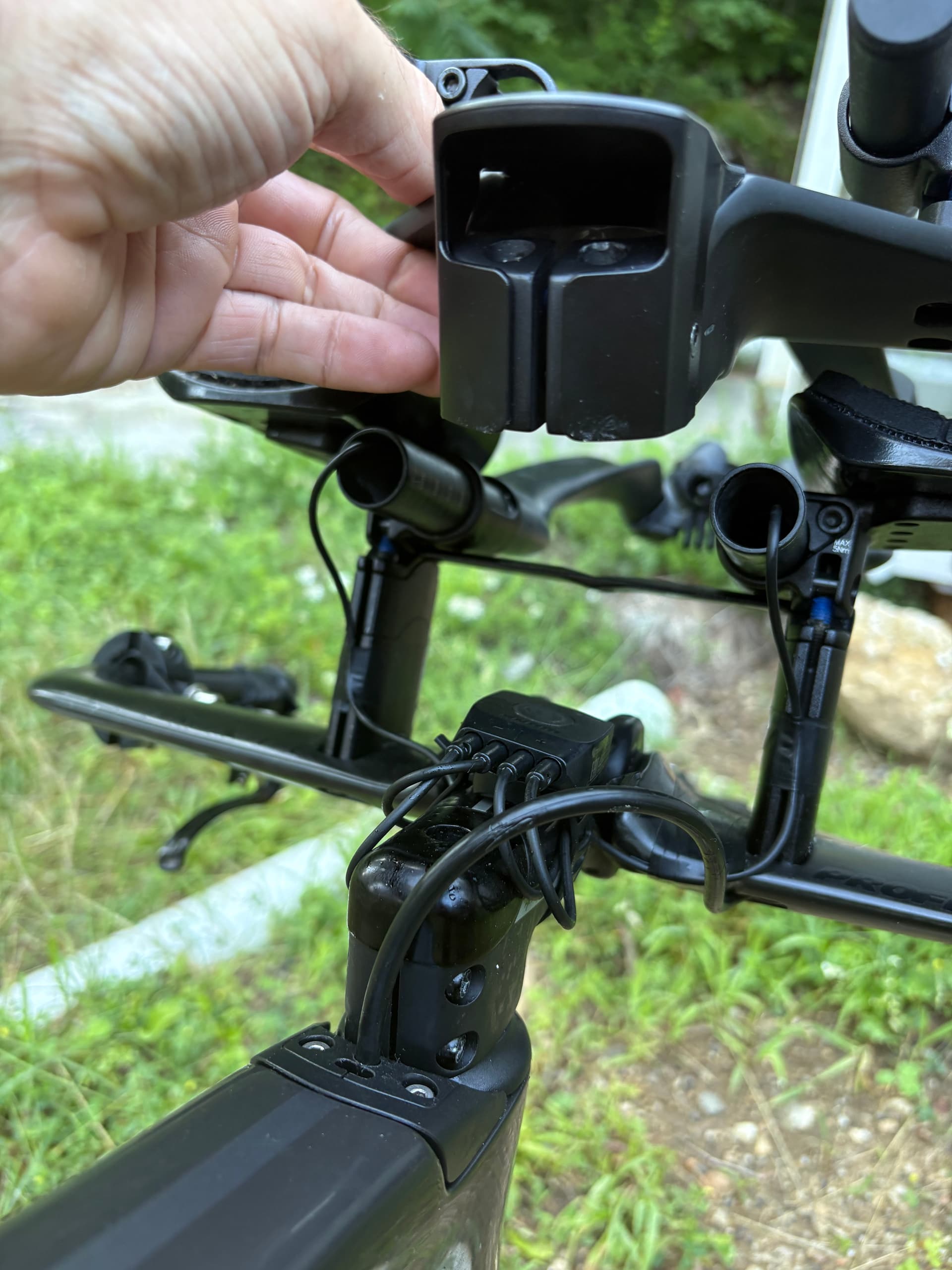

The P Series currently has the Aeria basebar and ASC43 extensions. i did benchmark this against a bike 3x it’s price and it was a tie, although it’s almost impossible to get both bikes identical. Fit was identical.
99.9% all cable will be hidden
At the bottom of the pick you see the rear cable exit my old bar and re-enter the frame
At the top is the new bar. The cable will come out from that cavity and go straight down into the frame.
Blip box will go
blip box can fit inside the new bar, although I’m not sure whether the AXS cables can make it from the riser into the bar, the plugs are quite long.
