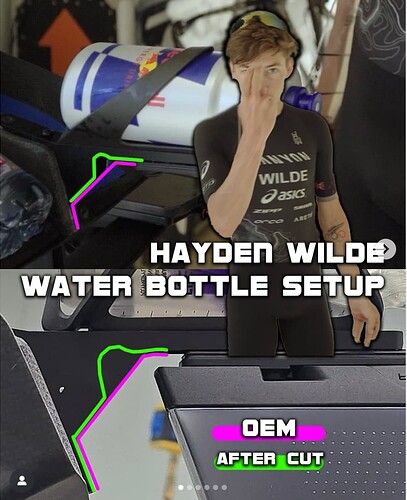

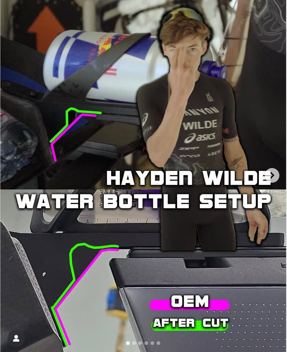

BUT in the microvideo Wilde is using an incorrect reference point for the front edge of the 25cm template.
The reference point the lowest (under the elbow point) part of the arm rest, not the rear ‘edge’. Otherwise one could just extend the armrest a few cm to get the ‘extra’ distance for a bottle.
So even this new Canyon aero bottle position, with the cut out after Frejus and in time for Oropesa del Mar, may be illegal Would need informed visual inspection rather than from video images.
Danger of knocking bottle off when in BTA position is a fair shout. In which case why not leave the bottle on the down tube: access is not improved when lifted, upside down, BTA.
WT Interpretation doc: “When measured from the lowest edge of the arm support (if none exists, the lowest edge of the athlete’s elbow in the rider’s intended aero position)” Image below is from the ‘hydration/fairings’ thread hopefully illustrating the correct reference point.

Actual wording is “When measured from the lowest edge of the arm support (if none exists, the lowest edge of the athlete’s elbow in the rider’s intended aero position)”
The lowest edge of the arm support is what Hayden pushes it against in my interpretation.
It probably should always be the lowest point of the elbow (to avoid extending the arm supports backwards like you say) but that is not the current wording. Presume they chose the lowest edge to make it easier to check.
Yep. Without visual inspection I cannot tell from the images whether Wilde’s armrest curls up slightly* (most do, including the Canyon cockpit I’ve checked) or whether it carries on down, thus making the rear edge also “the lowest edge”. Other athletes at the sharp end have been careful (and made effort) to ensure their set ups are clearly within the rules. Worth noting that this interpretation is a World Tri doc and no IRONMAN rules refer to it. But Wilde is subject to WT Rules for ‘all’ his draft illegal races.
  • If it doesn’t curl up after the elbow it’s a fairing. There is no structural or functional reason for extending it down and rear.
    Dragging this across for the image:
From the T100 preview video:
This is the reference point as defined not the rearmost edge of the armrest (obv imho):
at 7:05
The top bottle cage with a one litre bottle fitted (which is the implementation criterion) is also illegally positioned, or on the limit (depends on reference point choice).
