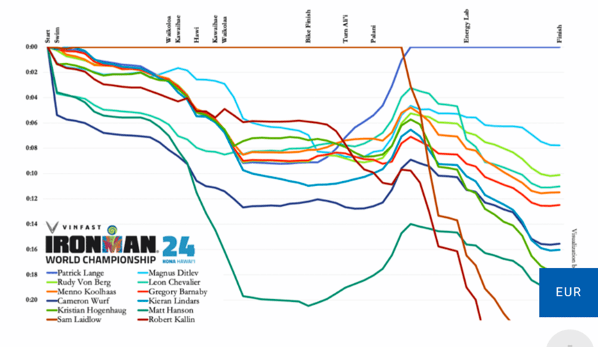

Via Thorsten, here’s the timing chart. He’s only showing the top athletes, but even here you can see that it gets broken by Waikoloa. Lange comes into T2 with a group of 9 or 10, depending on how you count gaps. And this is the race where the biggest groups happen since the pandemic.
Anyway, my larger point is that this isn’t necessarily a problem. Large reported being barely able to hold on, and subject to considerable yo-yo effect. But the race itself was very entertaining - you had Laidlow and others off the front, Ditlev’s recovery and massive blowups from a lot of guys.
