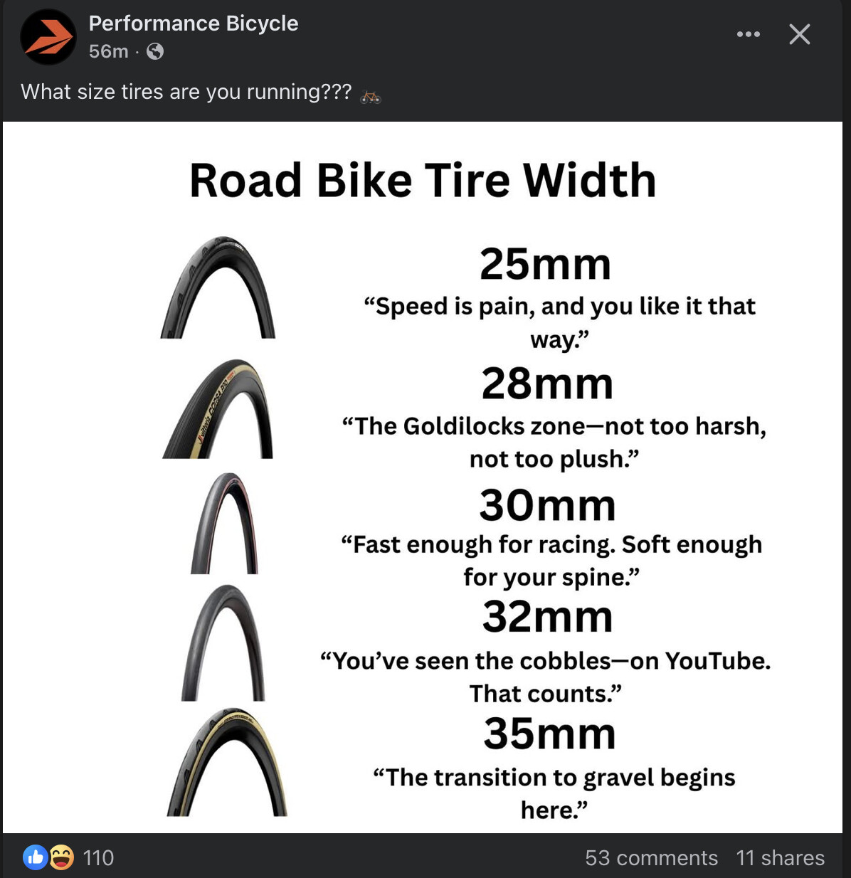

Presented without commentary:

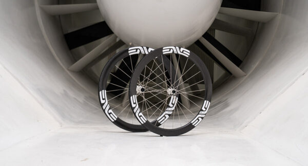

In any event, as it was well said above, sharing this without commentary (forgive me if this is out there somewhere else):
