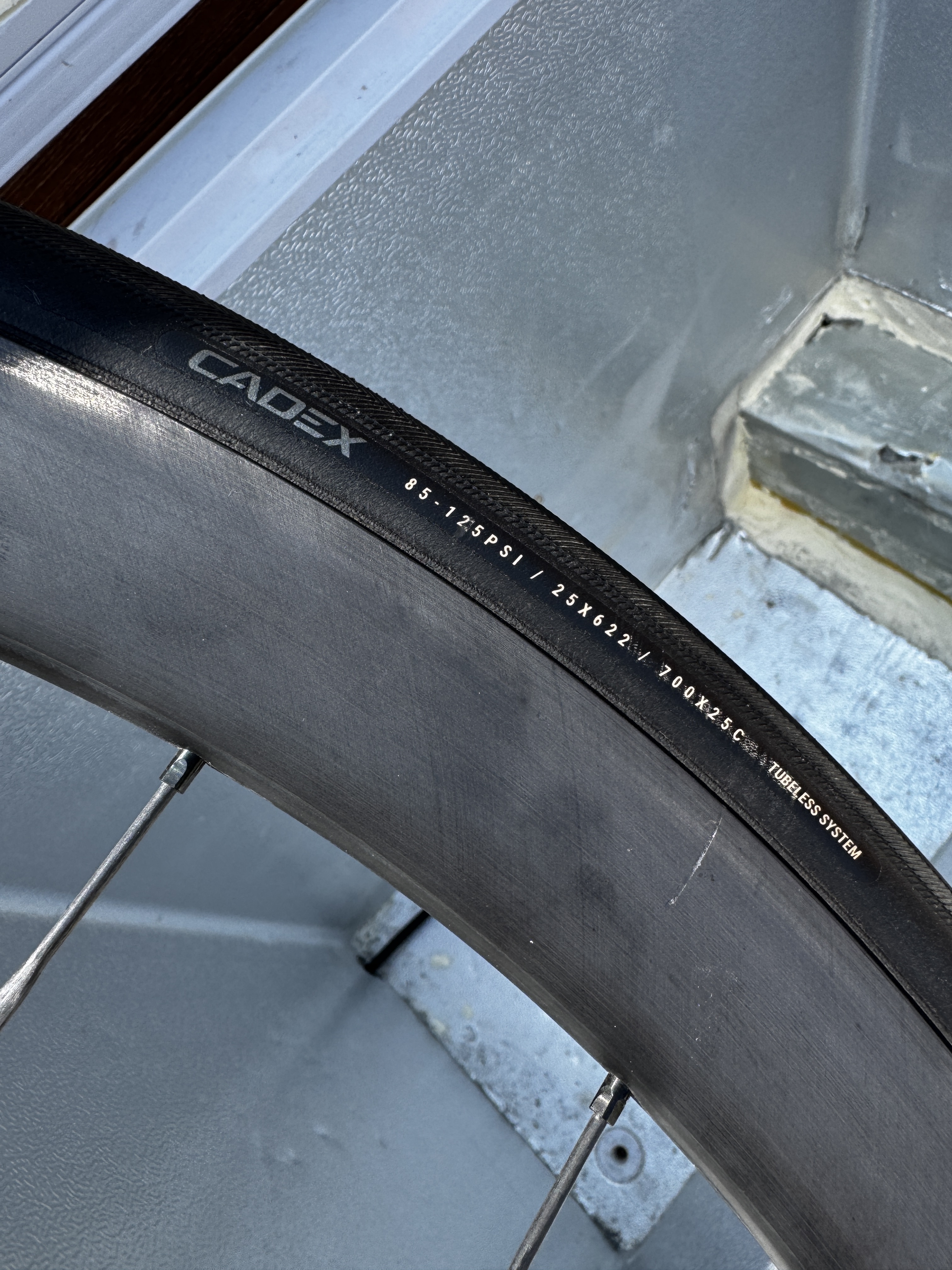

It would be good to run a popular tire not on their preferred list.
Like a Conti 5000 TT

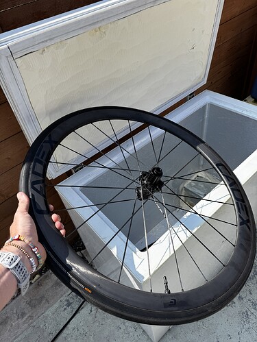

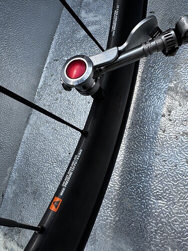

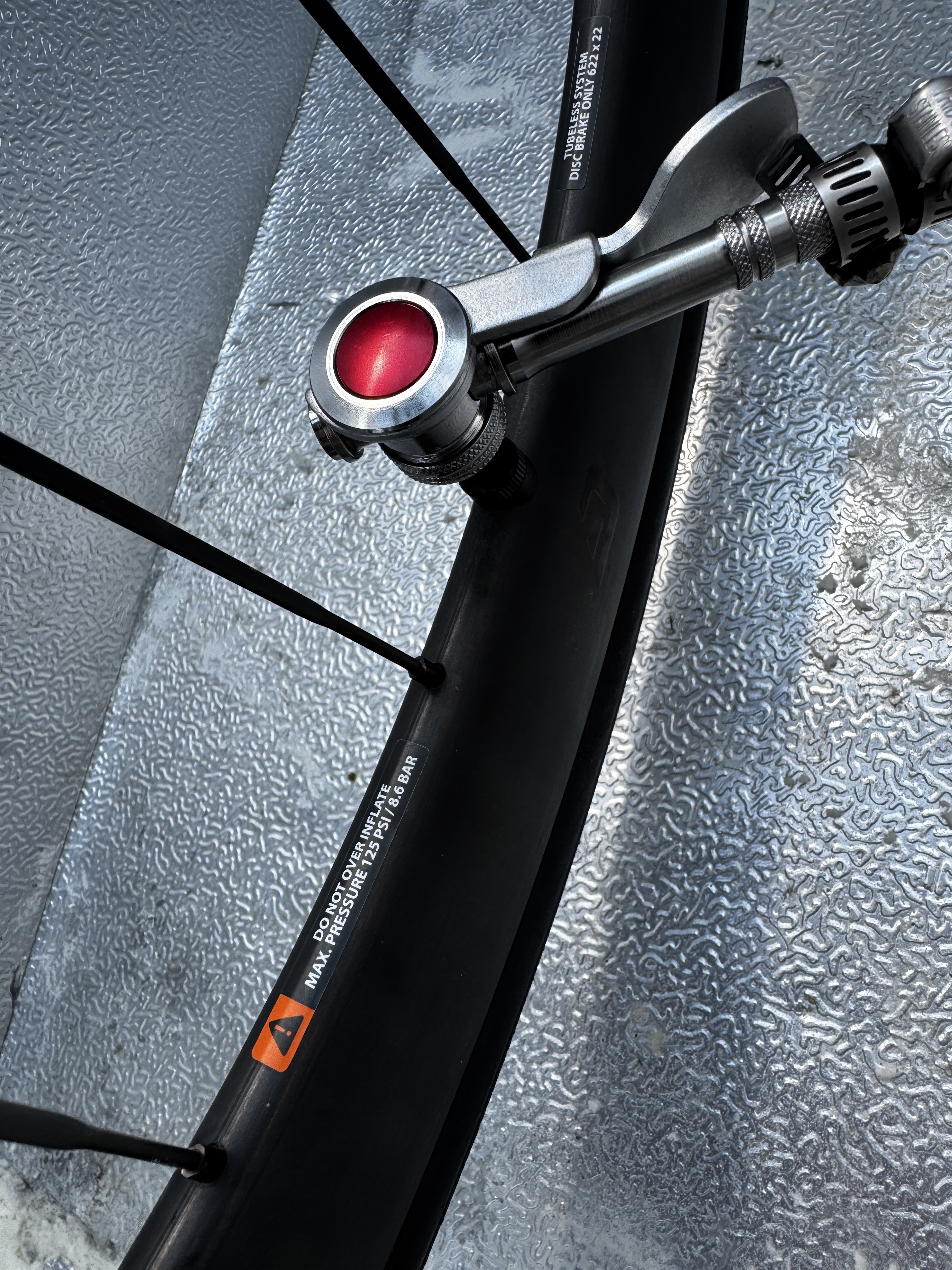

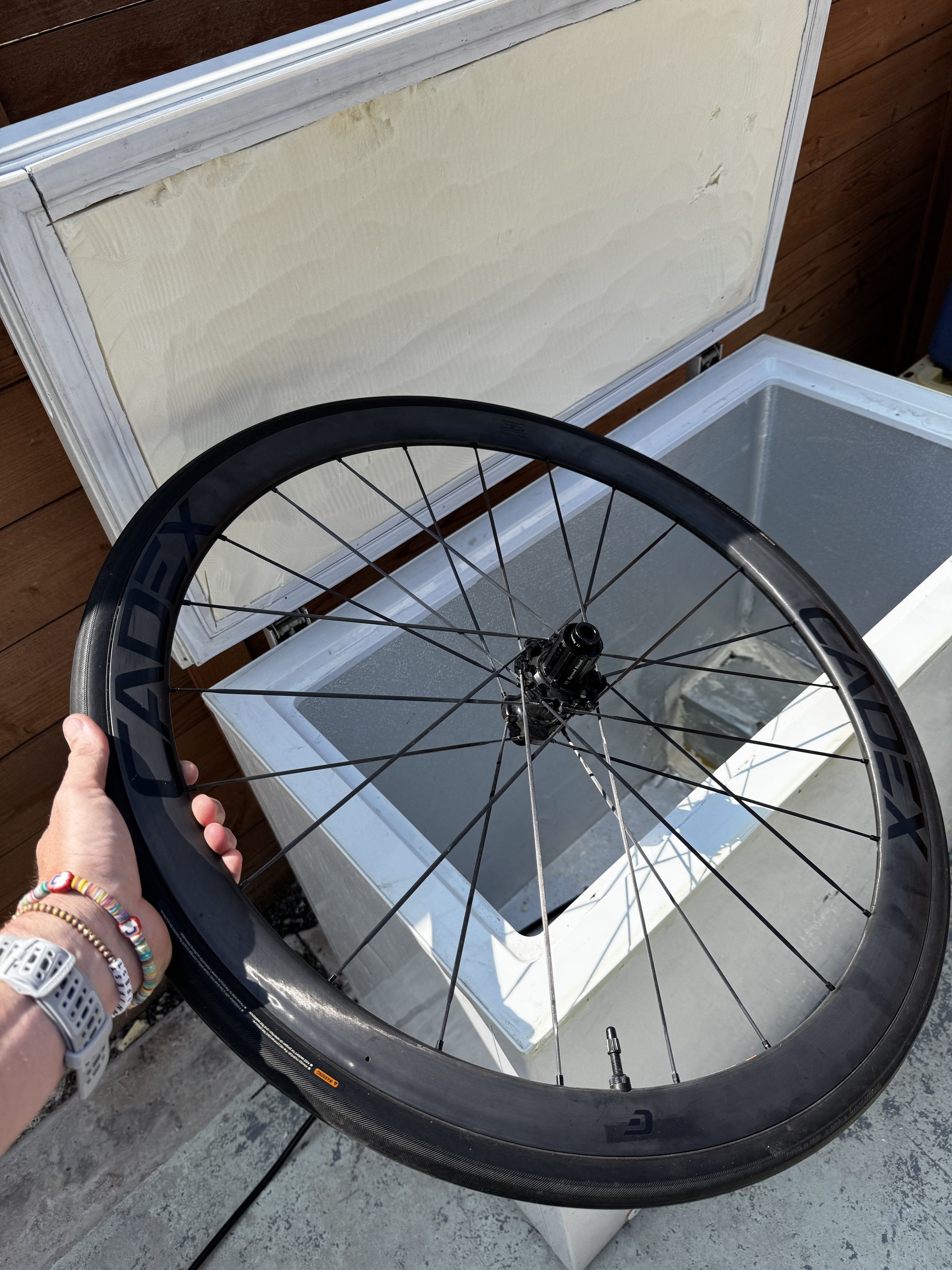

What are you testing? blowoff pressures?

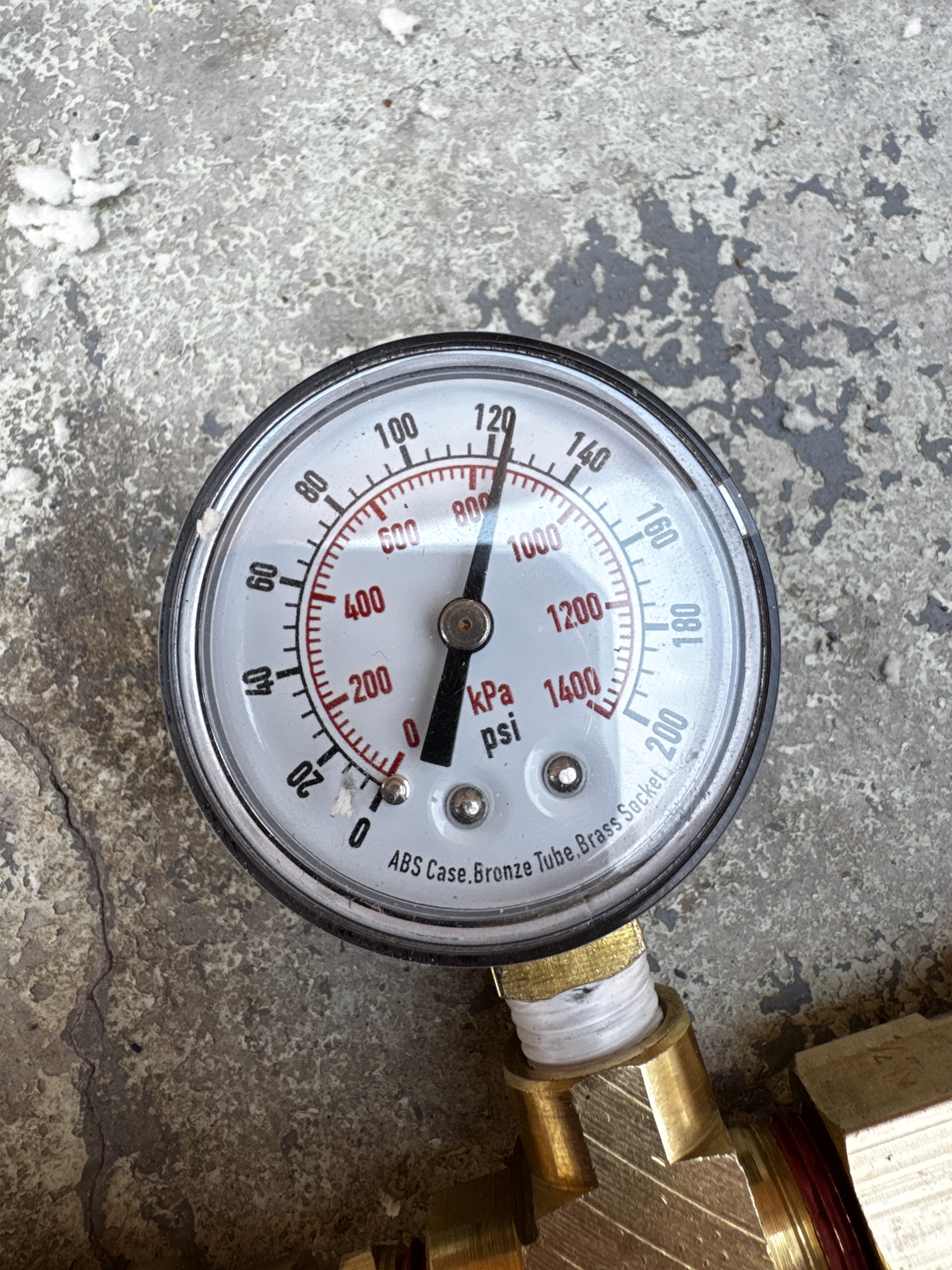

Is that a $6.00 Zoro pressure gauge?
You denied any help in the process remember …. So you can stay in the corner on this one ![]()
18 thousand views in one day - you have to love it!!
Sounds like a “yes”.

I wish it was only $6 bucks
Hey, that’s not six bucks !!
It’s 6.49 !!
Hey, we’re cool with 7.6% error, right?
