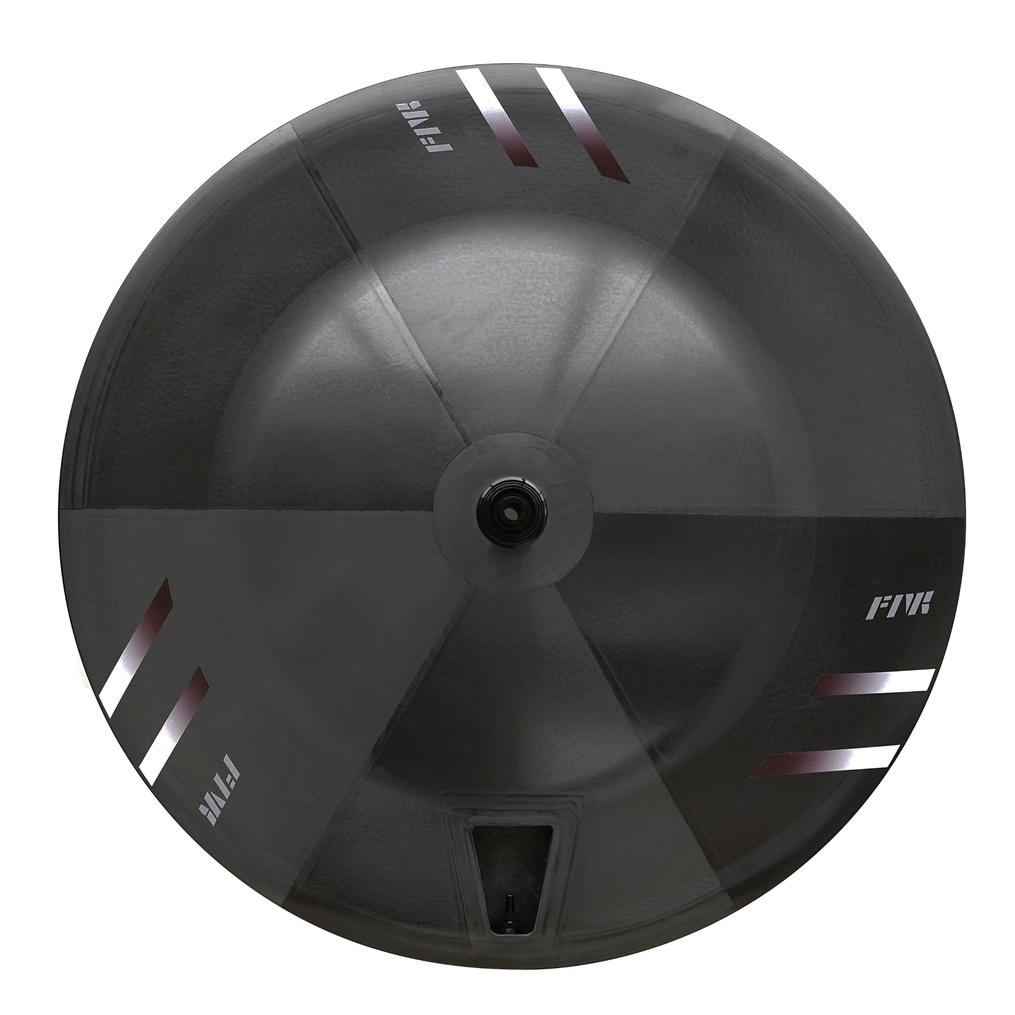

Anyone know any about the sl version of this disc ?

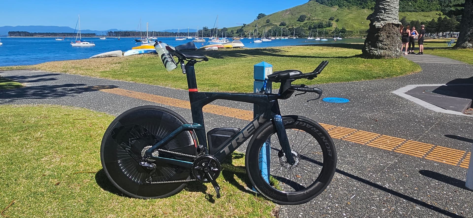

Finally got the Caden out today ahead of first race next weekend. Probably not too much to say in terms of review other than I’m very happy with my choice. Very very light, confusingly so compared to the Bonty 75mm and a roval clx2.
Even with my porky 83kg (refer to another thread for context​:roll_eyes::grin:) then I didn’t notice any flex. And running with a latex tube today at 80psi on 28mm tyre on rough chopseal felt fine.
And the big thing. It makes the right whompy-whomp noise. When riding along it’s pretty quiet but if there’s a solid barrier beside then you can hear it.
So ticks all the boxes for me. Wide. Hooked. Can be tubeless. Rated to 110psi (tubed). Light.
If I had to complain about something, the graphics aren’t exactly what is choose. They are single in some light angles which is good, but the stars are erring on the blingy. But that is really splitting hairs.

is it a spoked wheel with a cover ?
a hollow wheel inside with a solid cabon outer?
or is it a solid inside (honeycomb) with a cabon outer like a zipp ?
also did u have tio adjust the brake rotor on fitmint ? so it doesnt rub
It’s hollow with solid carbon outer. Flat on the NDS, and with shaping on the drive side to retain strength and give clearance for the mech.
I got one of their ultralight brake rotors. When the box arrived I almost didn’t accept delivery as it had a puncture through the cardboard, and whilst the wheel was fine, I suspect the disc brake rotor that was taped to the outside of the box took a bit of a bash. When I first installed on the wheel and the wheel in my frame there was a slight rub at one point. But 20seconds with the rotor tool and it was sorted and now spins freely. So now I can just swap wheels and all the shifting and brakes are perfectly aligned/consistent. And just thinking about it, and highlighted I didn’t even think about it, then braking was just as good as shimano Ultegra rotors.
Looks dope! Which tire? Could you take a profile shot? How was the ride feel in general? How’s the free hub sound?

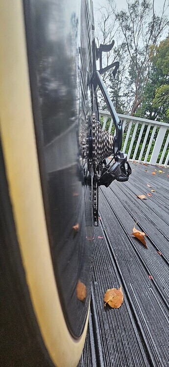

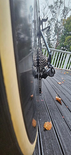

This picture was up above posted on 24/9 with some others from when I first got it with a Corsa Pro Speed (28mm)
I’ll be putting a GP5000S TR on later this week I think for the race as it’s going to be raining and the Corsa may be too fragile. The photo from the weekend was a specialized turbo which I doubt you’d be wanting to use/see.
