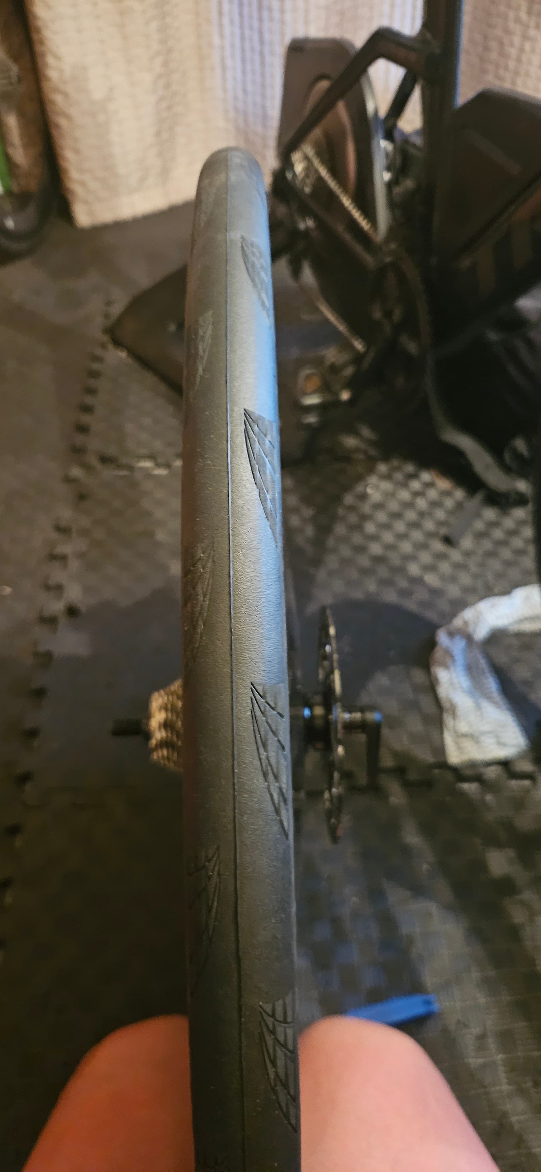

28mm gp5000s tr on cadex @80psi with latex tube.
Tyre went on and came off with no particular pain.

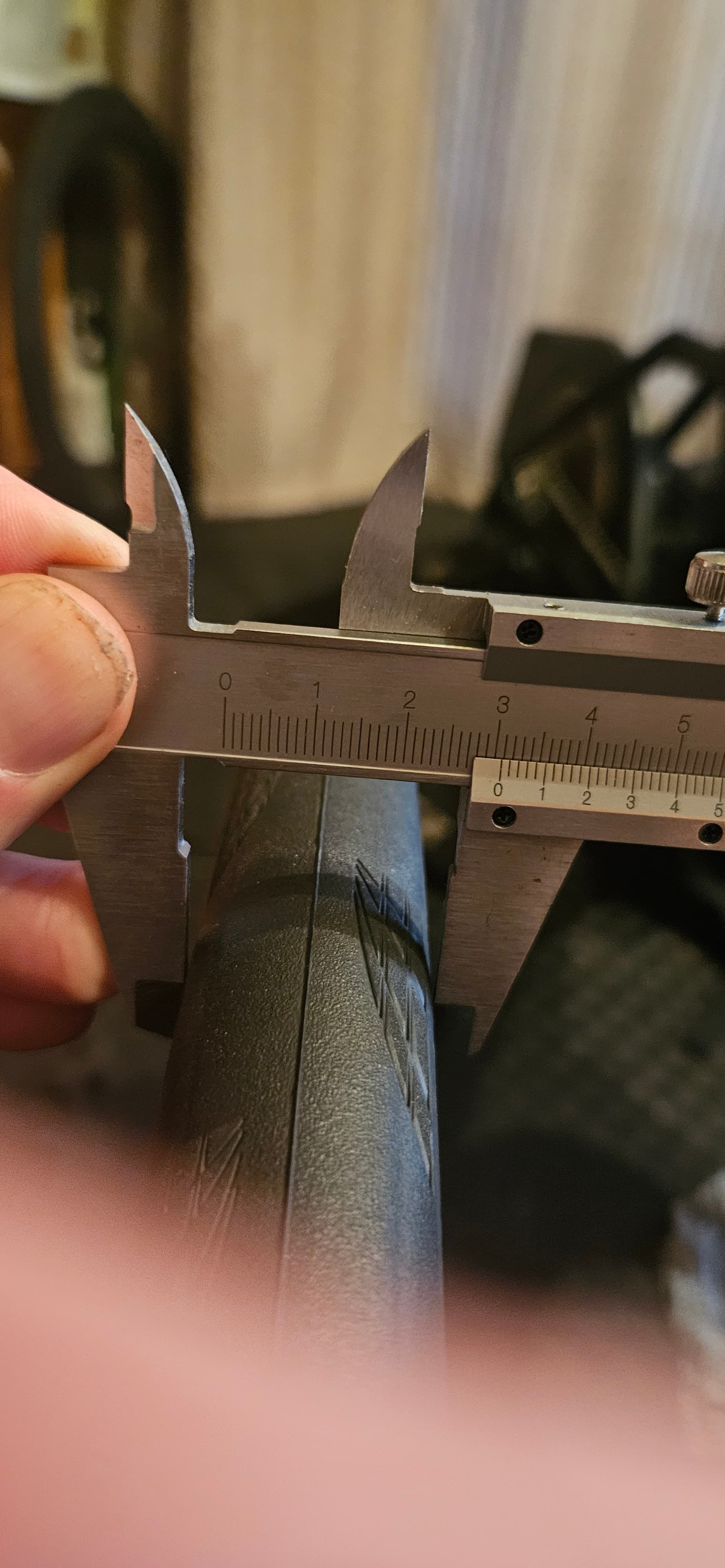

Next time you have the tyre off, can you measure the internal width between the bead hooks? 30.8mm seems wide for a 5000STR 28mm on 23mm internal width (or maybe the caliper was angled slightly when you measured?).
Yeah, was done quickly for indication more than precision. Forgot I was on Slowtwitch :wink:
I also didn’t repeat at 3 altitudes, normalise for temperature, etc :wink: FWIW 22.5mm is the listed internal width. The tyre is narrower than the rim that is 32.8 (listed).

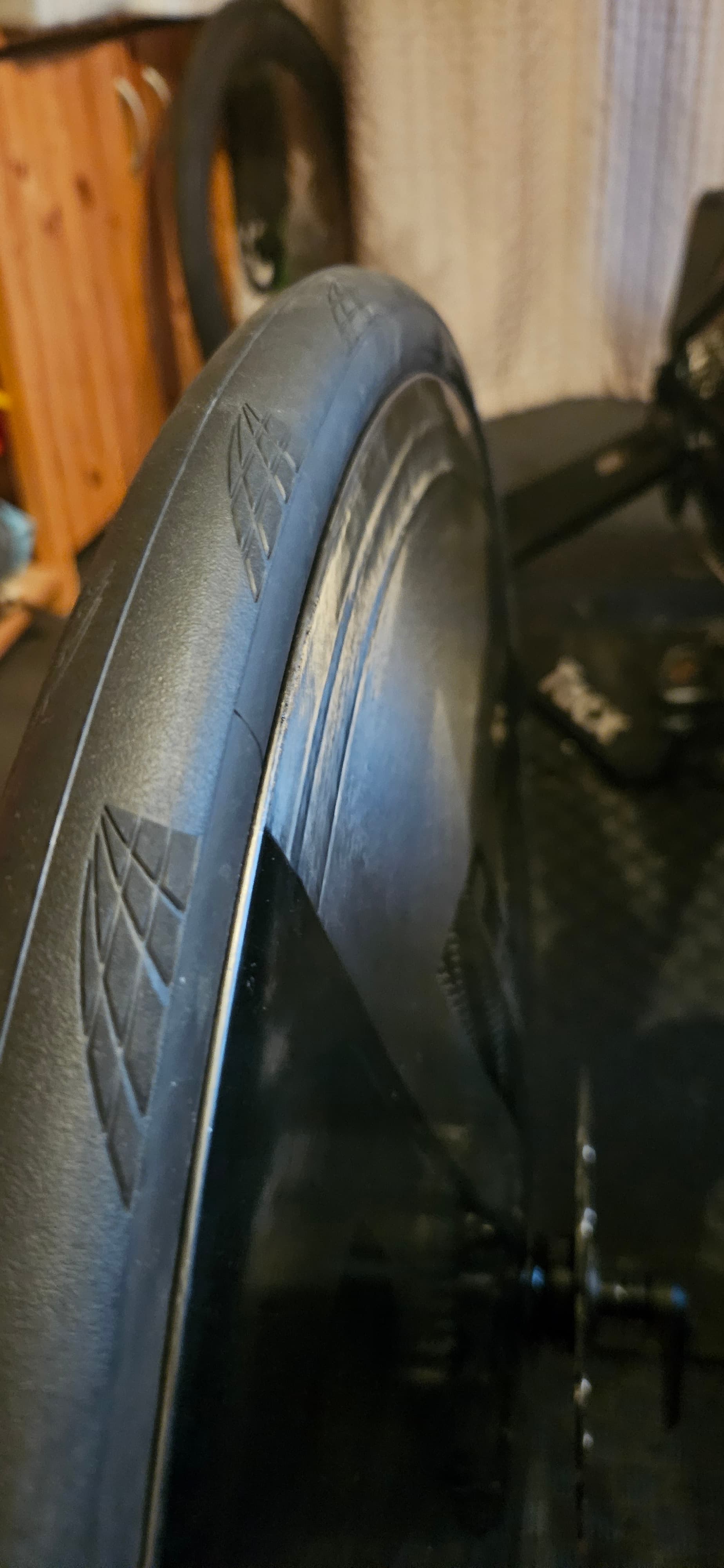

Why not go with a 700x30 tire then?
I appreciate differing views. Really, see a lot of my posts. For me, then 28 tyres (labelled) are as wide as I want, and as wide as I can comfortably fit on my bike with enough clearance for the large chips that get stuck to the tyre on occasion.
Going wider tyre is more weight, risks frame/tyre damage when a chip gets stuck, and would bulge out.
Was just an idea, since your disc is extremely wide on the outside, but has a significantly smaller inner width. A 30mm tire should end up being flush with the rim. (More comfort, better aerodynamics I’d assume.) And the SC frame can handle that easily.
I never had any chips stick to my tires, must be a New Zealand thing.
May be the photo didn’t show it too well. But the tyre is almost perfectly flush. Fractionally narrower but of course better that way.

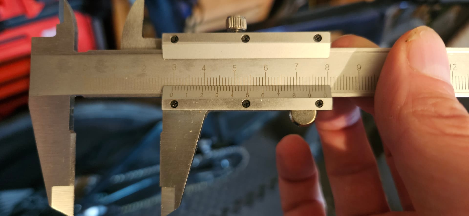

Ok. Did better job this afternoon. So I reckon that shows the 28mm labelled gp5000 s tr at 75 psi is 29.84mm.
