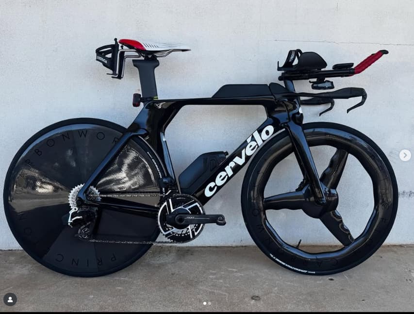

Not the cheapest choice, but I went with Princeton CarbonWorks and have not been disappointed. They are beautifully made and work great with the Conti 5000 TT. I can’t wait to ride full blast with them this weekend.
PS - I will take the lights off to race :-)!
No6works pulsar disc
Screaming 45 tooth ratchet
Ceramic speed bearings standard
916 grams
Looks and sounds amazing!
Great looking bike David! I’m in the process of having one built for me right now. Your photos make me all the more eager for it to arrive! Have a great race!
Thank you so much. I love it. Can’t wait to Rasey :slight_smile: keep me updated on your bike.
Have you ridden one?
