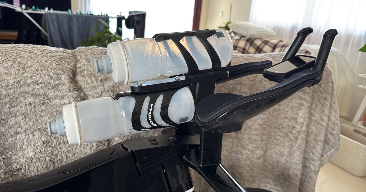

For the guys who have the frame - I’ve put up the 3d files for the twin bottle BTA system here, if you wanted to print and add to your bike:

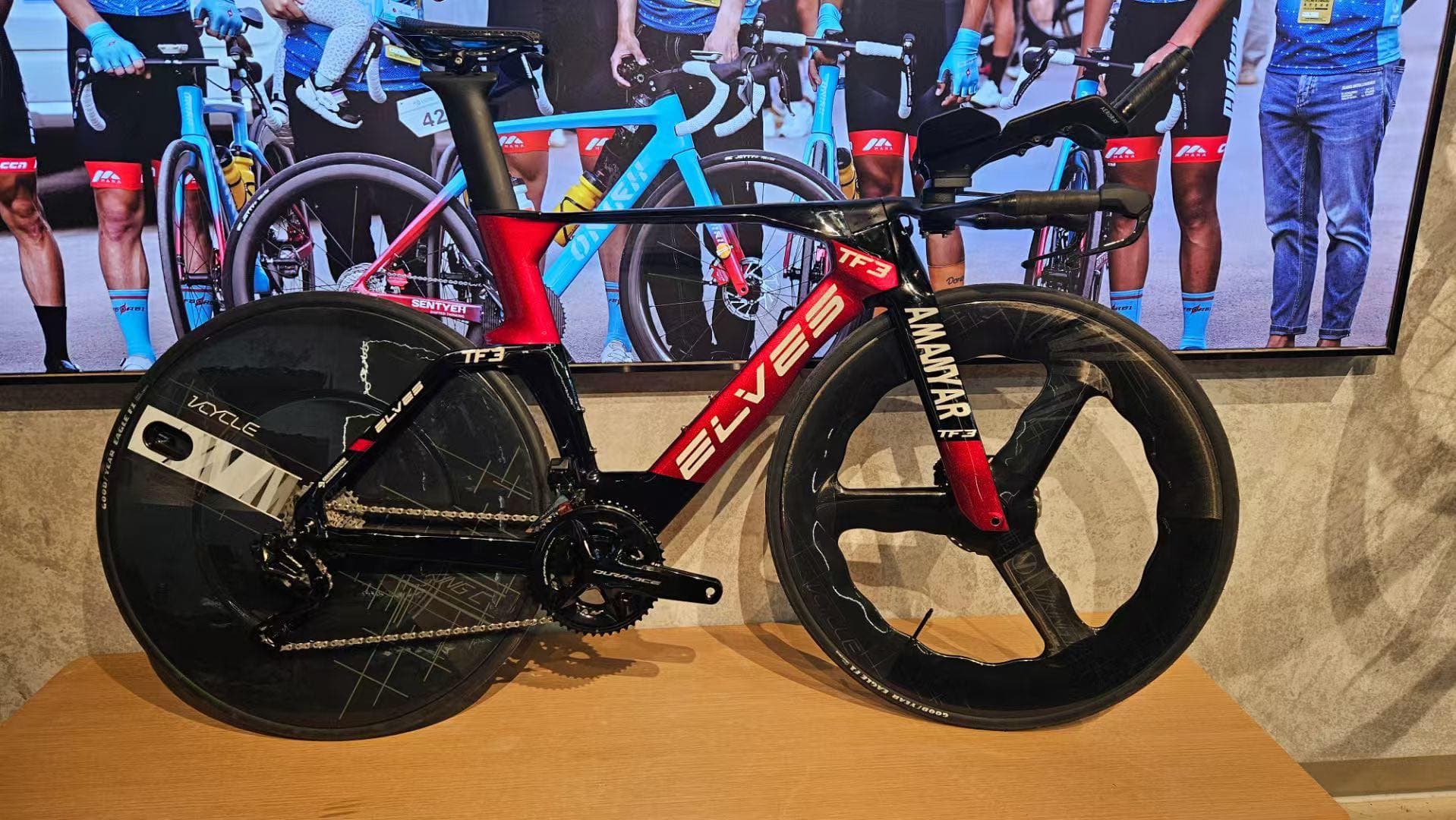

For those who said I wish it was a more traditional frame, this is what Elves showed at the Shanghai bike show recently, I think it looks pretty f**king epic
The cockpit is similar to the one you guys already have, the wheels are quite cool, the rear has a pop out section so you can ride it as a tri spoke extremely deep wheel (Kona ok) or use the wheel cover to make into a full disk.
The groupset from what I understand is wheeltop and is in development for a full wireless 11/12/13 speed set up with wireless buttons on the aero bars and the brake levers (which afaik are TRP) and generally a slick bike well made, light weight and cheaper than the Euro and uSA brands.
