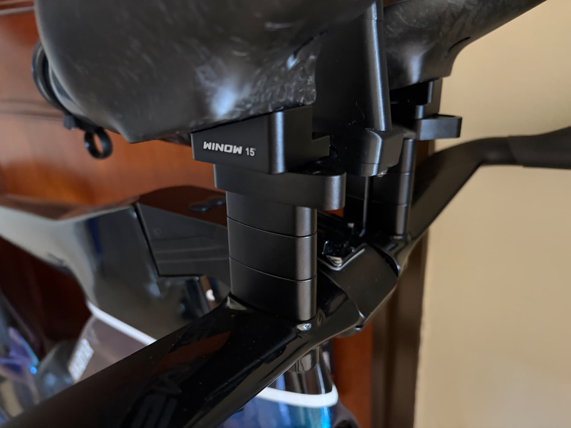

Was it easy to fit the vision base bar to the frame as I haven’t seen many that don’t use the aeroray base bars?
Thanks!

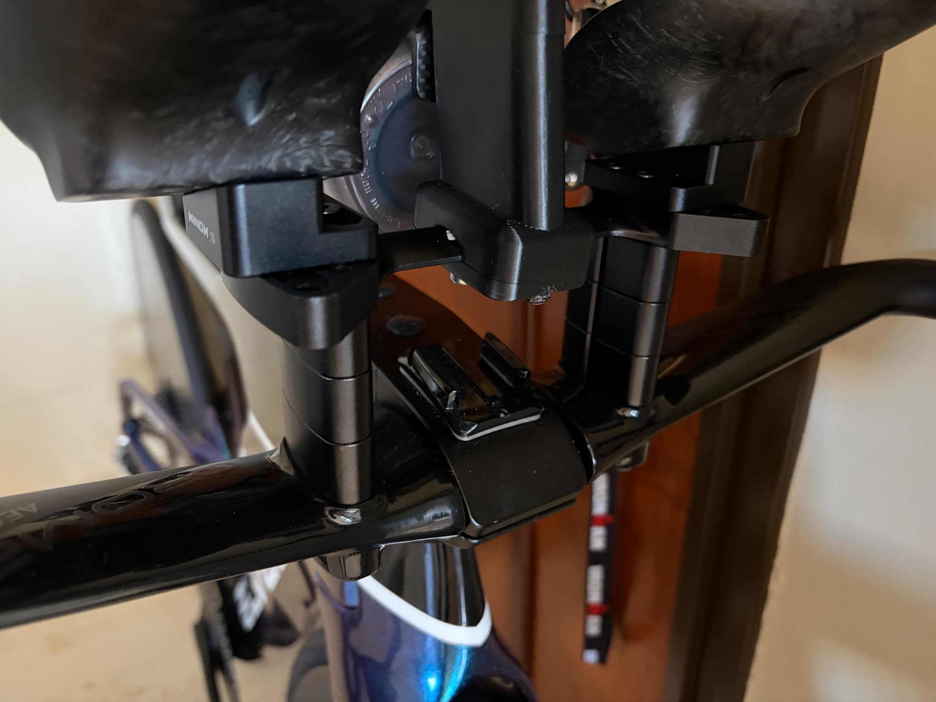

As there a lack of any adjustability on the tilt/angle on the bars (annoying!) I found 15’ degree adaptors from Winow (WINOWCYCLE Fabrik HB052 Lenker Ersatzteile 20 mm Abstandshalter Computerhalterung Adapter Basisstange Armpolster Verbindungsbrücke für ARB02 - AliExpress 18)
They bolt straight on to the Elves raisers and cross bar and then the default M5 bolts from the Vision pads when straight in. They do 10/15/20 and 25 degree adaptors. Will upload a photo later

Which Vision aerobars are you using?
I’m very close to getting this set up myself so would love any insight into your experience?
Bars are the Vision TFE Pro bars (Large). Didn’t like the included ones.

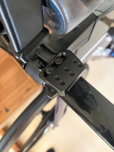

Integrated hydration isn’t good as the brake hoses internally get in the way so I’ve ditched that. Design and printed my own BTA bottle holder
