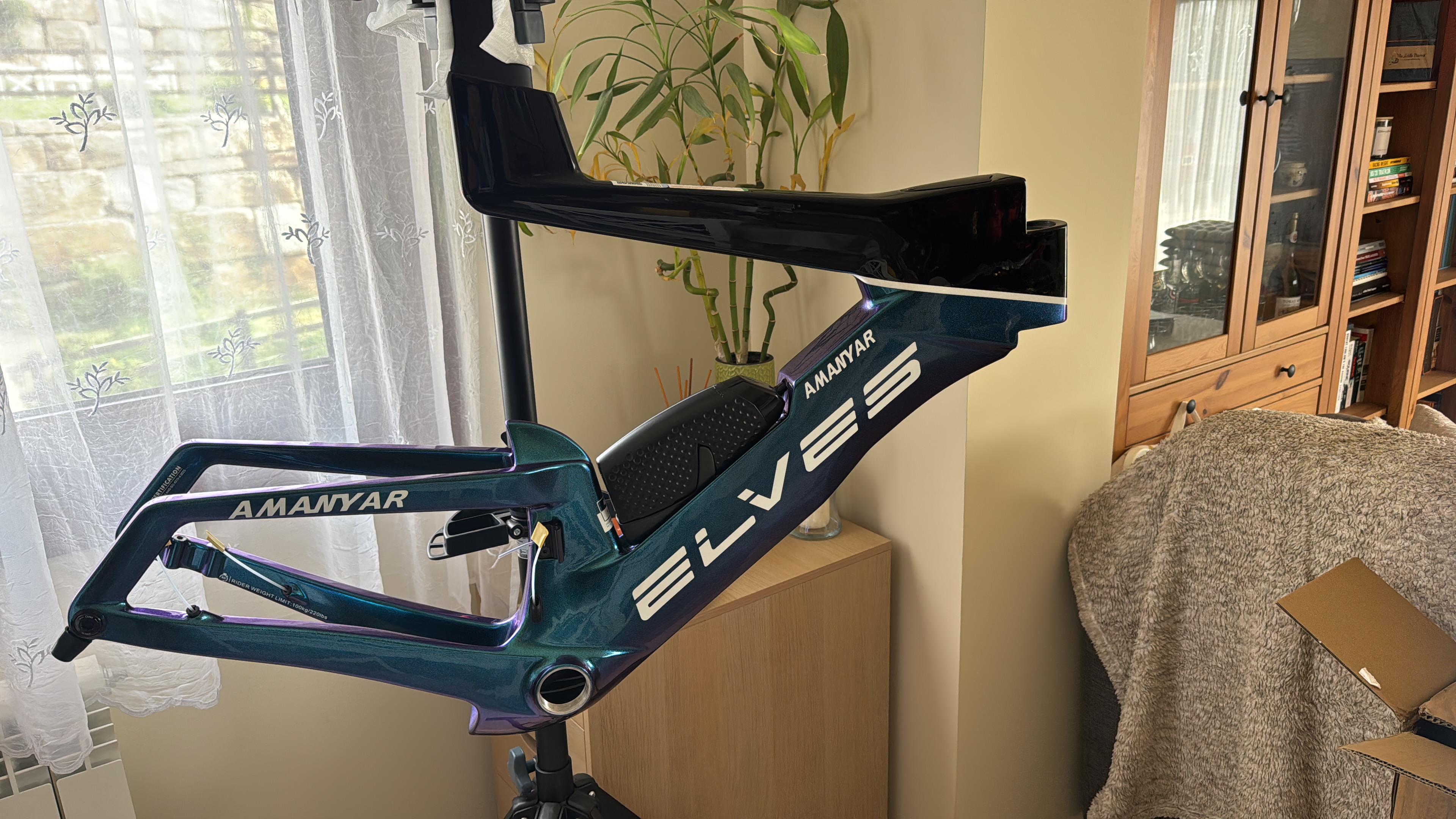

My Elves Amanyar frame has arrived.
AMA :slight_smile:
Will be a slow winter project for me to build it up.

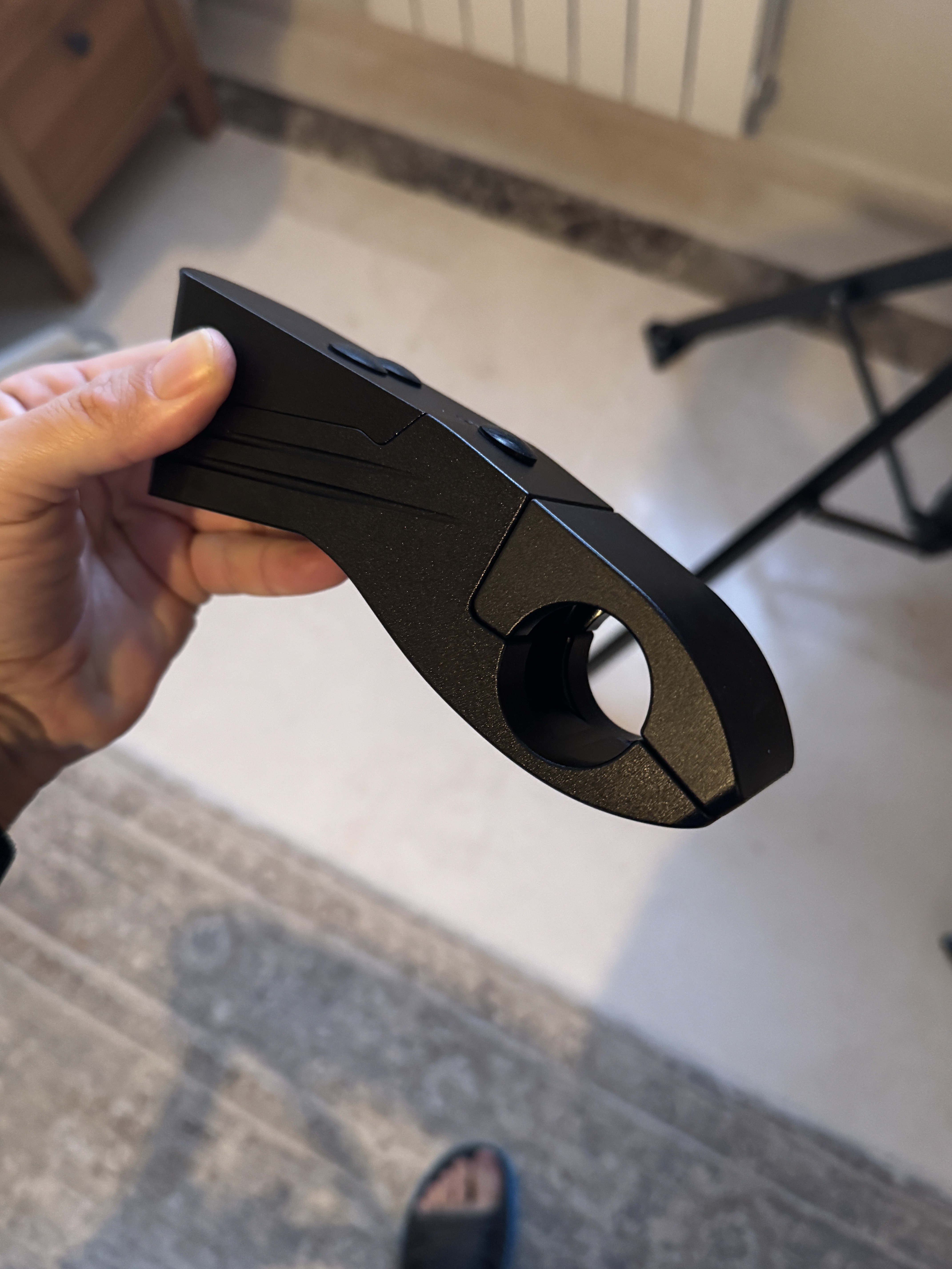

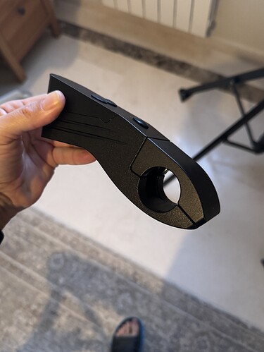

Tried to reach out to them on Instagram but no response. Do you see any reason why you couldn’t run a different stem/bar combo? Standard 1 1/8" steerer tube, correct? Only concern would be how little space there is behind the steerer tube with that top tube.
If I had to buy a bike today without breaking the bank I’d 100% go with the Van Rysel tri bike. Not as dirt cheap as the Elves but actually tested and GREAT bike for the price.

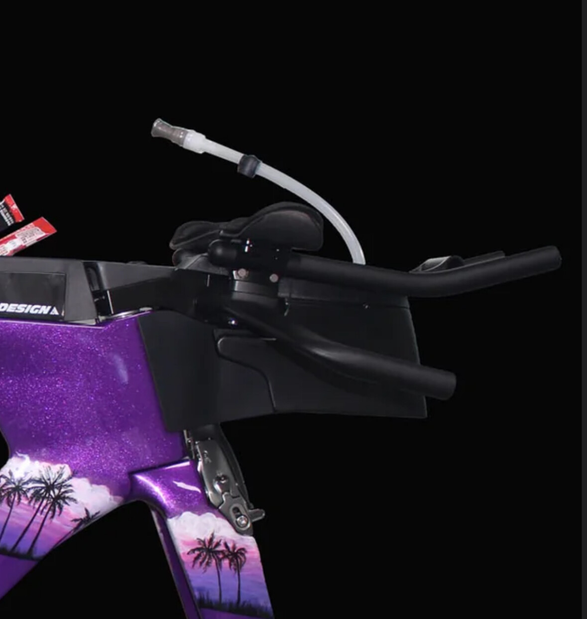

The stem looks like a knock off the Profile Designs Aeria Ultimate
so much so that I’ve seen the Aeria front hydration on the similar designs of the bike from Falco.
It’s a standard steerer tube, just has some fairing in front.

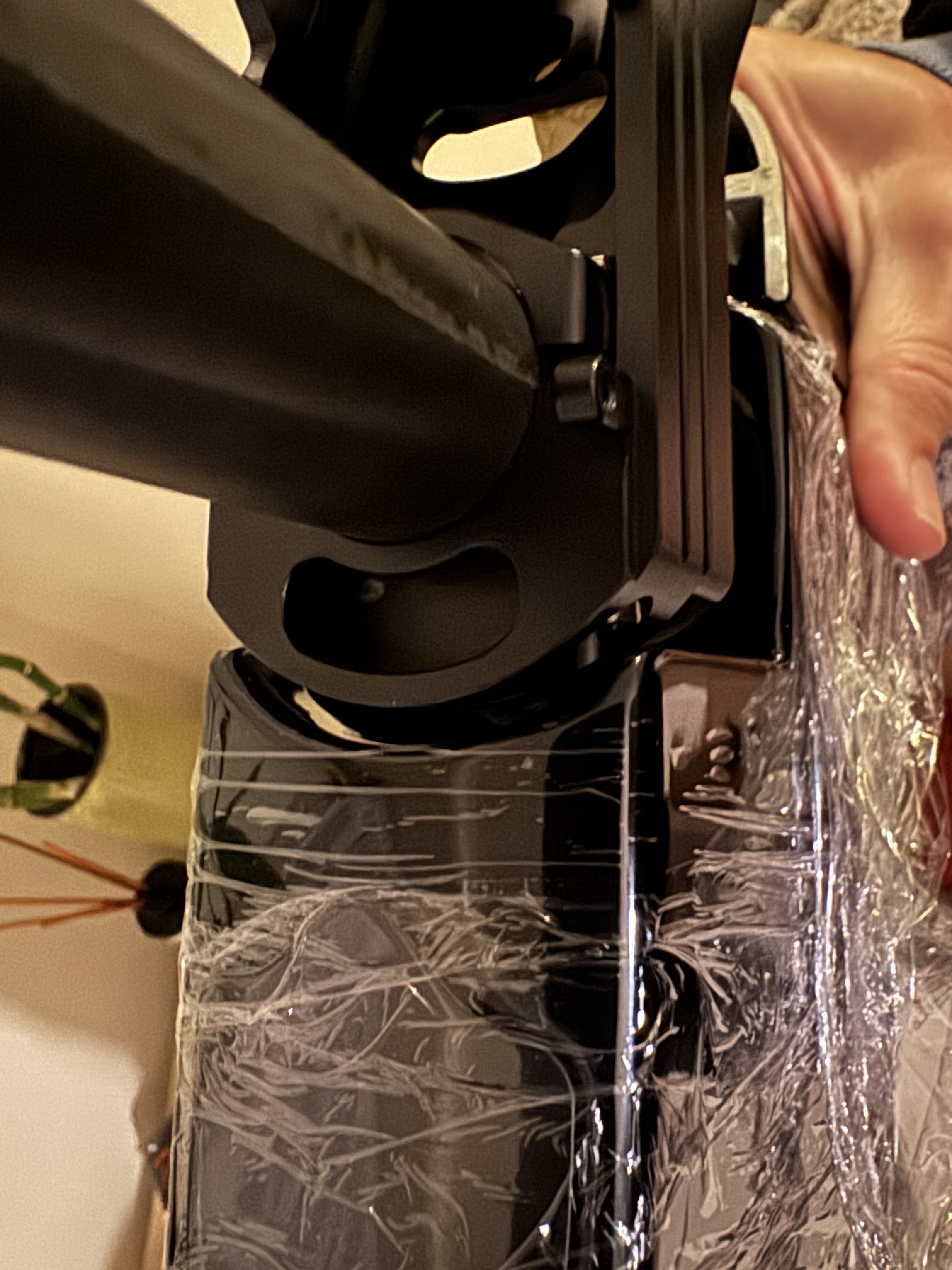

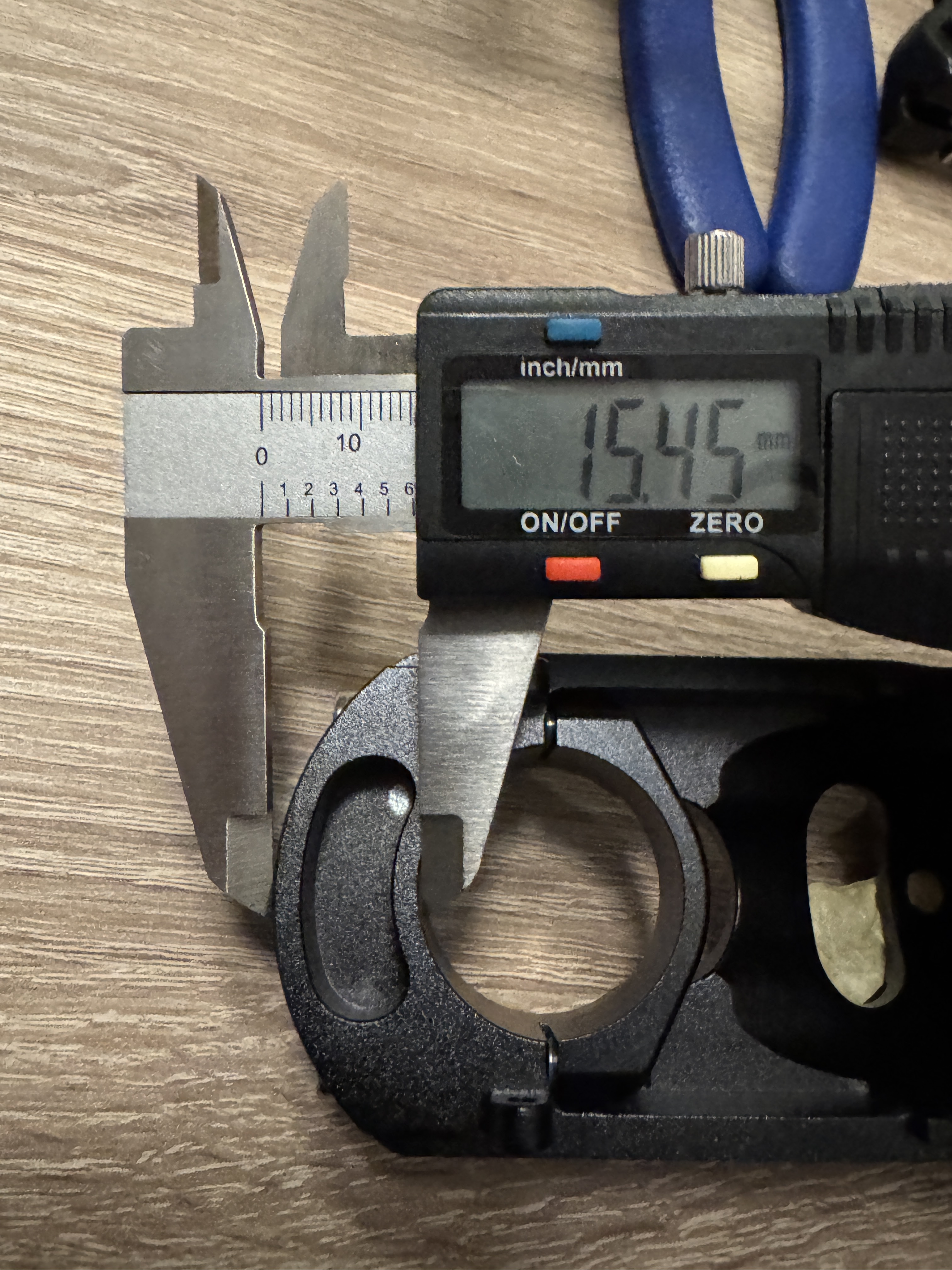

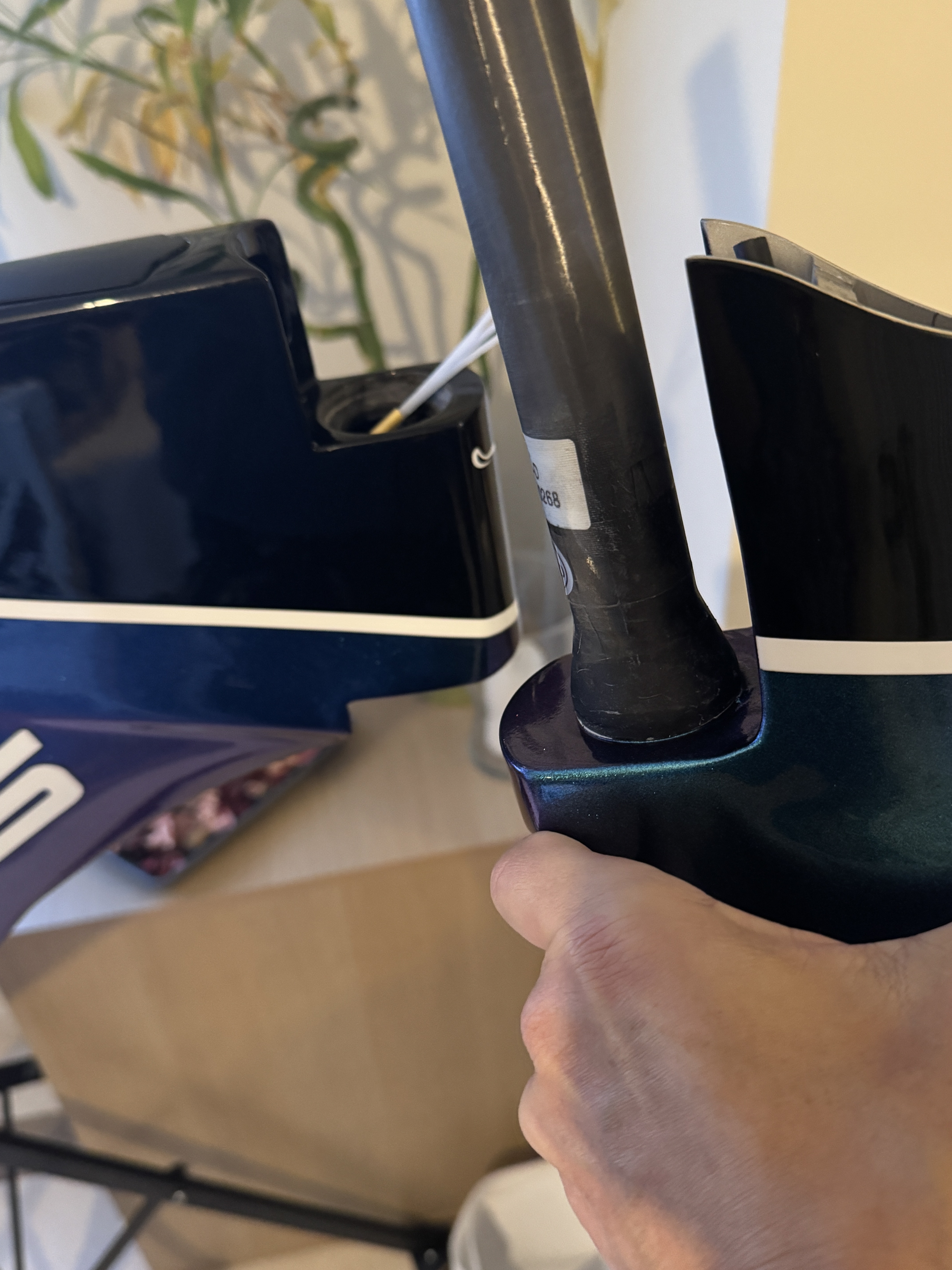

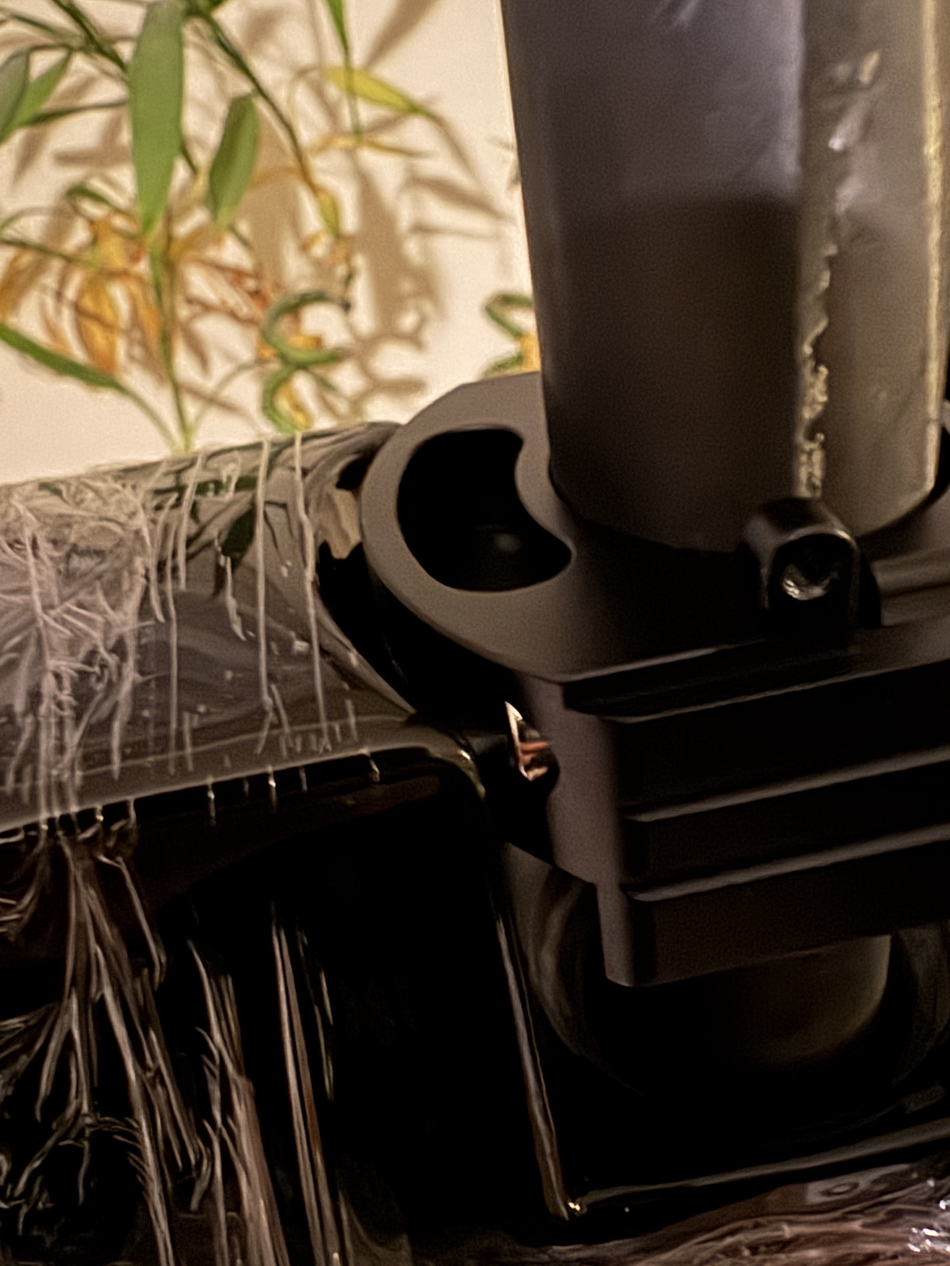

Any chance you could measure the gap between the top tube and the back edge of the steerer tube? Looks pretty slim there. For reference the Alpha One needs 14mm of space to fit.
Here you go
Sorry about the cling film - but I’m sure to scratch the paint before too long while putting it together so trying to give myself some chance not too LOL
Perfect! Thanks for the pictures. So looks like something like the Alpha One would definitely work. I’m intrigued by the reach and I’ve always loved off the wall designs.
Keep us posted on the thread with any thoughts you have as you go through the build please!

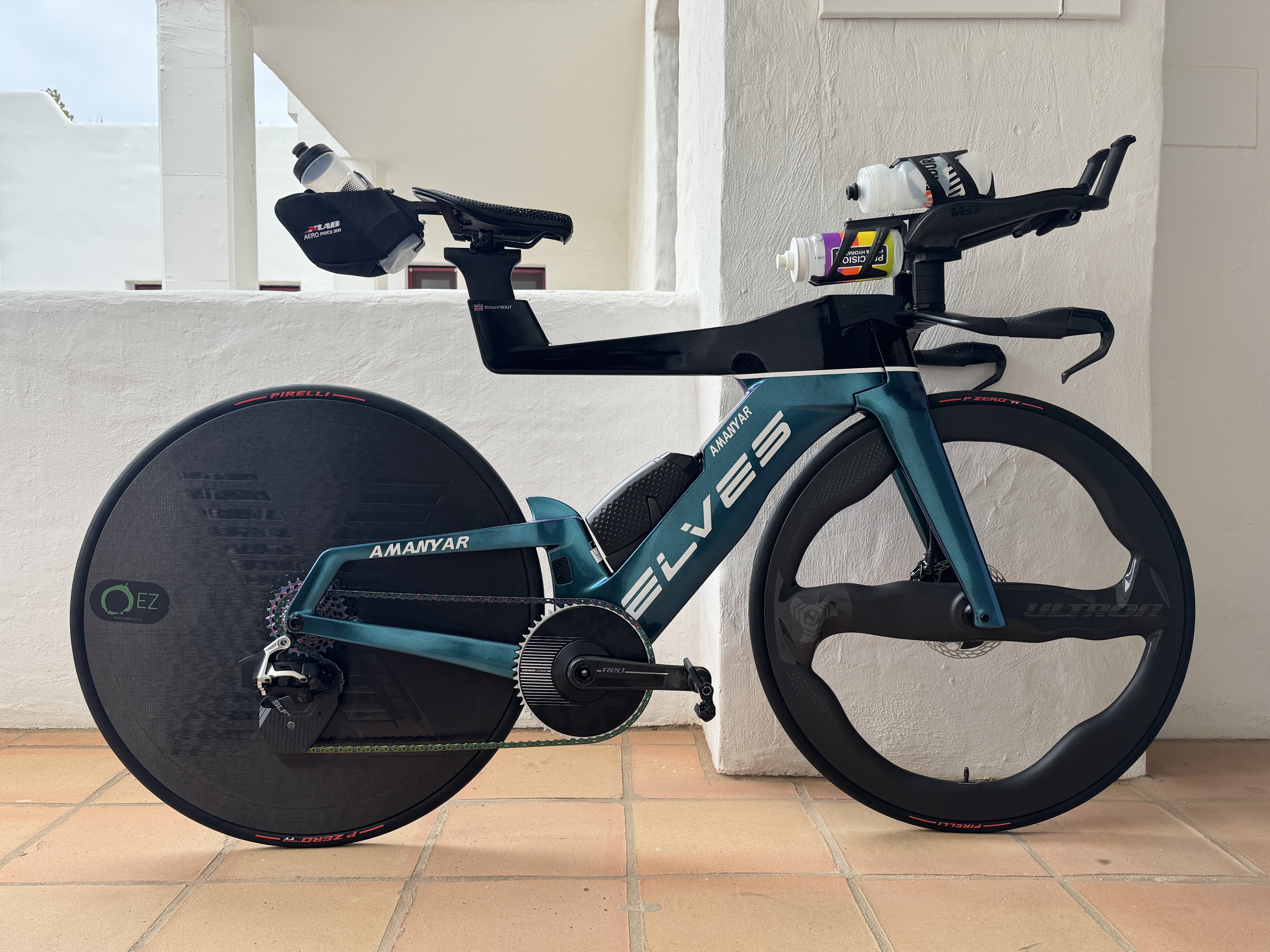

Build complete. :sunglasses:
That looks great. Very cool build.
Weight? And have you ridden it yet, how does it ride?
Not ridden it yet. Wet here. Will weight it tonight and post up
8.8kg with wheels, tyres, rotors, saddle, cages, Xlab aero pouch, garmin 1050, and dual sided Assioma’s
Your build is a looker. Very nice color and cockpit. That front wheel needs a review all by itself. Intrigued.

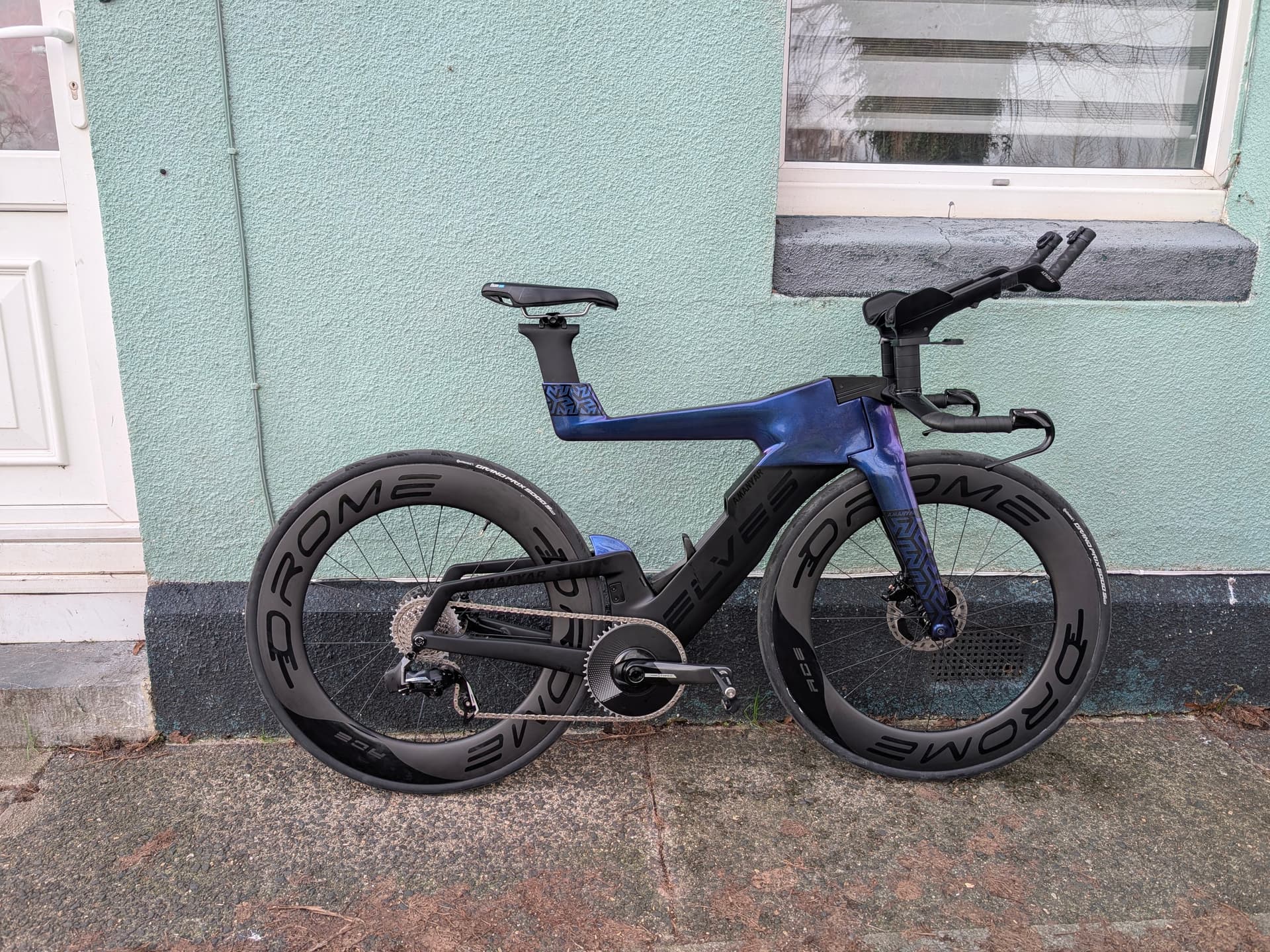

Just wanted to share my recently built Elves Amanyar. The build is almost complete, just waiting on some bar-end adaptors to fit the blips.
I’ve been really impressed with the value of this frame, especially considering the price and the 5-year warranty. I did consider going for a P-Series, but with new frames currently at £3K, I was a tad hesitant.
Looking forward to taking it out for a proper ride, just waiting for the UK weather to warm up a bit! Happy to share my thoughts once I do. Or photos for that matter.
For reference I am 177cm and went for a 48cm frame… Coming from a Planet-x exo 3 Medium frame, the 48cm comes out slightly larger.
