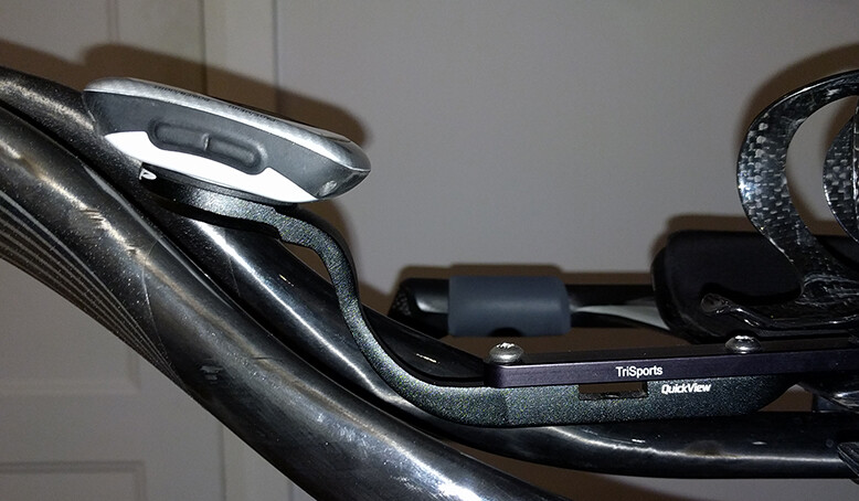

Another thing to keep in mind, you can bend the Zipp Vuka mount to change the angle - see below, using the Trisports mount attached directly to a Sigma stem.
This setup gives me plenty of room for a Torpedo bottle.

Looks nice, aren’t you afraid of the alloy being stressed and possibly breaking at the least opportune time?
Not really - it is pretty thick at that point, and given the minimal bend and the light weight of the Garmin unit I don’t see it as high-risk.
