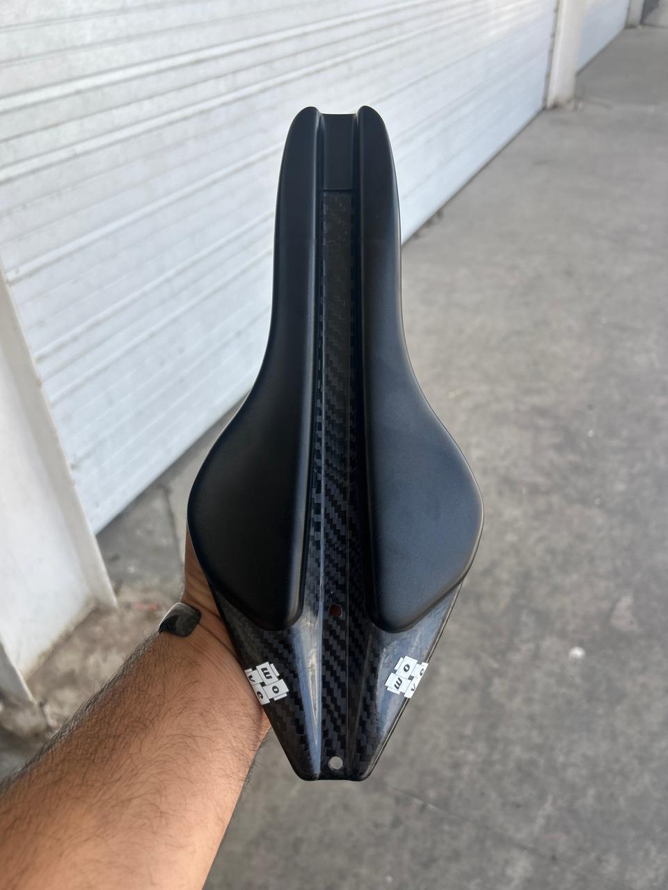

Wove saddles
Ordered :+1:
looking forward to trying it out
Very nice Nick! I can see where that would be great for an aggressive road bike position or potentially a more upright or higher power/shorter TT (where you’re riding more on the nose). Always good to have options.
Thanks for the heads up about the BTS double bottle bracket, I’ve been loving mine but will definitely reach out to get one of the new ones. Especially with 2 1L bottles mounted (and filled with 200g carbs each for long training or full IM racing), it definitely gets heavy back there and I have felt a little bouncing.

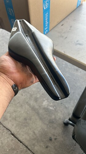

First M8 has shipped to Wurf💪🏼
This looks excellent, I think I want to sit on one when they become available.
This could be my new saddle:-).

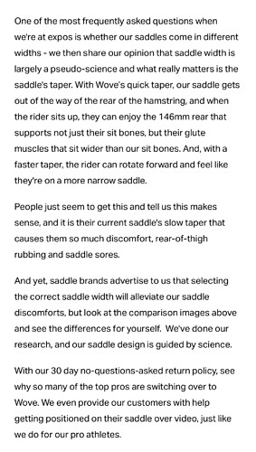

Blog: So You Think There’s a “Best” Saddle Width For You? — Wove

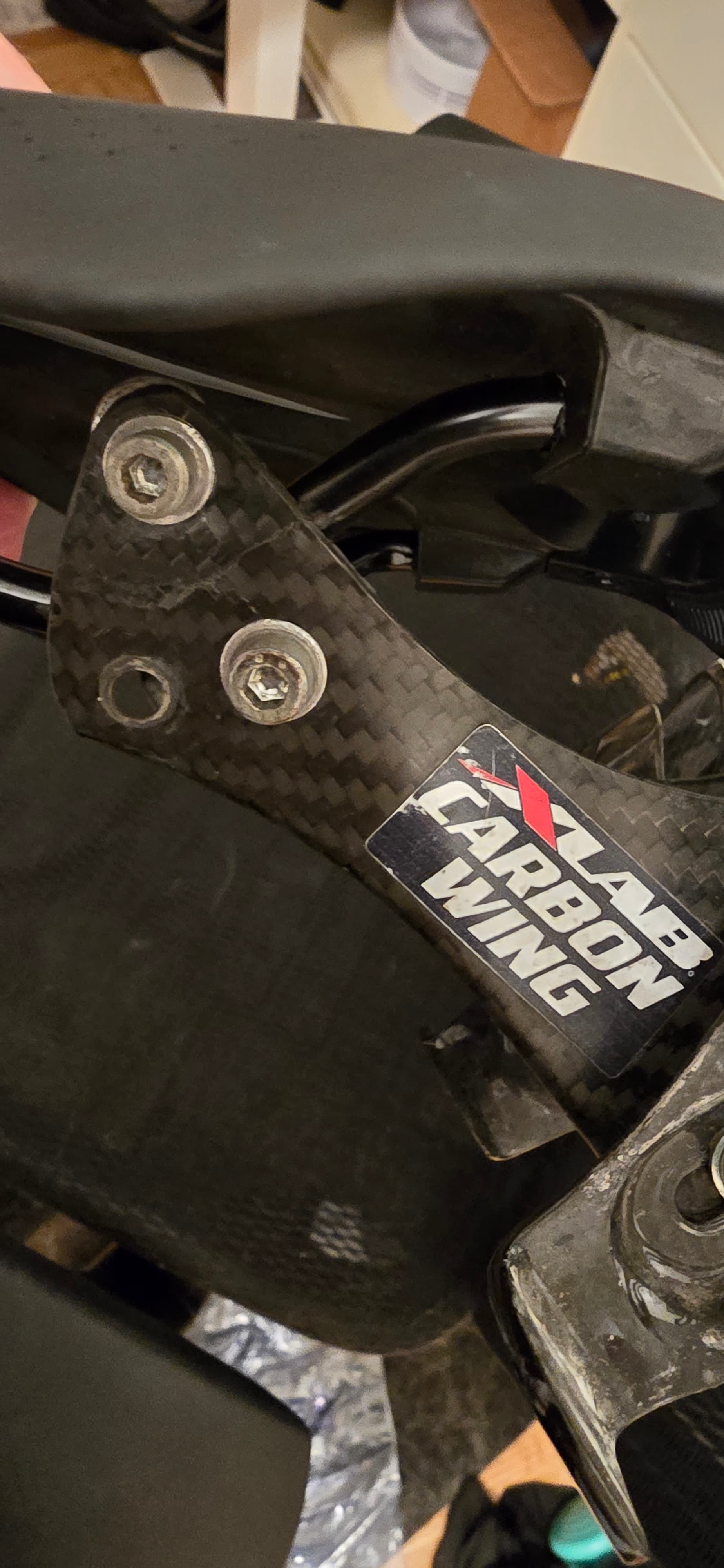

I have my older XLabs Carbon Wing BTS mount, but wanted to see if there is any issue mounting it (if it clears the rear of the saddle) to the carbon rails?
Mine goes on the angle up to the saddle itself, where the rails appear round and thinner - any concerns or issues with this? This is it on my Sitero:
Have you seen this on our Instructions Page? (We put on our box and in our follow up emails, but I too am one to skip instructions :joy:)
https://www.utahtrikes.com/PROD-11618337.html
Email us for any help setting it up. Or with setting up your position on the saddle/bike.
Alternatively, you can use a single cage on our double bottle bts bracket on top of the saddle
And the new Tririg system works on our saddle: Elliot Bach on Instagram: "Tririg just launched the new Beta One Bottle Carrier. Take your rear hydration to the next level with the capability of mounting up to 3 bottles. Mounting options available for all saddles and seat posts!"
Thanks Nick for kindly telling me to RTFM :rofl: While I was anxiously waiting for the saddle I’d read it - really!
Also thanks for some of the other options - I do have the double bottle bts bracket on order.
The Tririg one is interesting - will check that out.
Just so I know and don’t possibly do something silly, is there are issue with mounting on the rails like the XLabs wing does?
Thanks again!
No issues with mounting on the rails, but if you do put 2 L of fluid back there, just recognize that that is a lot of force on the entire system
