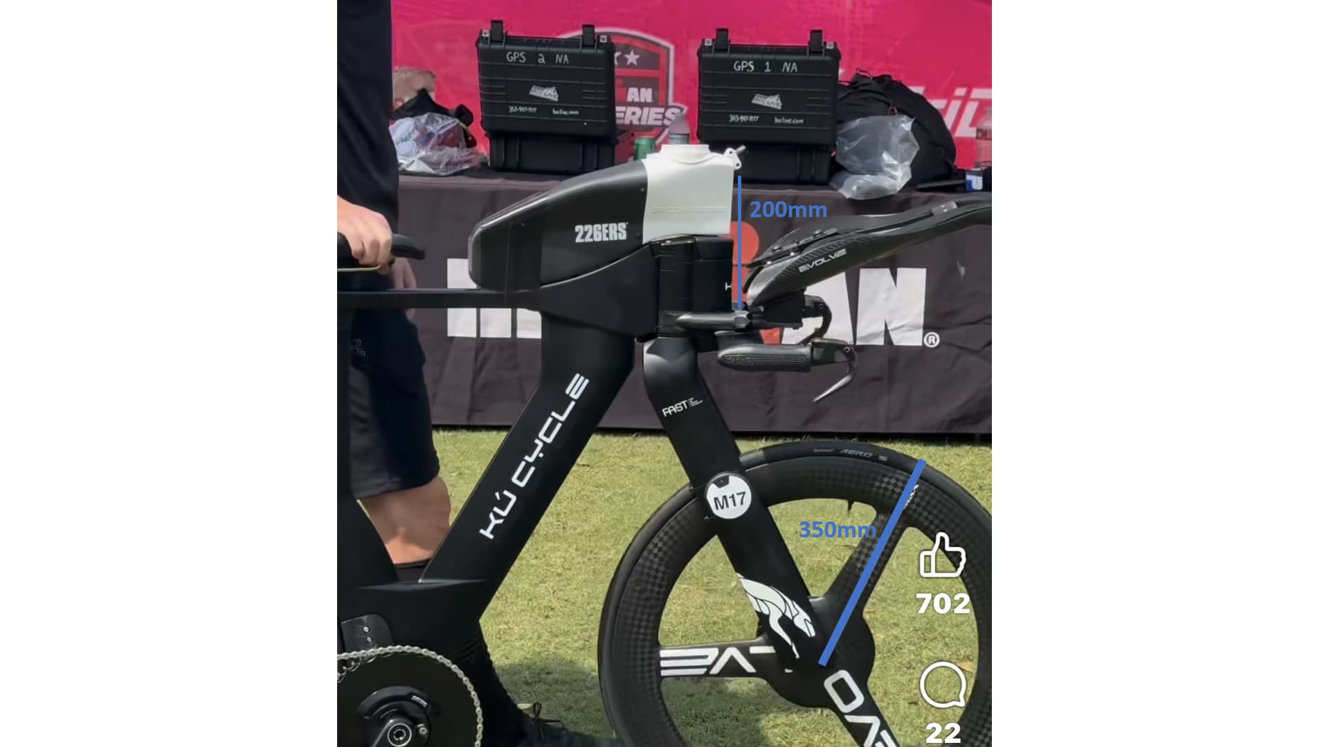

Top tube is the space between steering parts and seattube - that box is well over 100mm above the top tube, so that’s a no (by my understanding)
Not looking great for the 200mm above the back of the armrest either but could be close
It will not be allowed, as it is abouve the 10 cm limit, measurement start at topedge of your toptube, they are allowed over the complete range of the top tube starting after the pivot of the handelbars.
Also, tape is not allowed.
I am not sure how this is mounted, but in some cases a joint has to be installed as this solution reaches over the pivot of the handlebars…also not part of the body is supposed to touch it, also your legs, when turning…

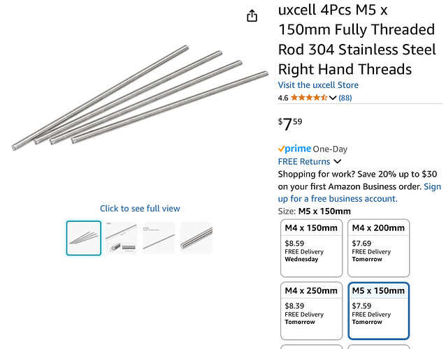

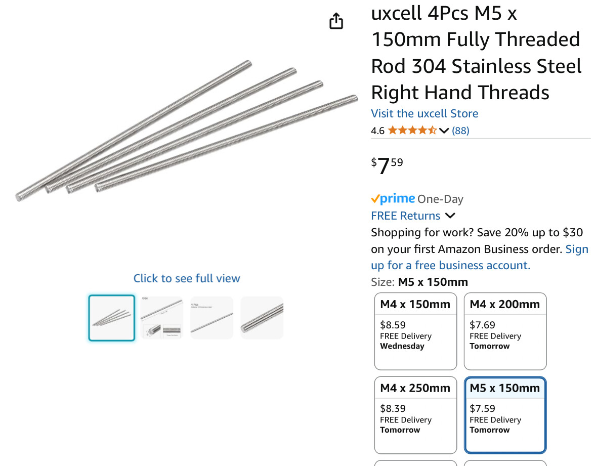

M5 threaded rods and a few nuts and washers
The rule talks about being on the steering axis. This is mounted 100% to the frame. The difference with the Ku is that part is connected with the headset (steering axis).
you can mount it everywhre on the top tube, but this is surely too high, 10 cm limit!
This wont be allowed once the new rules take affect in ironman. That being said you could mount an aero waterbottle like the trek directly to the top tube. It’s less than 10cm high and not wider than the tube.
