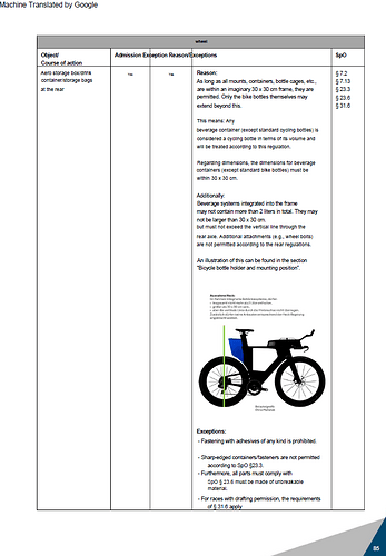

Thinking and stewing on this change, lumping aero toolboxes into the rear hydration allowed dimensions isn’t going to serve the athletes (Ironman customers) well. Looking back through photos of past races, there are a lot of athletes with BTS that are riding a Speed Concept with the add-on toolbox or a Quintana Roo. None of those are going to fit inside a 30 x 30 cm box, except maybe a small bike with the saddle all the way down. Configurations people have been riding for years and years.
Most of those folks don’t follow the forms and won’t be aware of a mid-season rule change. They’ll show up to bike check-in on race day and be told to either lose their toolbox or BTS mount…on a setup they’ve been riding for 10 years. That’s shitty. If you’re going to force a substantial change like that, you’ve got to at least do it in the off season.
What’s worse, is the WT interpretation is very focused on hydration and really doesn’t mention toolboxes, outside of the generic term “containers” which one could easily take to mean a drink container. It was an extremely poor choice by them to release the interpretation before publishing the actual rules in English.

That is not my interpretation, per a machine translated version of the DTU rules,appendix 2, which WT is supposed to be taking on. I would take “aero storage box” to be the same as a toolbox.
This is where not having the English ruleset sucks. WT put the cart in front of the horse with their interpretation ruling.

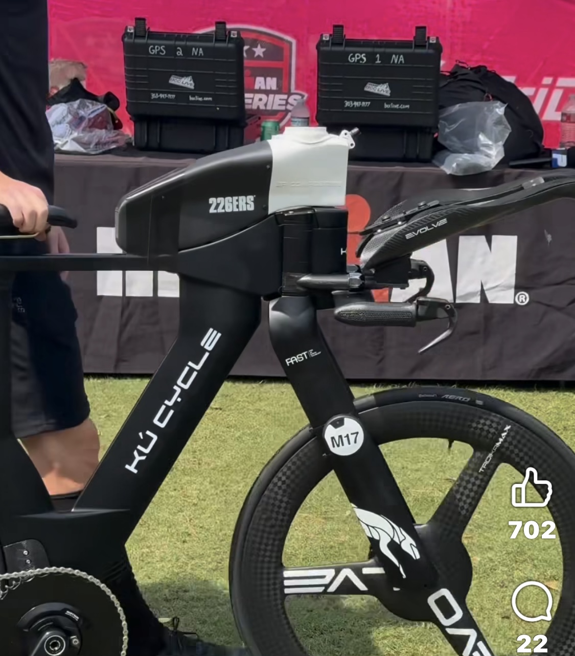

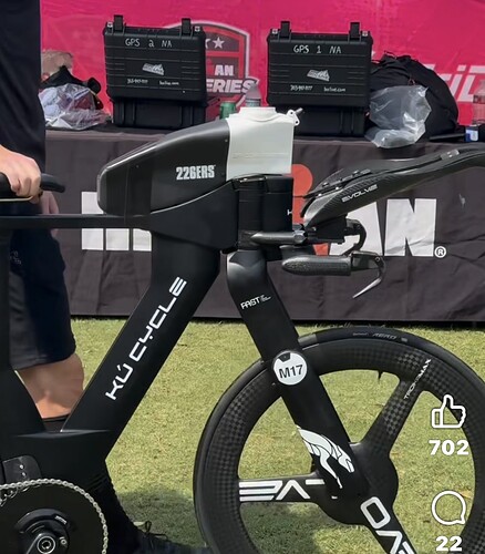

What about Ku bikes?
Any idea if this will be allowed ?
