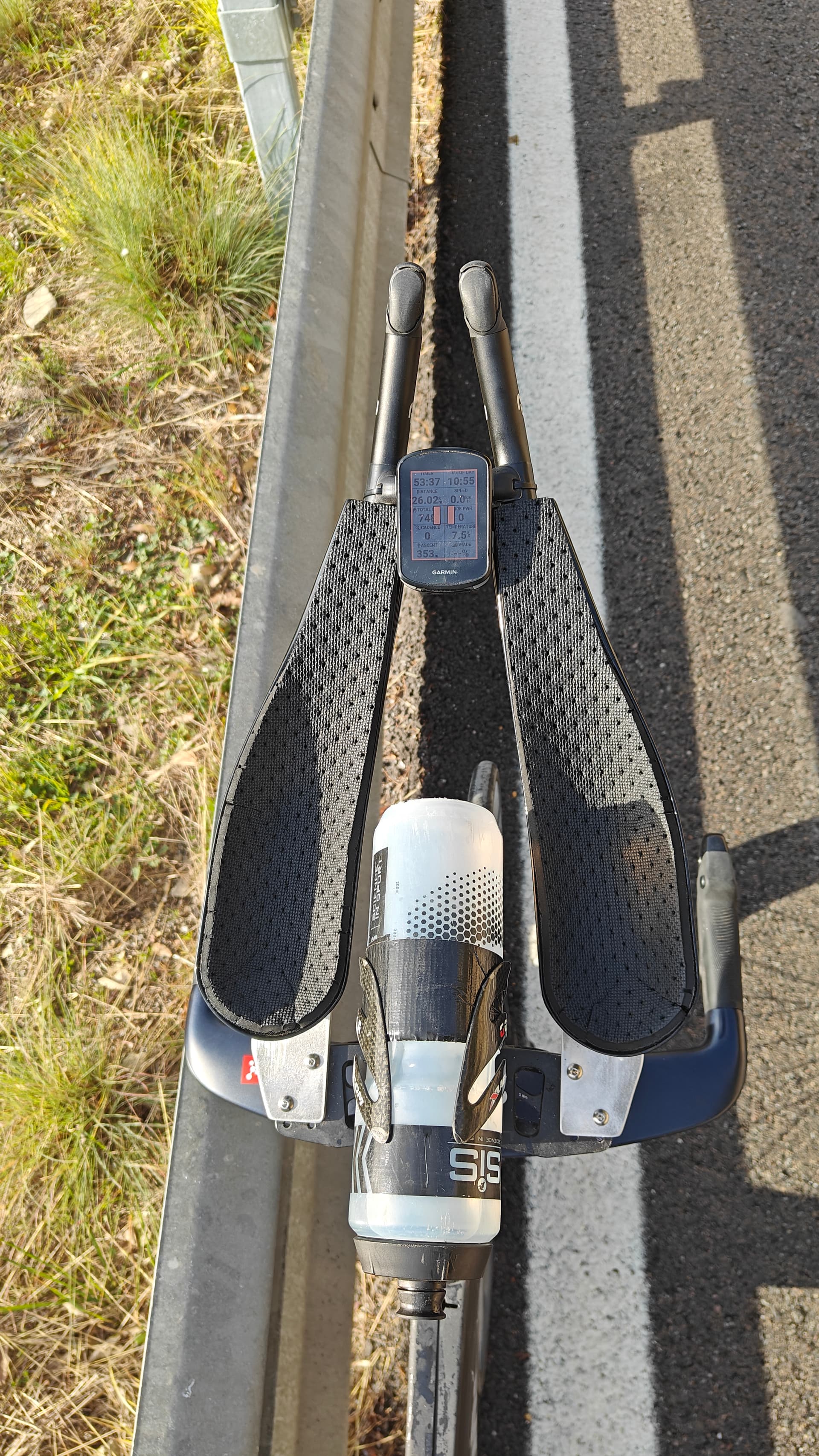

@Bryancd moved the bars 20mm further front and tightened bar width 10mm and its PERFECT!
Thanks for challenging me here!

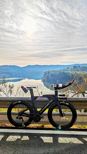

From today’s Z3 set:
Awesome setup and views!
Thanks! This is Pantano de Foix, some 50 km south of Barcelona, Spain
Yep that looks great!

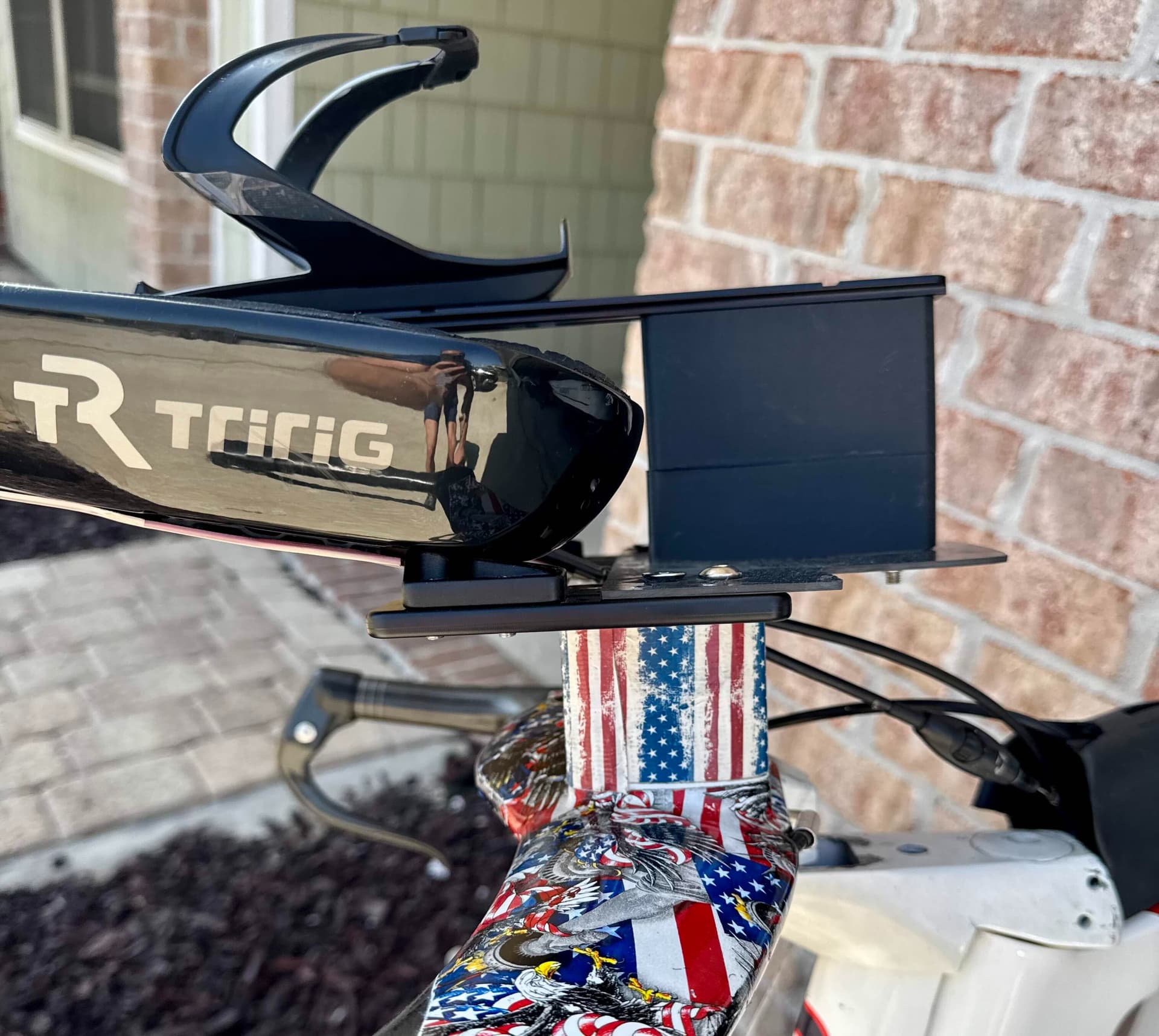

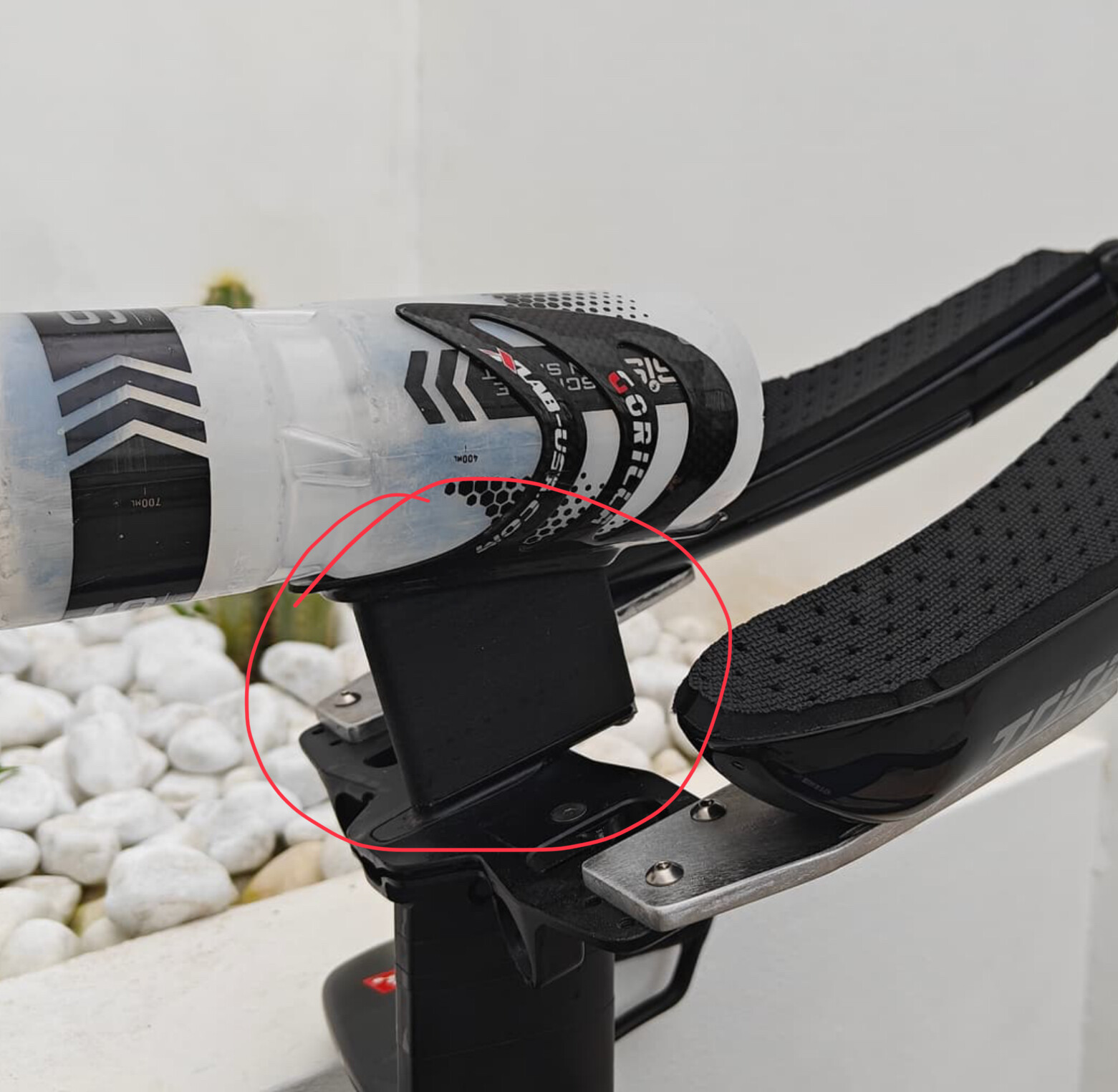

Mind sharing where you got your angled BTA riser?
This is (almost) exactly what I try to find!
Thanks!
You can buy a fasttt plate.
That is 3D printed. I can see if I can find the file, if interested?
Ah, got it.
Thanks for the offer, but I have no way to 3d print anything.
In what sense are you not able to 3D Print? Pretty much anywhere in the world you can get a 3rd party printer service to print and send to you for like 5-6 USD / EUR.
Happy to help you finding a service near you.

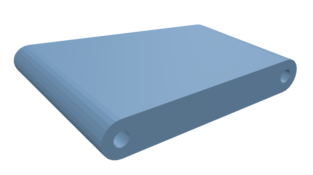

Here is a screen dump of the part: I have the STL or SKP files
Obviously the fixed angle must match the angle of your bar setup :slight_smile:
David! Send me a message. I’ll print you different sizes at no cost and mail it to you. Just supply your own hardware and you’re set. I have a 3d printer and have printed many.
Also more and more public libraries have 3D printers for use. Cost of materials typically applies but it’s getting to be pretty common.
SKP & STL files sent to David :slight_smile: Print away!
