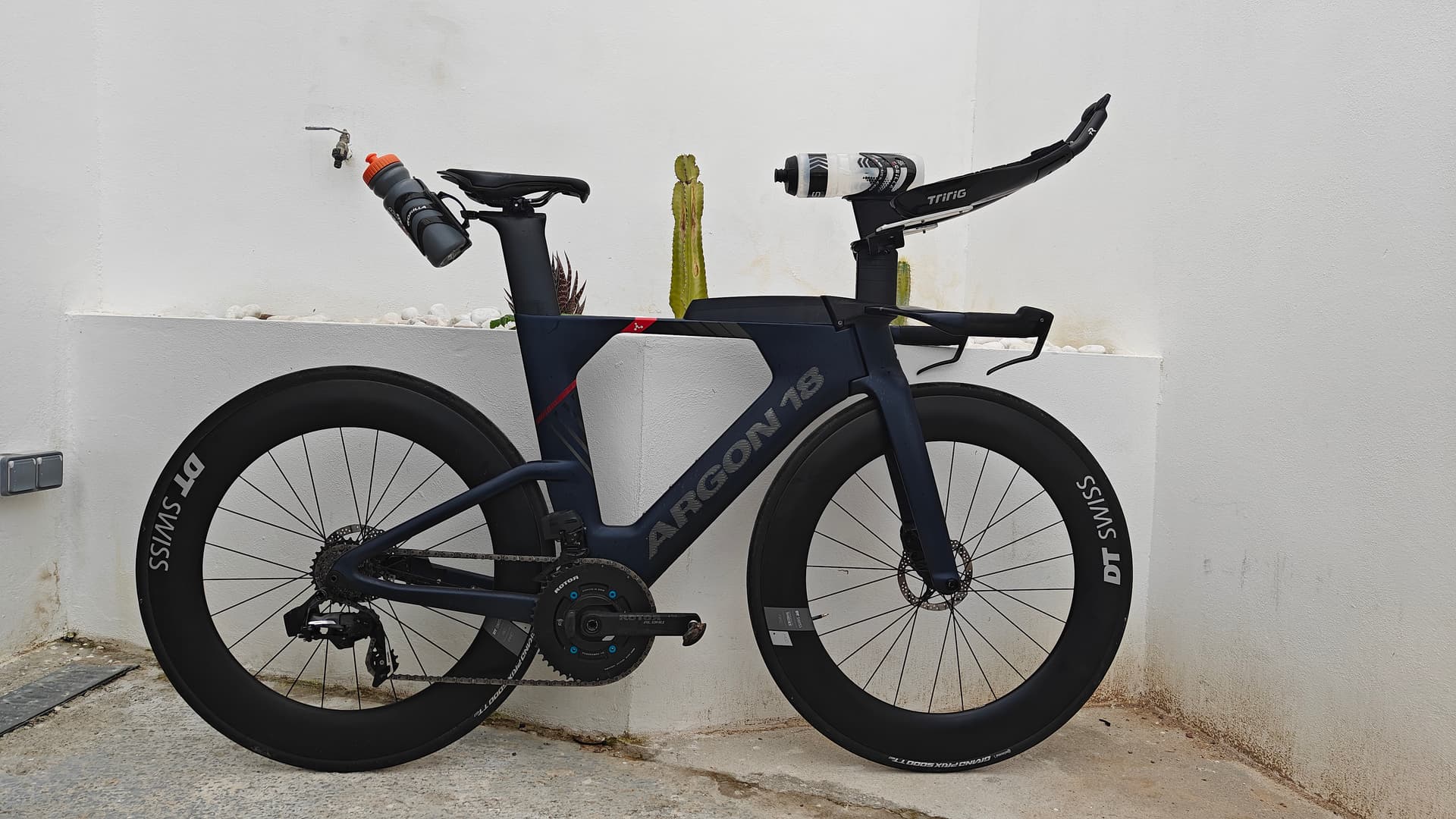

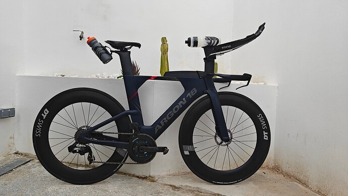

Here is a short flick of my Ultimate SL mounted on my Argon 18 E119 Tri+ from yesterdayĀ“s ride, last meters on the first small climb that I hit 10 mins from home. Breathing like somebody who had a bit too much turrón over Christmas … sorry :see_no_evil:
Looks beautiful!!
Thanks mate - the Catalan ā€œBig Surā€ called ā€œCostesā€ just between Sitges & Castelldefels, south of Barcelona. Not really cool, due to crazy many cars, except really early on a Sunday morning :slight_smile:

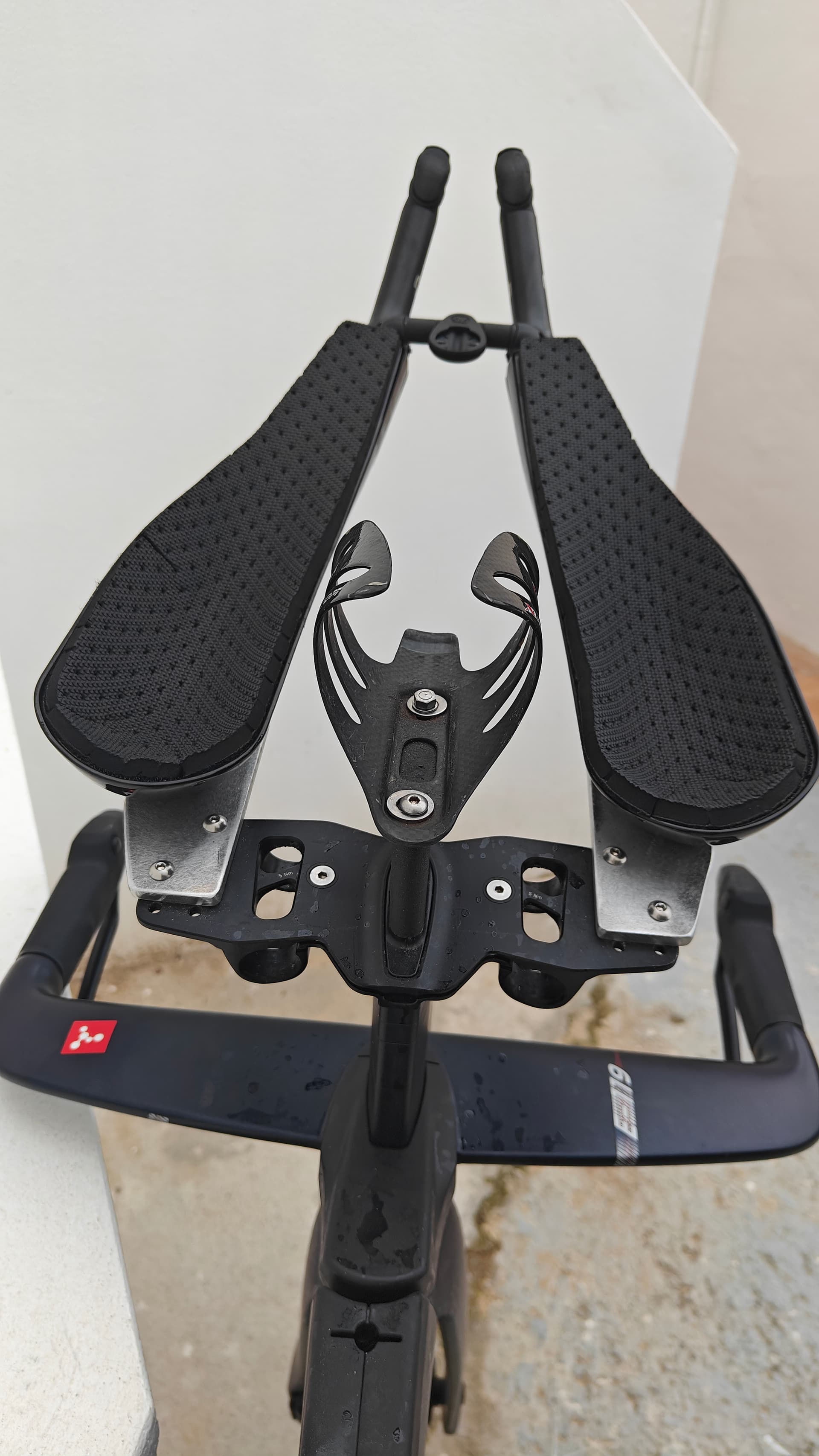

I d like to see your base bar looks interesting
@pk

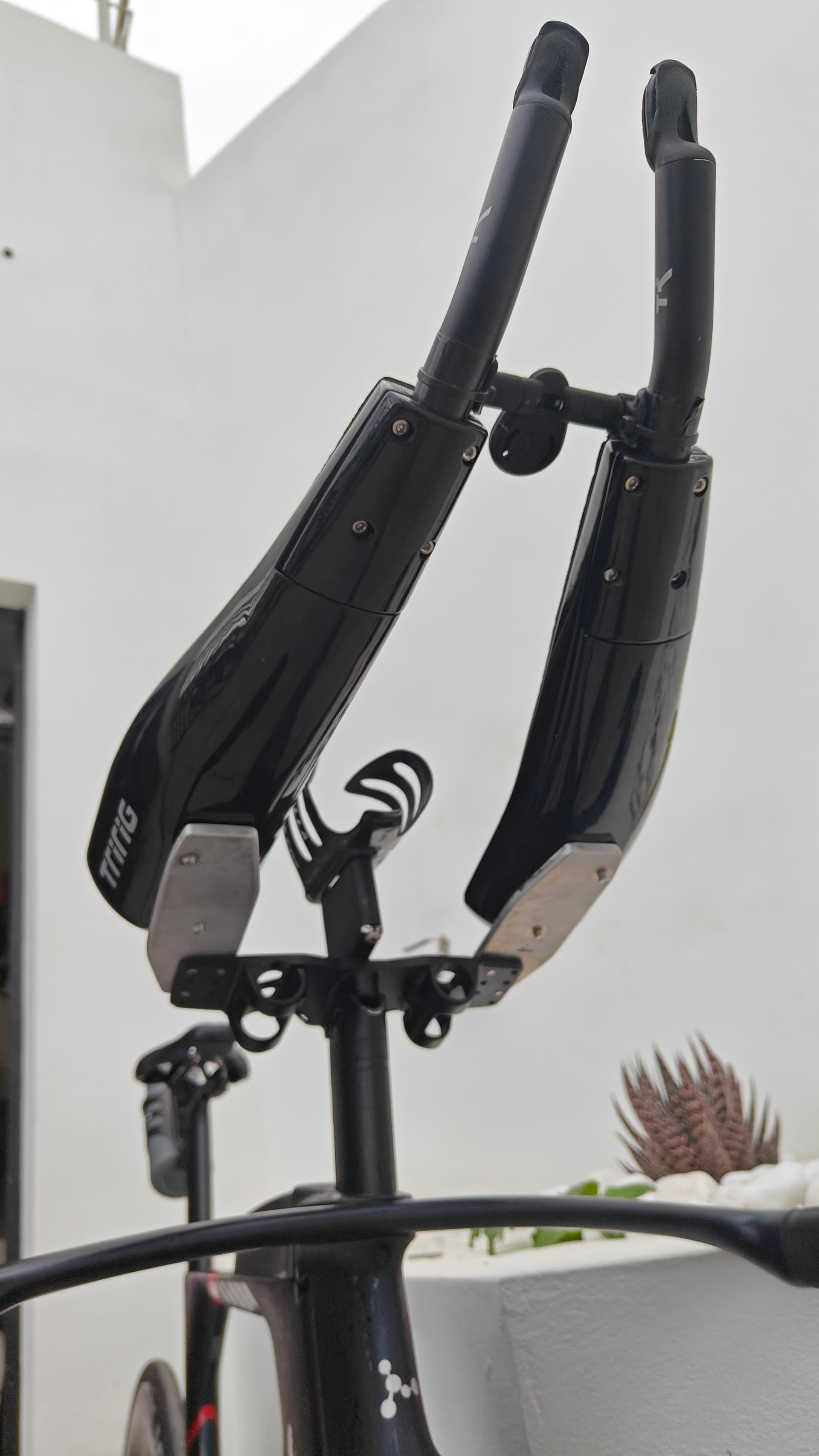

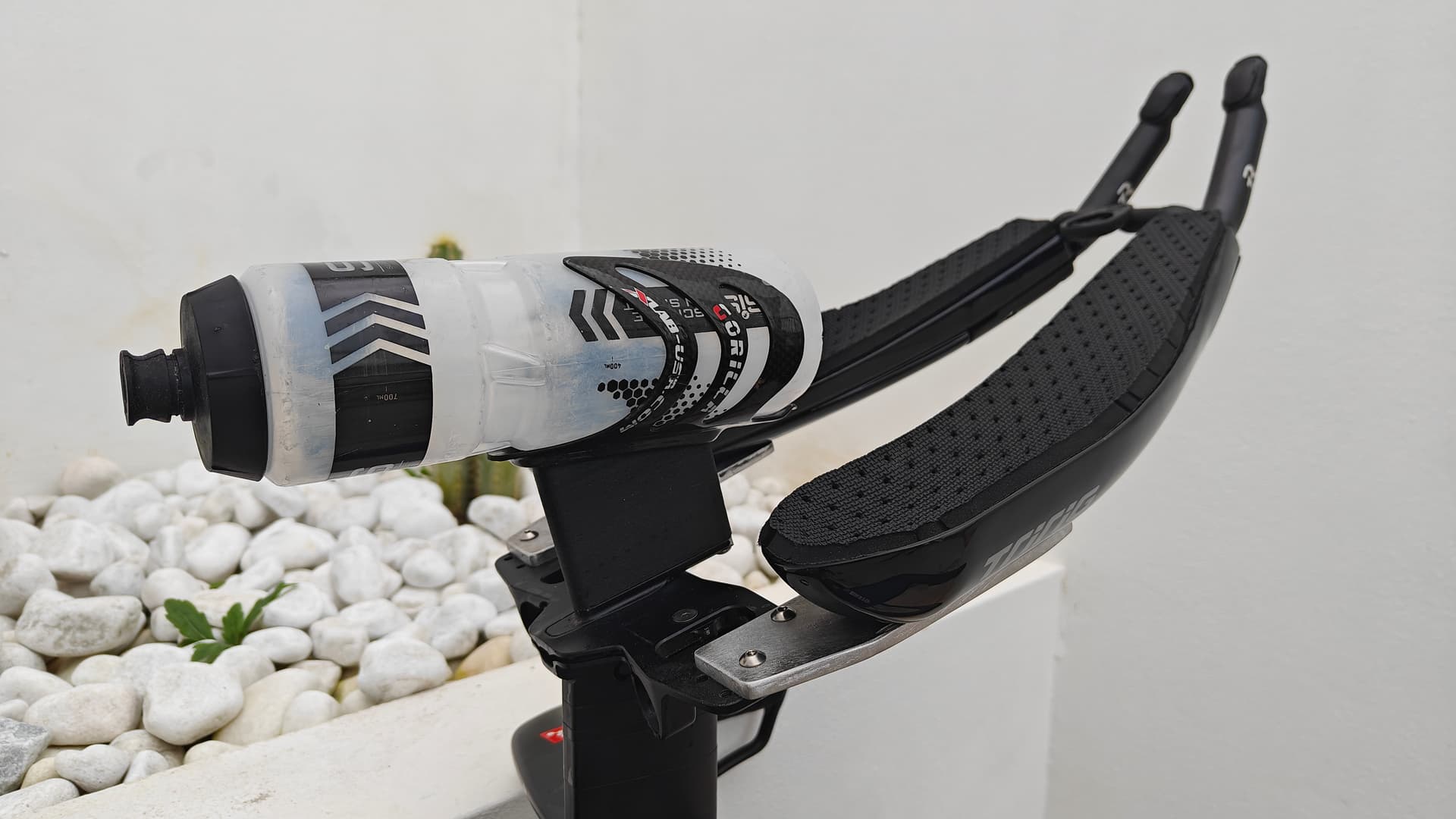

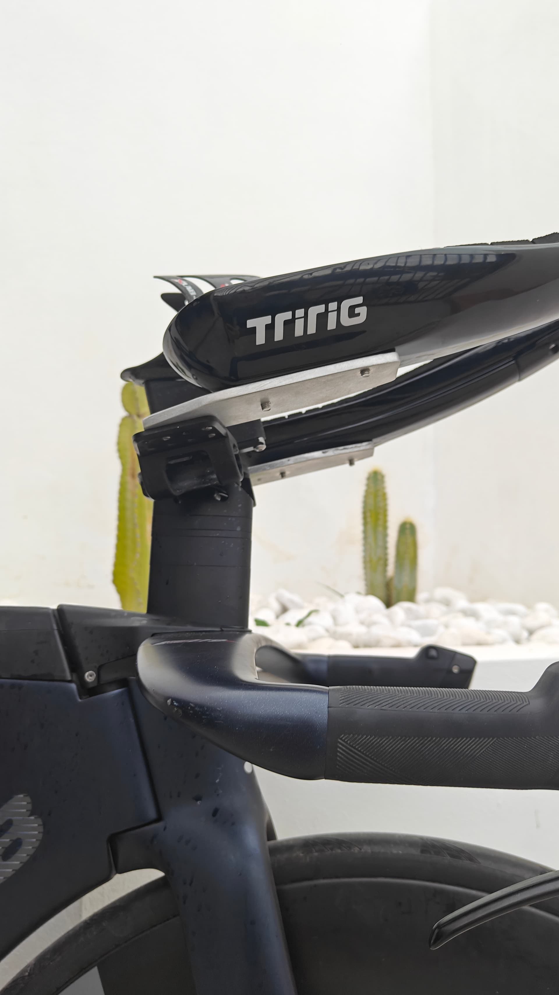

Still ā€˜prototyping’ this setup, so bear with me on aesthetics for now, but basically cut a 6 mm Alu plate to carry the armrest. Sturdy enough and very little flex. Here are some shots:
That looks good, would you consider bringing the elbows in a bit tighter?
Thanks @Bryancd - appreciated.
My elbows are actually some 5mm higher than my old setup (that I raced IM Frankfurt on back in August of last year) and a tiny bit more narrow elbow-space (also 5mm)
I am not racing Ironman this year, (just HIMs) and I can easily be 2h in this position now, so unless somebody tells me that even higher/tighter would be even more aero, I don“t think I will change this setup much, fitting done by Pedro de Arriba (Movistar and many Spanish Pros)
Haven“t really tested this setup just yet, but my old setup/position gave me 40 kmh at 200-205w on flat, good tarmac, at 75kg test weight and all race setup (disc, aero suit, calf sleeves, helmet)
EDIT: I tried even more narrow elbows and that creates trouble in my neck/shoulders. I am quite broad over the shoulders and I have always had a wider elbow space :see_no_evil:
What type and thickness of AL did you use?
Here is a photo from Amazon (Europe) where I bought it:
6 mm and looks like the Alu quality is 5083
Set me back 14 euros and some metal work
6mm is enough ? i have done the same with 10mm, for about 5cm reach extender. And that is f**g heavy :sweat_smile:
6 mm is enough for me. I mean it does not flex. So unless this Alu totally gives in, its more than fine. Most of the weight is still closer to the elbow, so limited weight distributed outwards on the bars.
