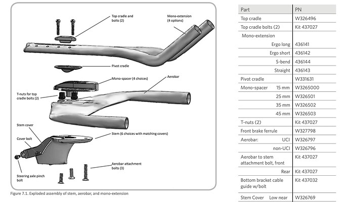

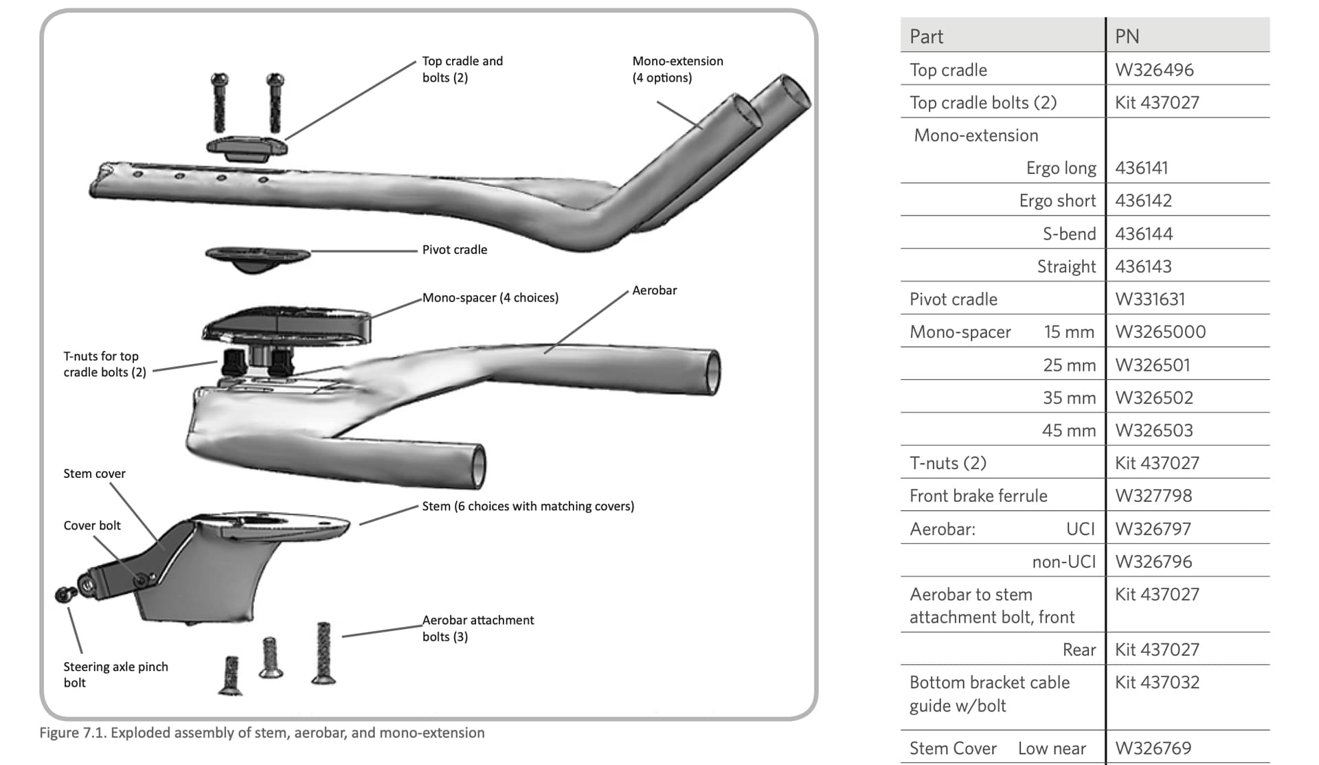

The gen 2 bike can you get a good amount of tilt with the stock setup. Upwards of 15 -20 deg. If you flip the pivot cradle 180 deg, you can get more. People complaining about the aero bar bolts breaking, don’t know how to wrench or properly tighten them. You have to incrementally tighten the bolts when you have any sort of angle/tilt on the bars so the load is shared equally across both bolts.
If you want to get your hands higher, get the mono-plugin and run any round extension you want. You can get a greater effective angle this way (elbow to hands).
Maximum tilt angle you can achieve with a gen2 stock setup is around 15°. That is with the pivot cradle flipped around (set screw facing forward).
If you need/want more, you need to rely on expensive aftermarket solutions such as FastTT, Aerocoach, Wattshop, …
Hi there - you mention being able to get 15 degree tilt with stock setup. Could you elaborate by what you mean with stock set up? Which parts exactly? I am struggling to find a trek speed concept Gen 2 mono riser with an angle as shown in this last picture. Noted on flipping cradle in addition. Thank you!!
Loosen the cradle bolts and rotate the mono extensions upward. The mono extensions will rotate along with the pivot cradle. Reverse the pivot cradle (turn it 180 deg) to get the max rise. Once you have your desired angle, tighten the pivot cradle bolts incrementally. Do not tighten one bolt fully and then tighten the other fully. This will cause one of the bolts (the first one you tighten) to take all the load and stress. And it will likely shear off.
