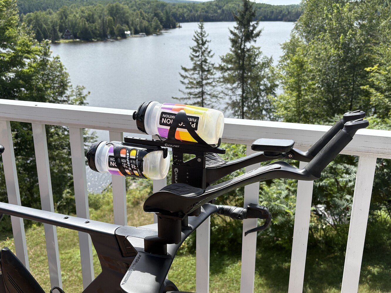

I guess Ironman are not using the World Tri rules, but pretty sure that the bottom bottle cage with a one litre bottle in will be >250mm to the rear of the reference point (bottom of the lowest point/directly below elbow point of the elbow rest).
And the top of the top bottle will be close to >200mm above the reference point. Though likely an ‘angle of image’ effect.
But you can tell us the measurements.
That was an early pic. Jeroen (@anon62099856) picked up on it and we corrected

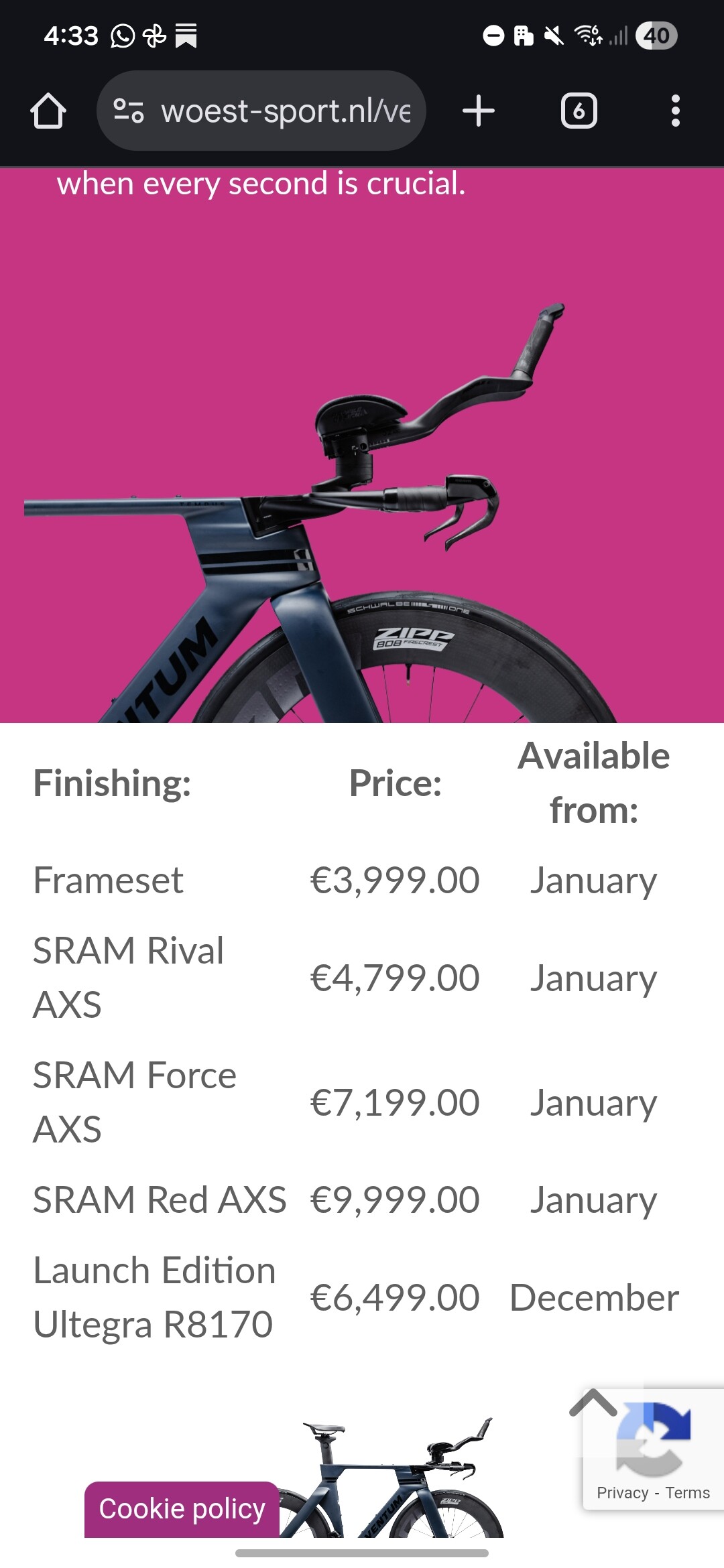

So this appears to be a thing. EU distribution is right around the corner! Now I can finally replace my Shit Max errr speedmax.

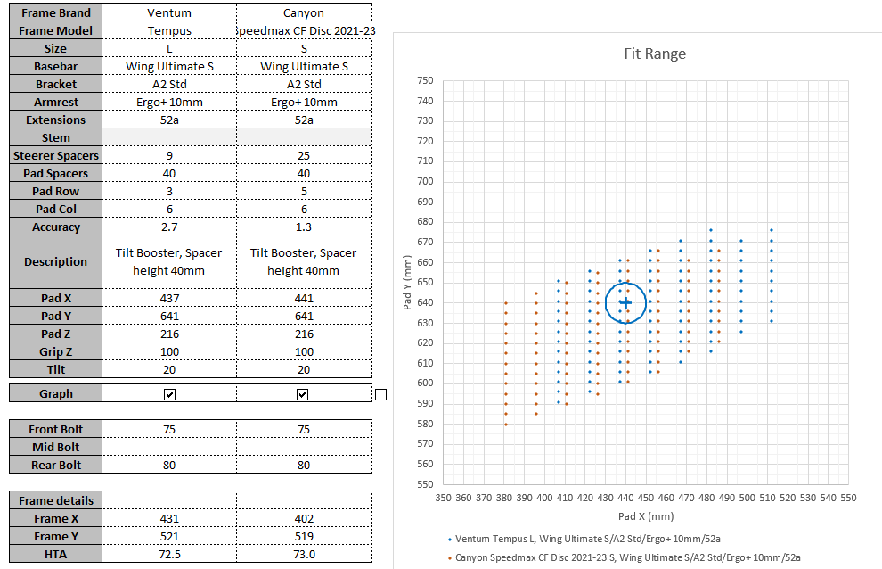

What are your pad XY numbers and tilt on the SpeedmaxXAerium?
Sorry for the delay in responding. The little one is in a bit of a demanding phase :sweat_smile:
Assuming I measured correctly, pad x 440 pad y 640 on a size S measured by the back of the pad where my elbow is with the extensions at roughly 20 degrees.
I’m afraid that you’re going to find that the little one gets larger and the demands change but they don’t stop.
Because the Speedmax is quite tall you get the same Frame Stack from an L Tempus.
I don’t have the details for the cube bar, so I just put the Wing Ultimate S in for comparison on the Speedmax.
A medium Tempus would have you right at the top of the fit range - the 20deg tilt means that the pad loses a lot of stack.
