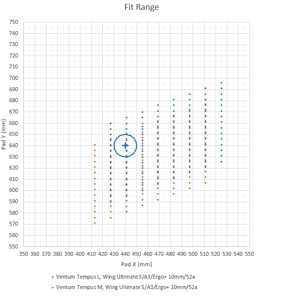

Wow that makes me curious if the SpeedMax has strange sizing. My pad X is maxed out mechanically. I would need the PD reach extender to get more out of it. Pad Y I could go up or down a few centimeters comfortably. Would that put me on a Medium?

For the bikes - yes the Speedmax CF is one of the taller frames. And I suspect the Cube bar is a little shorter reach than the Wing Ultimate. Ventum is sized quite small
In the next few months the Ventum will be supplied with the A3 bracket, which will natively support your aerobar angle and have more reach adjustment. If you were to get one now you’d need the tilt booster with the A2 bracket.
I’d still be more inclined towards the Large, although longer bolts will soon be available that allow 20mm more stack, so you wouldn’t be as close to the top of the range on the Medium.
I was between a M and L (5’10 with 32.5 inseam) and with the adjustability of the PD front end, I am happy I went with the Medium

Why would you buy the Medium with this amount of reach extenders and Spacers? You Ride a Position for a frame two Sizes bigger
I suppose I should have expected the fit experts to come out on here. Ultimately it came to relatively short legs and a taller stand over height. I don’t believe you actually mean to imply that at 5’10 I should be on an XL frame.
Not claiming to be a fit guru here, but IF he’s stable on the smaller frame and in a comfortable position, wouldn’t that, on average, allow more power transfer and better aerodynamics? Happy to be corrected if wrong, because I’ve occasionally wondered if I shouldn’t have gotten an XL frame and went with Lg…
this is a problem for frames with raised top tubes - it’s easy to run out of room for the seatpost.
We’re starting to see frames with more reach to enable positions like this - without the need for aftermarket extenders on the bars. But it’s not common yet.
Larger frames are usually more aero
The position comfort/power are independent of the frame size (unless the frame prevents the position)
Stability is somewhat individual - some people really need the longest frame they can get. Others are fine with less front centre (not to say that they wouldn’t feel more confident on something longer, but it’s not a limiter)
If that is the case, short legs/long torso, you just bought the wrong frame as this one is really short in reach. At first glance it doesn’t appear to be that but it is due to the 82 degree seat tube angle. And that’s is why you now need that amount of extra parts to get more reach.
This Ventum is a great bike, even greater bar but with a very specific geo that will not fit a lot. Now, if you had long legs and a short torso…….. :-).
