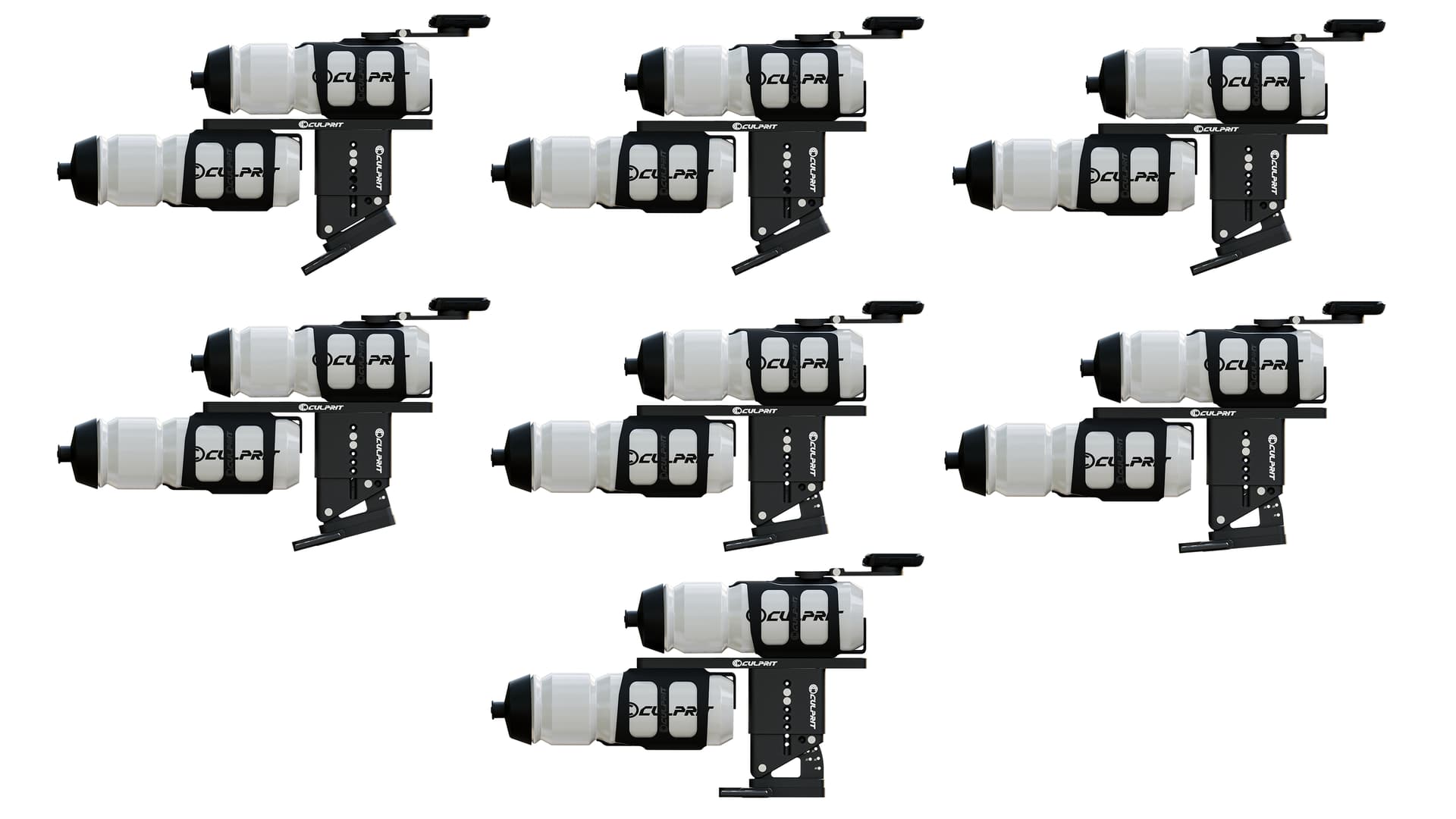

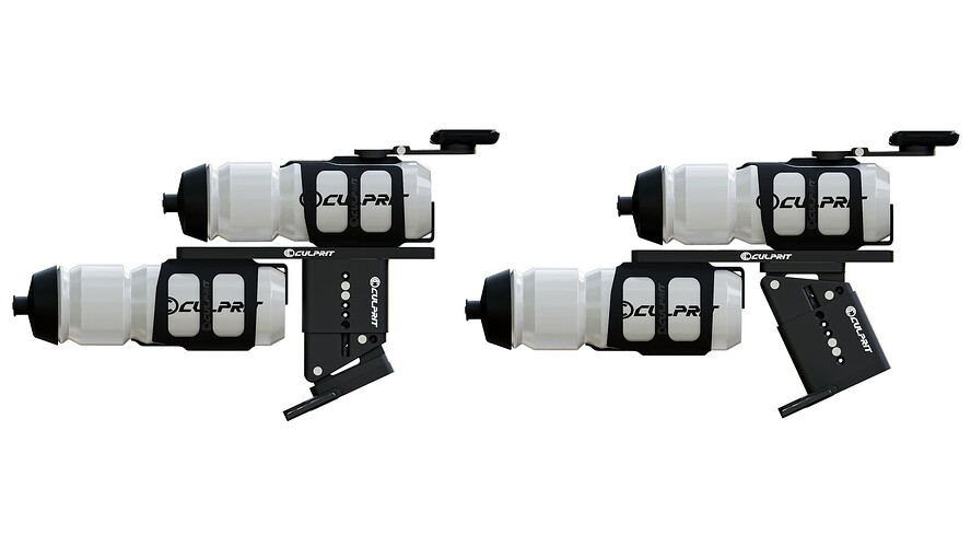

Is there yet an off the shelf bta solution for this bike, PD does not make one.
Also does anyone that owns one of these know of you can add spacers under the stem for increased stack or is it precut at the factory
Culprit’s seems to work. @marcag has been using it on the Tempus. I think it’s this model , but he found a work around for asc pro. If using the other standard 22.2 clamp hardware this should go on top easily
Also our cages will be ready soon and computer mount is being made. All ready in about 2-3 weeks. But BTA riser and bridges can ship now
That seems epically ironic - that a company known for leading BTA hydration products, does not offer a solution for their top cockpit product. What product manager screwed that up???
They make one, it’s just had delays in production.
I used the Culprit on the ASC pro Aerobar which is optional on this bike
If you get the standard PD ASC 52 setup, I think the TriRig would also work.
