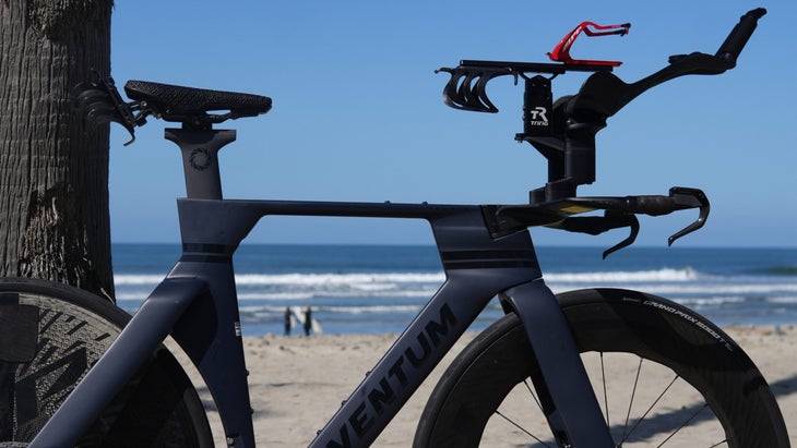

Yes, but that setup requires buying a new set of aerobats. Doable, but not ideal
OK, but what is that? Not clear that it’s off-the-shelf.
looks like it’s from tririg
photo fro triathlete.com
I suspect there is a “bridge” you can put between the two columns of spacers and then stack the bottle from there
Im just finishing up at review on that set up :slight_smile:
correct - I did want to show that there were commercial solutions, and if there’s one, there are probably a dozen more (an additional one pointed out by @marcag). Hope @E_DUB article elaborating on Kanute’s set-up helps further
Ventum athletes have access to a bta bridge prototype that is specific to the riser system. Still a few months away from the production version.
Also note that kanutes setup won’t pass the new DTU rules.
So if I want to race on this at Nice, I need to swap the bars or hope the BTA mount becomes available
If you’re in need of a short term solution and have a lot of stack, then an A3 Adaptor, A2 Bridge and A2-A3 adaptor would allow fitment of the A2 BTA. That would be a costly way to do it and not approved for multiple bottles.
There is a chance the production version of the A3 BTA Bridge will be available by Nice, the prototype has passed fatigue testing. Keeping in touch with Ventum would probably be the best way to know.

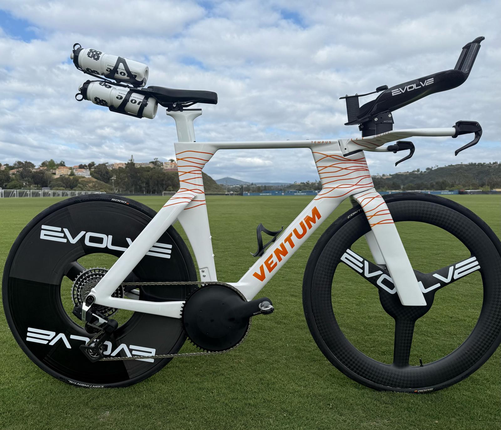

This is also outdated… I saw Kanute’s bike yesterday. He has FastTT aerobars for IMTX. They are longer reach than the PD extensions pictured here, I’m pretty confident. I don’t remember 100%, but I think he does still have this PD reach extender.
This is an Evolve bta solution.
As for the geometry discussion, note that this is an XL frame. This provides the longer reach I was after and I have zero issues with stand over height at 6’1”. as slowman wrote, ignore T-shirt sizes.
The Wattshop cranks pictured can be adjusted from 160-175mm. I think this crankset needs to be more widely adopted because it allows the rider to select crank length over a 15mm range and rather than theorizing what is best and purchasing a crank based on that theory, the rider can choose the length that best engages their glutes while not inhibiting getting over the top of the pedal stroke.
I’ve increased the pad stack height from original article:
@redcloud Kanute was also on the V8 saddle yesterday at IMTX, along with KB, RVB and Wurf.
Not only increased the pad stack from the original article, but also put the saddle further back and much lower.
Jeroen
The bike was not fit when the photoshoot was taken, but the saddle is lower and with the rider on the bike, the effective seat tube angle, measured from where the pubis bone is in contact with the saddle to the bottom bracket, is 84.5°. The fit would look pretty similar to how you see Rudy, Sam or Trevor set up.
Didn’t you have to name custom extenders for Rudy on the Hanzo ? The specs only show 4mm extra reach in the XL. Is this right ? Or is it how/where the other extensions mount from ?
