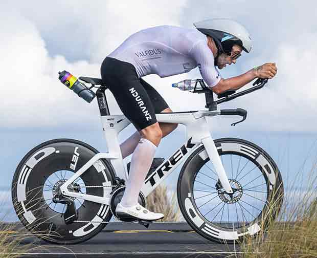

It started to really gain steam in 2022. Here’s 5 positions from Kona 2022 that can’t be replicated on a stock setup. I’m sure there’s more if I dig further.
Laidlow above
