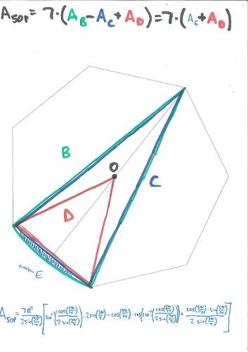

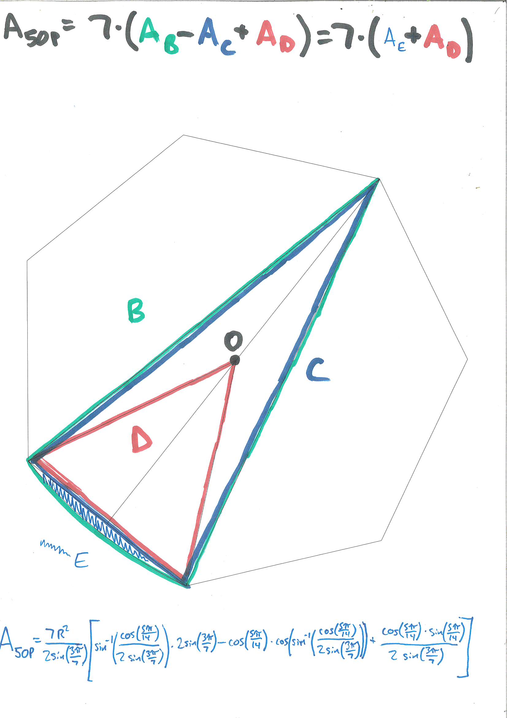

Here’s the wrong way to do it, obvious in hindsight, with my approach drawn and the embarrassing result of not doing enough geometry and doing too much trig at the bottom (although I’m confident it’s correct…). You can sense from afar my despair at being confronted with the daunting task of simplifying that to the very tidy result they’ve asked for. I see no point in sharing the 4 very messy pages it took to arrive at this, save for mocking its complexity, and by extension, me:

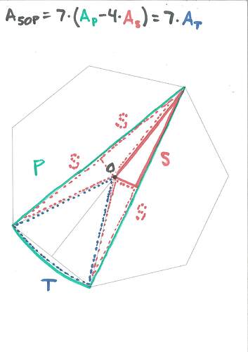

Here’s a much better approach:

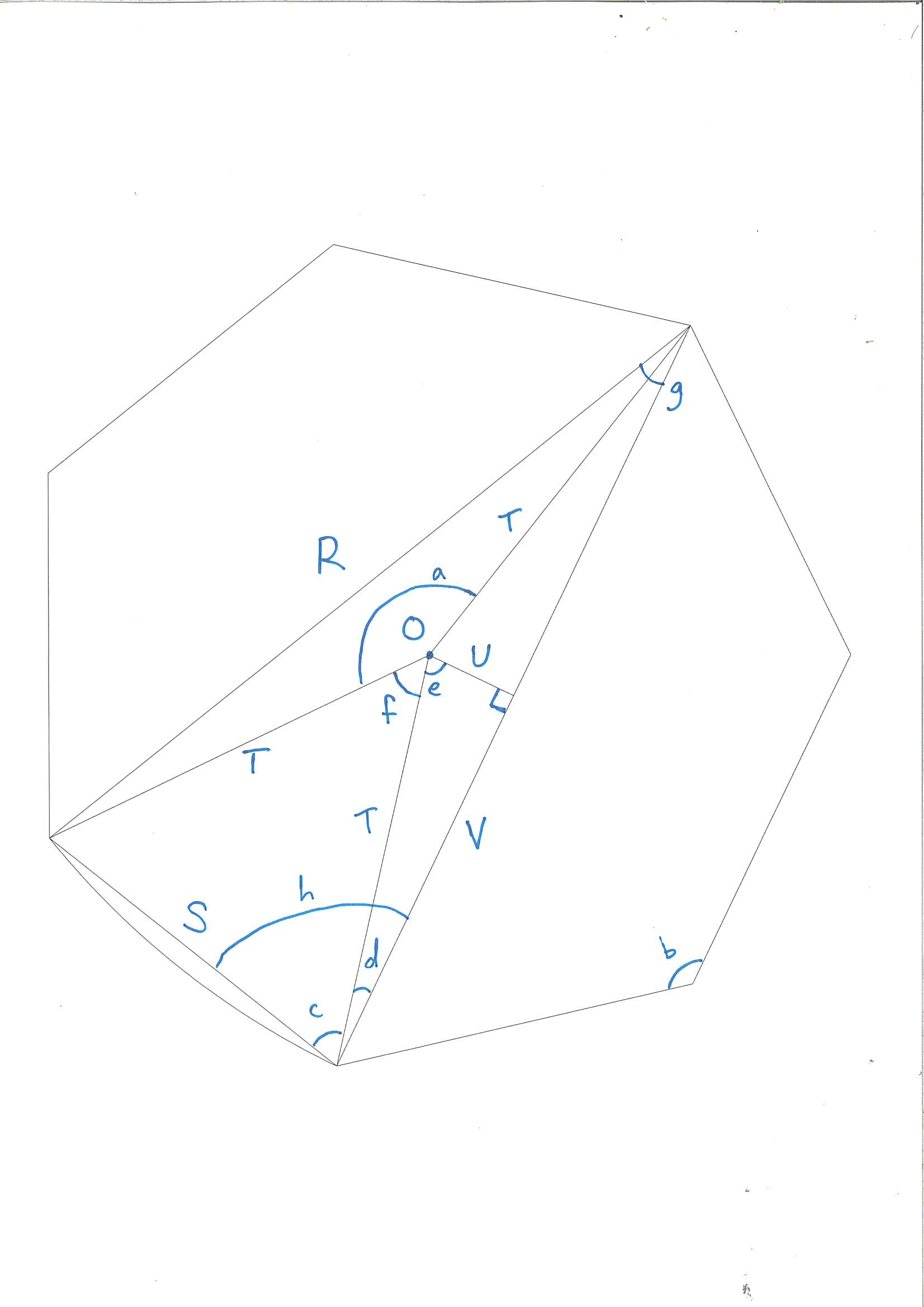

And let’s define some angles and lines:

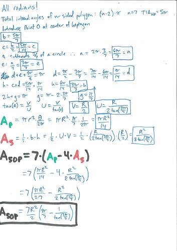

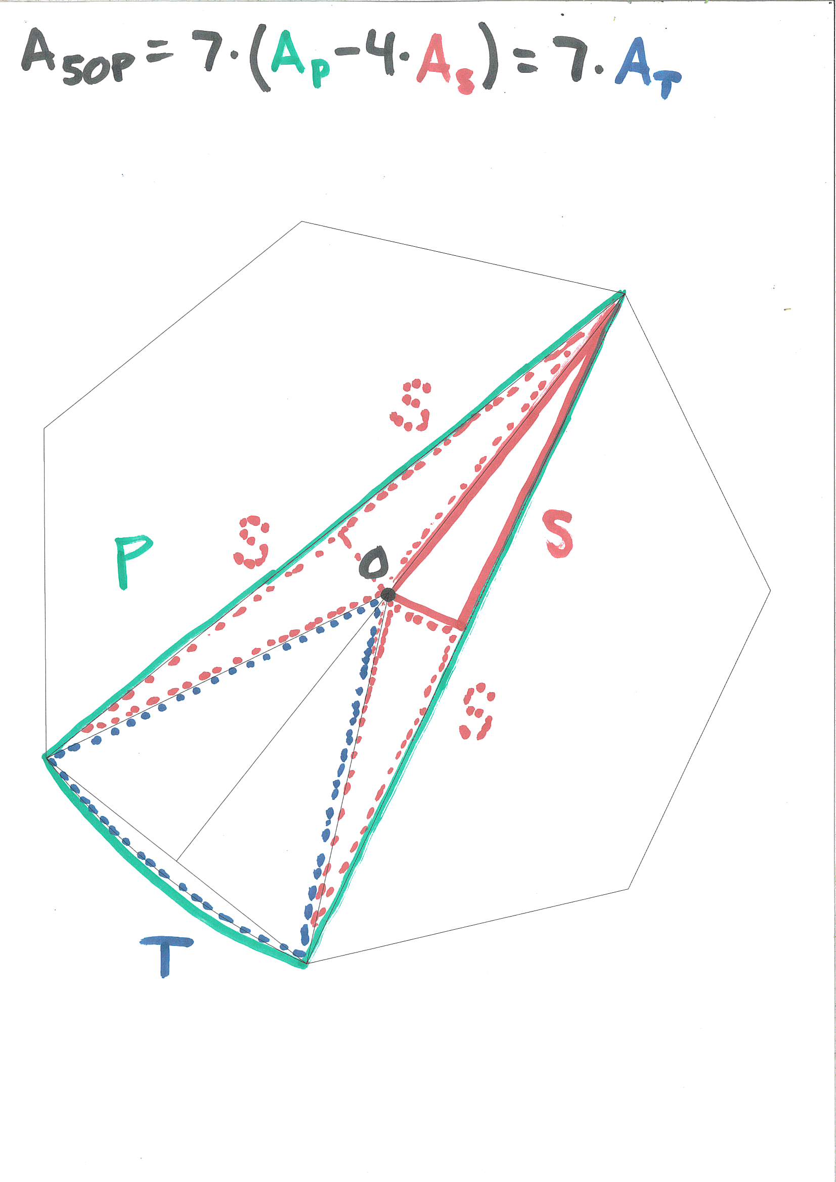

And here’s the proof based on approach and definitions:

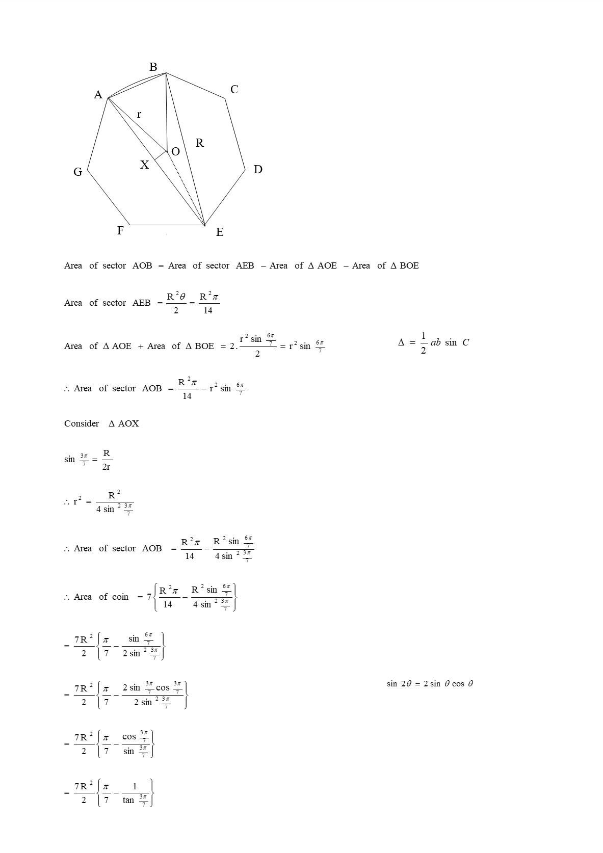

Time to upload the solution to the problem I posted upthread.

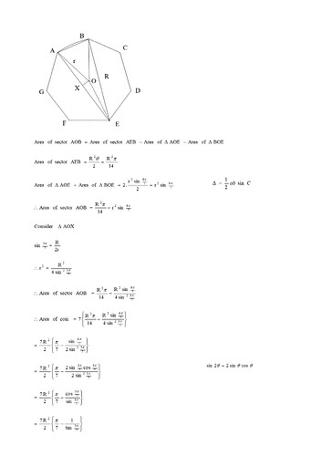

Renorider, you nailed it with the second approach. First time I tried it I also took your first approach. Not great in an exam hall, and led resulted in a Sliding Doors moment that means I do what I do now instead of having led a completely different life with a different degree, career and family. Weird.
For some of the apparent short cuts:
- The first theta is a reference to the general formula for the area of a sector.
- Angle AOB is obviously 2pi/7. That means that angle AEB has to be half that: AB and E are on a circle with centre O, and there is a geometry theorem that states that the angle that A and B make at O is twice the angle they make on the circle.
- It’s slightly easier to use r rather than U/V, particularly as you know R = 2V.
- working out the area of a triangle using 1/2(a.b.sinC) works a bit better here than 1/2 base x height.
I’m hoping it provided Dr T with a little bit of entertainment!
Nicely done!
I missed/forgot this shortcut you used: there is a geometry theorem that states that the angle that A and B make at O is twice the angle they make on the circle so I had to get there the longer way.
And also for the r vs. U/V shortcut, once my head was in the right space, I settled on U/V instead of r (and also 1/2 * b * h instead of 1/2 * a * b * sin(c)) as it avoided the messier expression of r in terms of R and directly yielded the 1/tan(3*pi/7) term without the double angle identity. I think I was so traumatized by the first approach that I wanted that clean tangent term without any sorcery LOL.
But of course, because math is righteous and awesome, there are multiple ways to get there, as you’ve shown!
