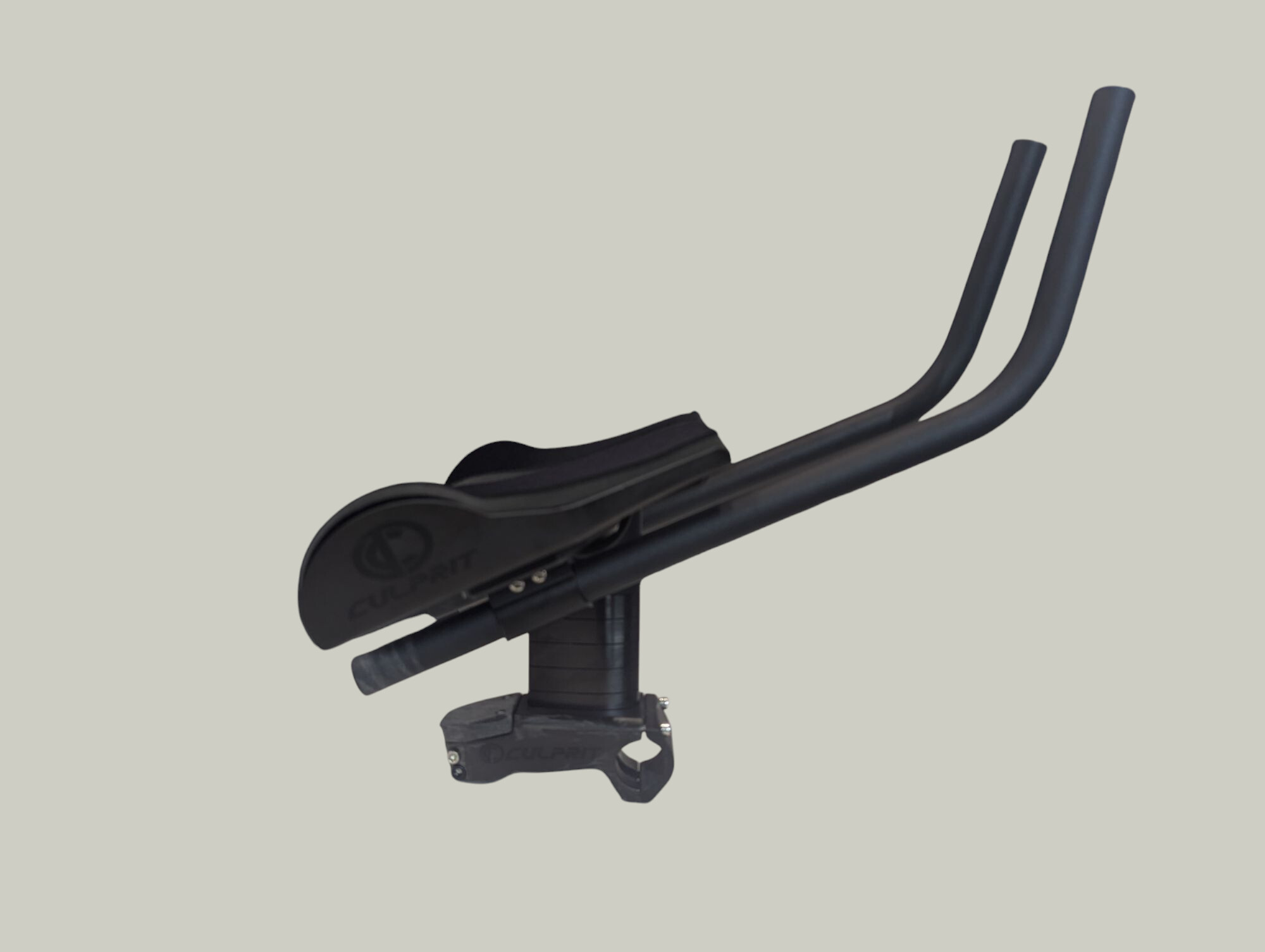

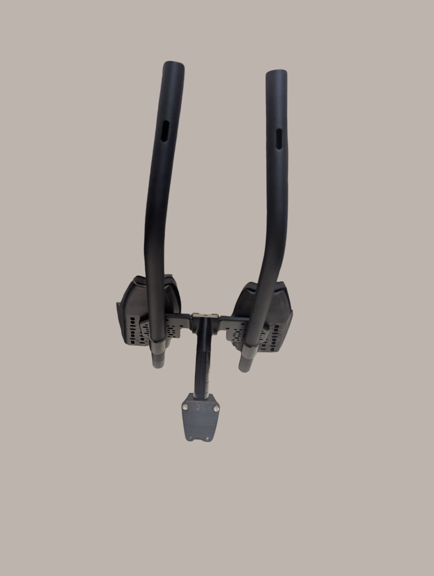

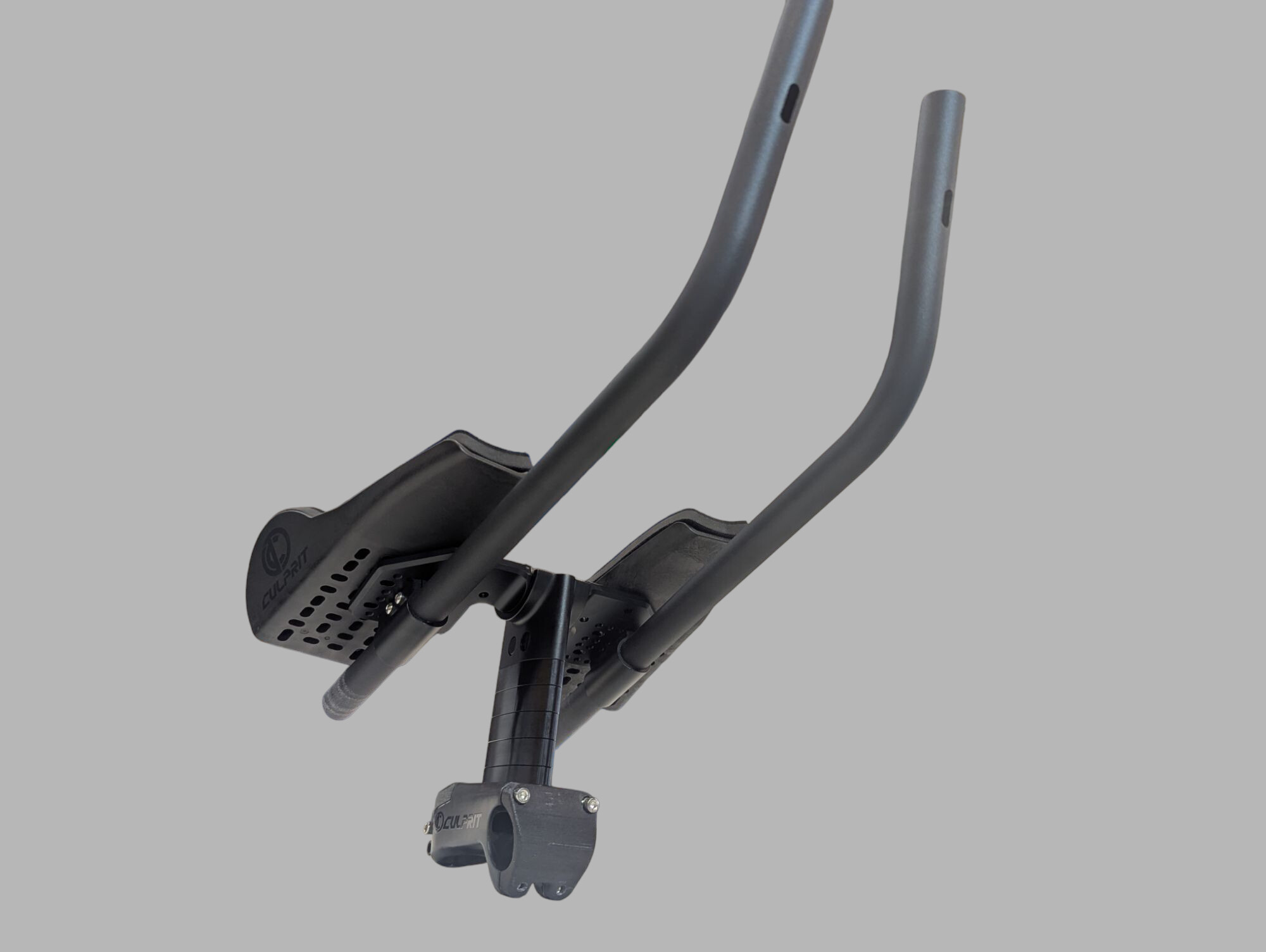

I’m developing one. Carbon stem itself already passed testing (80,90,100mm ) later will offer 110,120,130 mm options. but will test with aerobar assembly in a few weeks. Carbon stem with monotilt assembly.
Target 250 usd stem. Whole assembly as shown 600 usd.
Looks nice, but unfortunately will be a bit too late for the rider concerned’s setup. Will keep it in mind for future personal use.

waiting on samples to do safety testing, likely test system mid May, if all goes well production by the end of the summer. Sorry I wish it was sooner but I must do thorough testing before I sell items

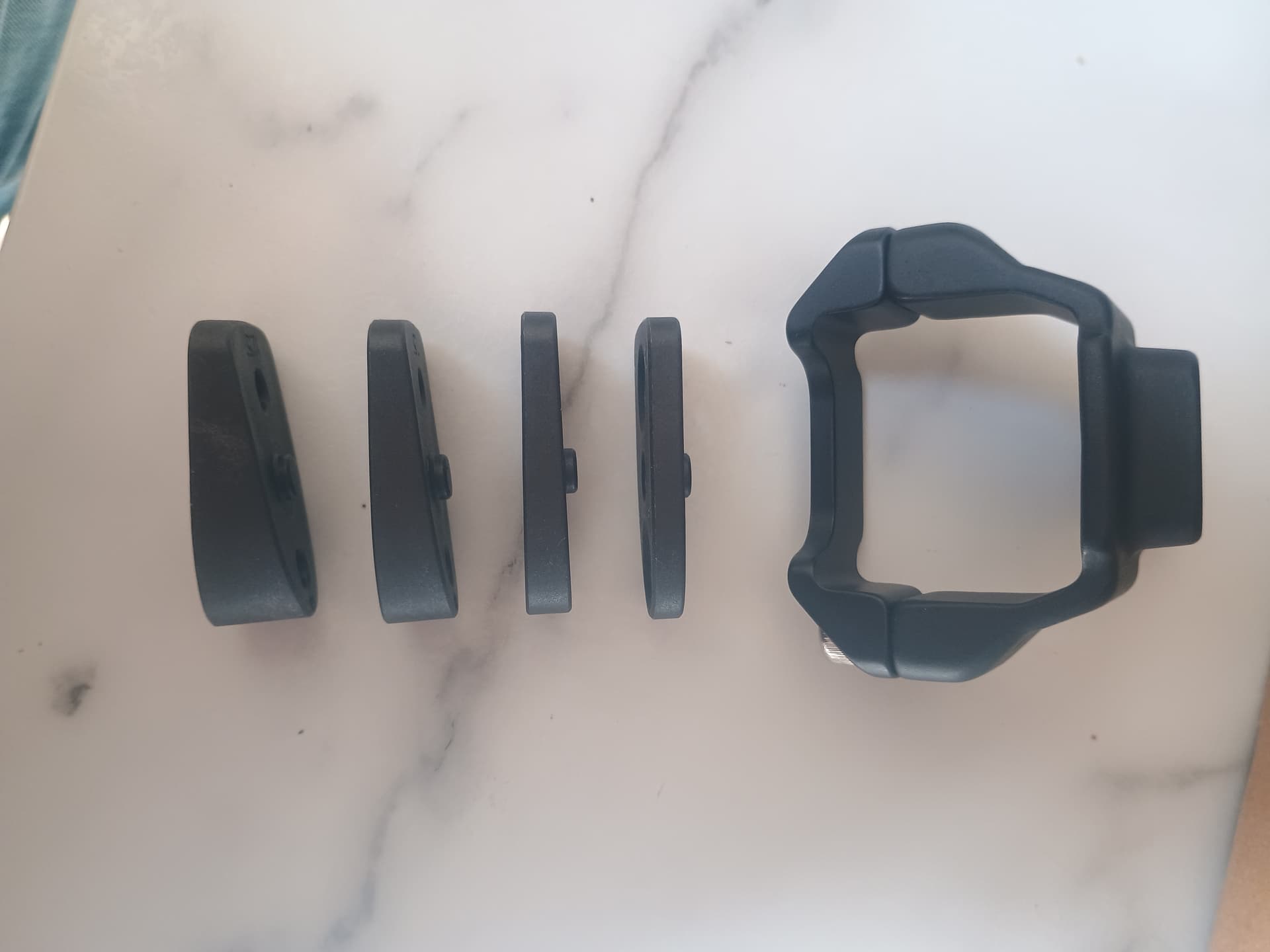

If it helps anyone I’ve just taken delivery of the Giant Tri cockpit for my '24 propel for some hilly races coming up.
They do tilt. The bracket has some wedges up to 12.5 degrees.
Initially I thought they were over priced, but the main bracket part is carbon which I was pleasantly surprised at. I assumed it would be forged alloy.

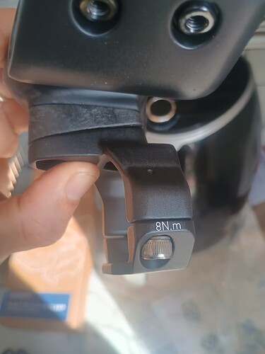

Not sure how cross compatible the stem would be as it’s specifically designed to clamp on Giants D shaped steerer tube.
Pics. I am unfamiliar with the model
I’ll try and post some over the next couple of days.
0 degrees, 2.5, 7.5 and 12.5 wedges. You can see the stem clamp part is sloping down to work with the -10 degree rise stem and 73 degree head angle so it starts off flat. The 0 degree wedge is essentially just an optional 5mm spacer.
