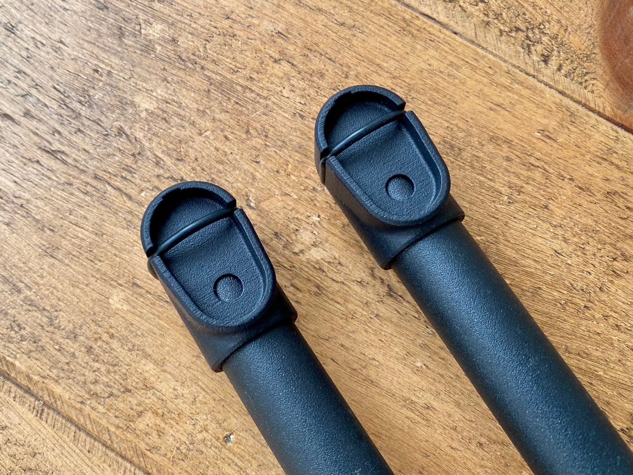

I have the 40 degree finger activated ones but they’re not installed yet. I tend to stack my hands and puppy dog my extensions, and with my current Di2 setup I always accidentally shift. I’m hoping once my bike is SRAM I won’t accidentally bump the wireless blips. But the main reason why I picked 76 Projects is because they seem to be the most secure both inside the extensions and holding the blips (they don’t rely on a pressure fit alone).

Thank you. I don’t see the 45 degree on their site . . . am I missing it?
Try this…I still see them over there…

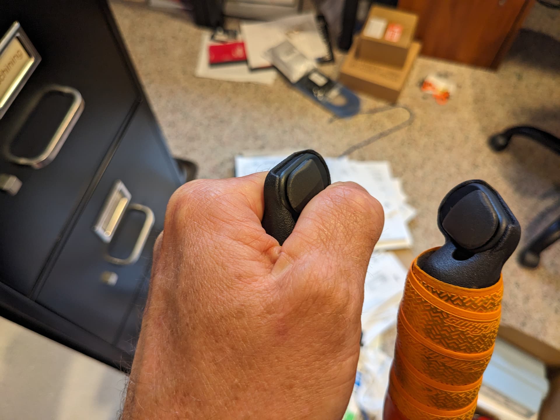

I started with Leap Components mounts, but I didn’t like resting my thumbs on the buttons as it sometimes caused accidental shifts over bumps. So, I designed and 3D printed my own such that my thumbs lie along side the button (thumbs side by side down the middle) and I simply roll my knuckle outwards for a shift. It works perfect.
I’m currently using these…
Only thing I don’t like about them is the blip is held in by friction and I’ve had them pop out… may put a little silicone or thin two way tape, otherwise they work well for my setup. I’ve since gone to a raised hand setup but same setup on the ends…
I have another design I’m going to print and try, more of a grip vs. just a very short extension.
Yeah the friction fit worried me so I went with the Projects 76 carriers.
