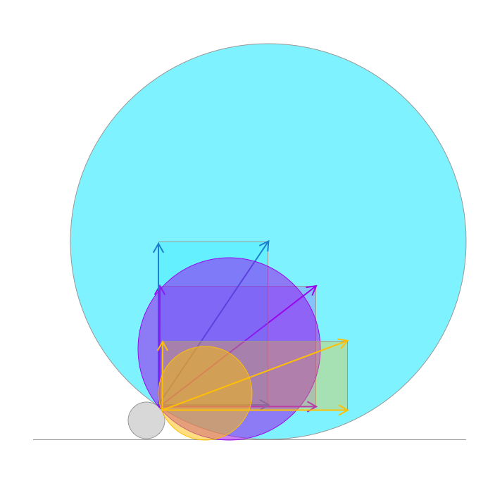

HTupolev… you are correct that the vector is diagonal and some force directed up and some back… this why to understand which forces normally one would split that diagonal vector into one facing straight up… that you don’t need to consider because that portion of the force just going to be returned as the bike goes back down and as the tire returns from being deformed… AND one facing backwards…
I drew diagram below a while ago to try to understand how/why a smaller wheel would be more affected by a given obstacle of a given size… tend to roll slower as Silica velo mentioned in their video…
First you draw vectors from example a pebble through the centre of the wheel… the length of the vector is measure of magnitude, so they are all the same length (same weight rider and bike riding at same speed)…
you’ll see that the magnitude of the backward facing vector is larger and larger the smaller the wheel compared to the obstacle as observed in real life… ever hit a pebble with a shopping cart? LOL… can imagine if the obstacle was the same size as the wheel (brick wall) ALL of the force would be directed straight back…
