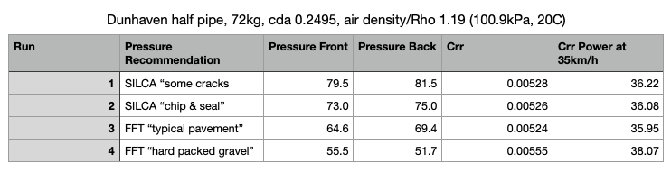

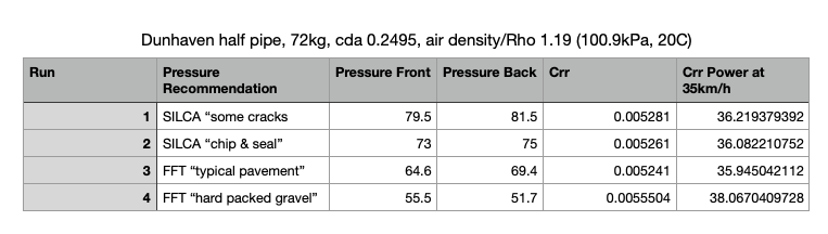

So here are my Chung analysis result… this was my first crack at this and likely was a little too windy, so the data was a bit noisy so YMMV… might try again… probably the most significant finding is that the difference appear to be TINY except for the FFT “hard packed gravel” recommendation… this was also on super smooth pavement… much smoother than I typically ride on, but a half pipe type parcour as required… going to find a more typical, bumpier parcour to get more relevant result for myself in my next try…
http://blob:https://forum.slowtwitch.com/45217981-2e90-4c02-b810-b0f9ad66d309
The thing about tire pressures is there won’t be much of a drop off until you go over the ideal pressure. If the pavement is great like you stated, then those pressures are likely way under recommended, which would mean they’re all going to be relatively close based on the slope of the curve before and after the point of impedence.
