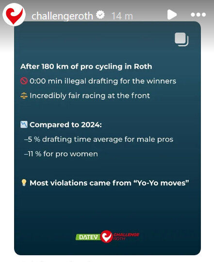

To back up an earlier comment (dragged across), here’s the Challenge Roth graphic on the 'gram:
And here’s their longer analysis:
Pleased they have made the effort to compare the data with 2024. Though a 5% reduction in the average time spent in draft zone is fairly small beer.
