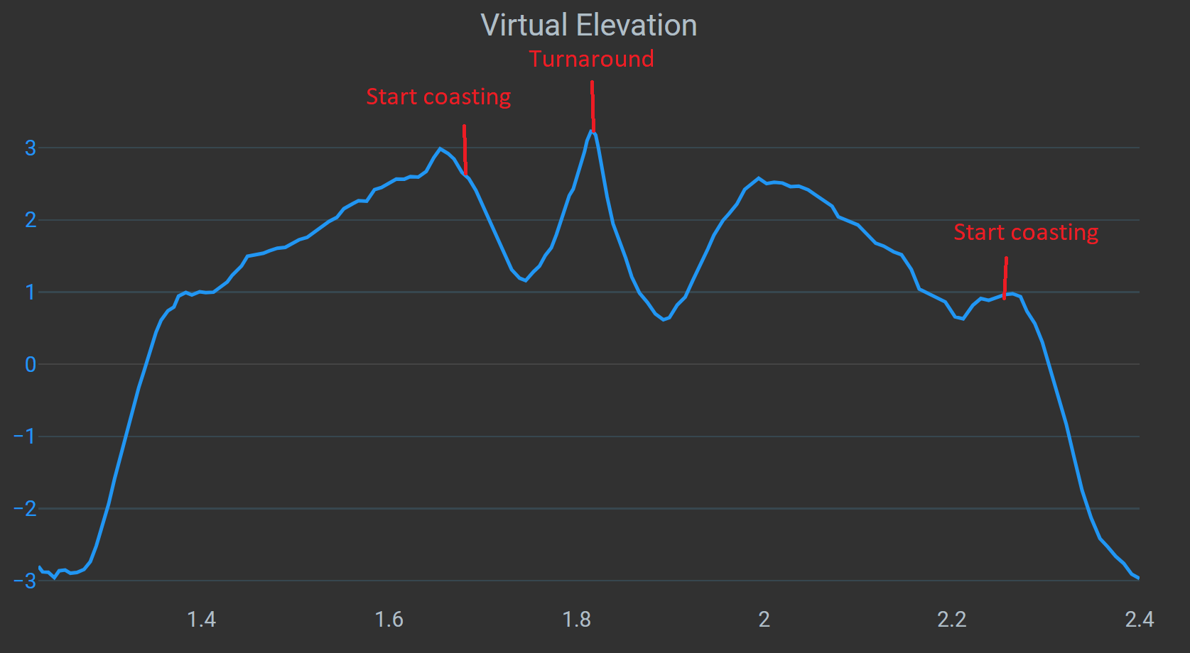

I’m hoping to get a little help troubleshooting my protocol. I am currently setup using a wahoo elemnt bolt as my ride recorder, garmin vector 3s as my power meter, and a garmin speed sensor 2 as my speed sensor.
My course is an out and back with an initial climb and then a short downhill and immediate uphill, both of which I coast to lose enough speed to turn around on the uphill without using any brakes. I’ve got my start/finish position chalked on the road as well as the start, apex, and finish of my turnaround point. I use the lap button on each start and finish and use that to cut out the turnaround back (in red) to the start as I have to break hard to turnaround on the start/finish portion of my test area.
I’ve been out testing a single position on 3 different days so far and have yet to come up with consistent results from any of them. Each day of testing has had very little wind. I recognize that I’m on a single sided powermeter which isn’t the best, but is I would think that having a muscle imbalance would skew the cda results and that I wouldn’t have an inconsistent enough imbalance to make the results as unreliable as they are.
Any ideas on what could be making my lap not symmetrical comparing pre-turnaround to after turnaround? My first guess would be maybe some wind but each lap being non-symmetrical in almost the same way makes me doubt it. Could I have missed a recording setting that smells like smart recording? I’ve got my speed sensor set to use the specific wheel circumference but haven’t found any settings for the powermeter that would suggest fishy recording. Or does it all come down to using a single sided powermeter?
Any help would be greatly appreciated. Happy New Year.

In you precise description, you didn’t mention if you ride on the middle of the road, which is a necessary condition (but potentialy unsafe one) to have symmetrical elevation profile.
I also have non-symmetrical elevation profile here (red curve: use of a barometer with a +/-10 cm precision) during a low wind day (virtual elevations corrected by airspeed from an anenometer). It may be explained cause a road is not perfectly level from a side to other (or some other reason that I am also interested to know too).

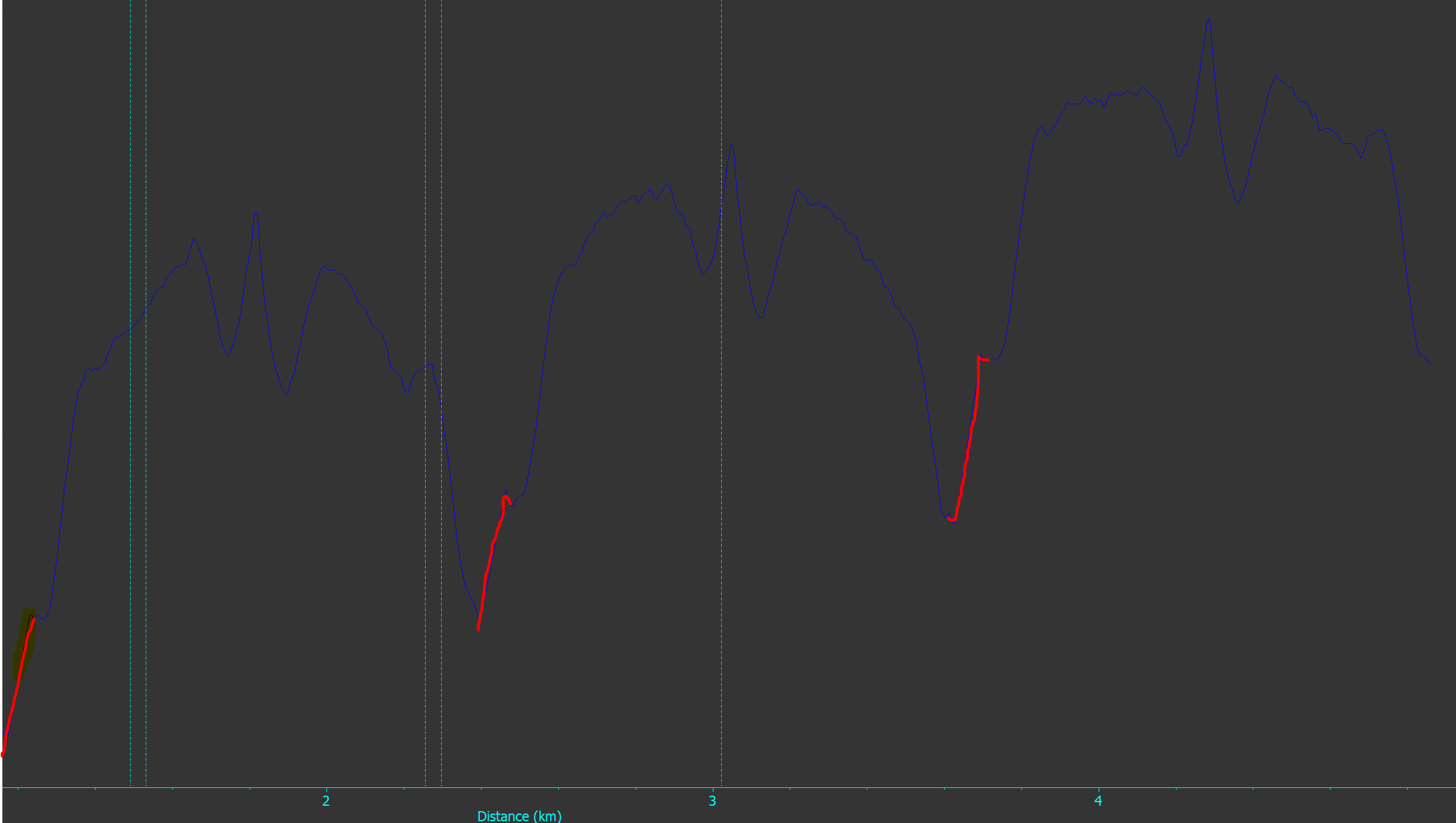

Just to clarify, it looks like the 2nd image was a Golden Cheetah screenshot? What was used for the first image?
The first one was mycda.app. Golden Cheetah doesn’t seem to import my laps in the correct spot and mycda.app does while also automatically isolating the laps. Using mycda just makes it so I don’t have to manipulate my data to remove the between laps section.
Oh, I didn’t realize that I was supposed to be going center but that makes sense for the asymmetry, thank you. As far as the lack of precision in results, I am beginning to suspect either my speed sensor accuracy or how the elemnt bolt uses the speed sensor. I have the elemnt set to use the wheel circumference instead of the “auto” setting which still uses some gps. However, my lap distances still vary by up to 26 feet in a set. What sensor do you use and/or is there a gold standard that people tend to use for aero testing? I’ve seen a lot of mentions for the gsc 10 but was having trouble getting my hands on one so I had settled for the garmin speed sensor 2.

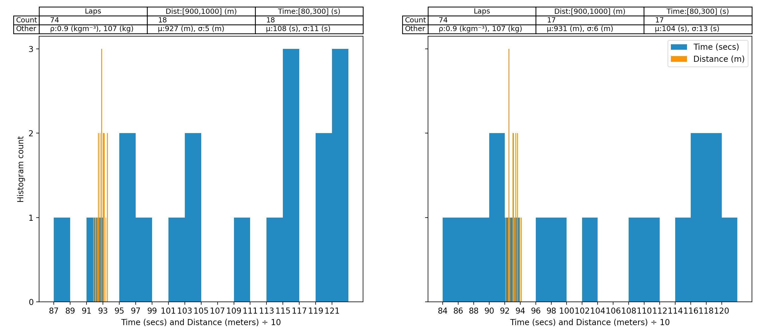

I wrote some simple code to implement the VE method. And tested whether it revealed the difference with a visor (and without). I rode a lumpy 1km “half-pipe” loop about 30-odd times, varying the speeds a bit. I do have a braking zone at one end as I turn around. So I hit the Lap button each time on my Garmin. My code inspects the .tcx file and throws out brake zone laps and keeps the “loop”.
My code can flatten the graph automatically etc. Seems very straightforward to code up and I get a family of solutions (Crr, cdA).
I also find a difference without/with visor. (Not a tri-bike or regular bike but still method applies.) So far, so good.
Then, because I have varying speed runs, see histogram, I graph all the (Crr, cdA) pair solutions over a range of Crr.
I pick the pair that has the least overall deviation for the top3 fastest and slowest runs.

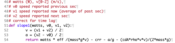

Anyway, I have a simple question about the slope equation formula. I notice the Crr part doesn’t take slope into account for simplicity.
Given an incline, Crr is conventionally defined with respect to force normal to the incline, so shouldn’t we multiply by the cosine of the slope?
If I do that, the VE curves look significantly different. So I must be missing something.
See handwritten picture with f(s) = 0 and f’(s) for the revised formula. I solve numerically for s (slope).
Plotted, the deviations are initially small, but as you can see in the last picture, they add up and the VE graph looks different, formula vs. formula2.

Sorry, I forgot to append the slope formula and modified with cosine slope formula to the previous post.
Here’s the code in Python, I can write it in any programming language, but Python is accessible to anyone and easy to read.
Just in case I made a silly error.

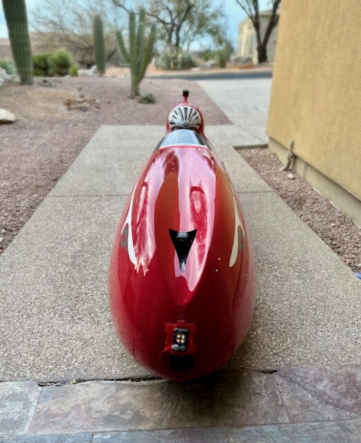

Not that it’s relevant, but I’m using something a bit more aerodynamic than my road bikes.
It’s the same principle at work.
I’m testing the effectiveness of the visor in this picture.
