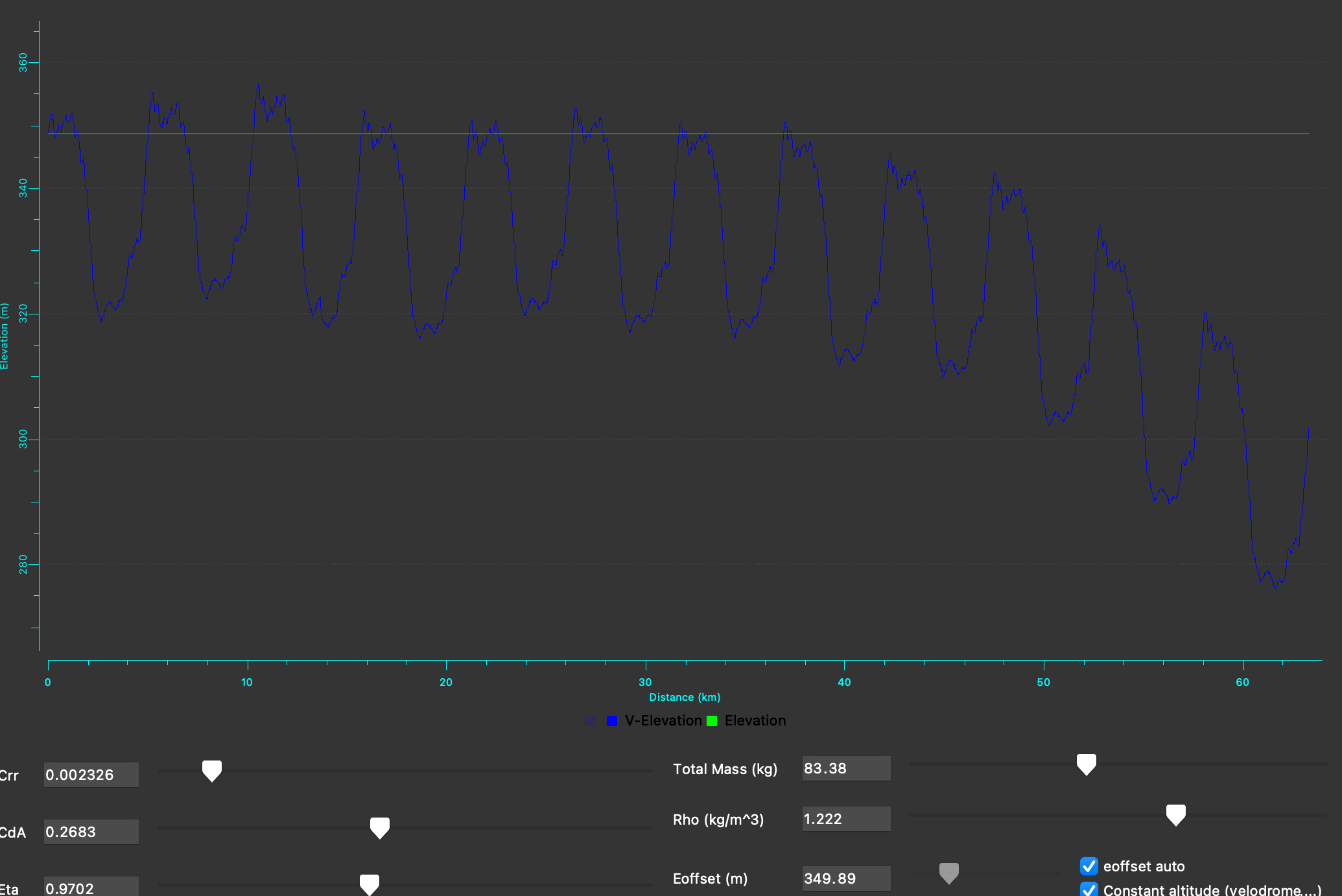

Im not sure if this has popped up in previous pages but I occasionally get a noticeable drift that makes some tests useless. It usually ends with position B almost always being faster than A. I know the easy answer is to go ABBA but I usually save those for recovery weeks.
Does temperature effect the VE calculation or possibly my Quarq numbers? Here is an example where the temp dropped more than what is likely (Starts at 34 before stabilizing at 28) - https://www.strava.com/activities/4682092261. I also went out today on an endurance ride and noticed the temp started around 61 and dropped until it stabilized at 52. The actual temperature was 60. The funny thing is that I dual recorded using a Garmin 520 and a Wahoo Bolt and both had the same temp drop. Full disclosure - I rode with GPS on both but even still the cda drift is pretty significant. I would have to move the density slider from 1.22 to 1.16 to get the start and end to show similar numbers.
Possibly, but temp affects air density the wrong way: a 9 degree F. drop in temperature should increase air density a little. So I’d be looking at tires or your power meter.
You could do a couple of things. I would try to get hourly weather data and see if things are changing over the 2+ hours. Look at barometric pressure which will greatly impact air density.
Also look at wind. You may have more of tail wind contribution in the 2nd part of the ride. I am not sure what your ride look looks like. Is it out and back or some kind of loop ?
Maybe look if there has been a big change in zero offset of the Quarq at the beginning and end of ride. You used to be able to do this with a Quarq, not sure you still can. Can you zero during the ride ?
Is this pattern reproducible ? Knowing that would help narrow things down.
That is a low CRR you are using.
Im using a 3 mile loop with decent tree coverage. I shorten them to half laps when I do proper testing.
I’ll try to do ABA with my pedal power meter added to compare with my Quarq and see if I can tease anything out. I wish it were reproducible but some days I get really clean data and other days the last position is ~10 watts faster.
The CRR was just a random number. I usually use around .005 for my training setup.
I am not certain if this really matters but I notice you have constant elevation velodrome checked as on. What happens if you check the auto correct and the constant elevation check boxes to off?
