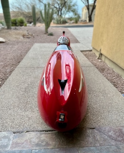

What is the vehicle ? Where/how is power measured ?
Not that it’s relevant, but I’m using something a bit more aerodynamic than my road bikes.
It’s the same principle at work.
I’m testing the effectiveness of the visor in this picture.
Ok, such fully faired recumbents can have really low cdA (for example see attached paper, unfortunatelly in German).
Crr of 0.0035 - 0.0040 is possible.
Velomobil_cdA.pdf
Dear Maracag, I believe I posted a picture of the vehicle above after my initial message. It’s in an attachment. If you can’t see it, I can email it. And I mentioned I’m using Assioma pedals. And front wheel alignment is accurate to the mm level. Thanks.
