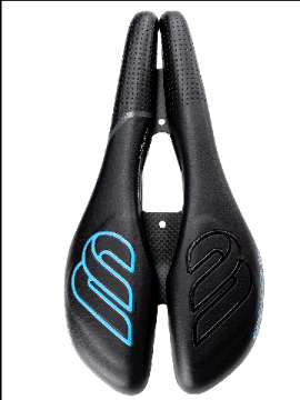

I’ve tried several saddles over the years, including an ism, specialized power comp and bisaddle. I’m currently riding the bisaddle.
I am 6’6” tall. So I imagine my “sit bones” might be a little wider than the average person. Im not sure how or if that factors into this. This is why I’m currently on the bisaddle, since it gave the freedom to make the saddle a little wider than the ism I was on previously.

The pain is truly your butt and not your grundle or ball area? If so, I would hope that your resolution would be easier to solve than pain in the taint area. This might be totally off the wall thinking but I’ve definitely seen a saddle that has two independent sections on it for each butt cheek rather than it being one connected saddle. Any chance you’ve seen or heard of those before?

That is the bisaddle the OP is on today.
