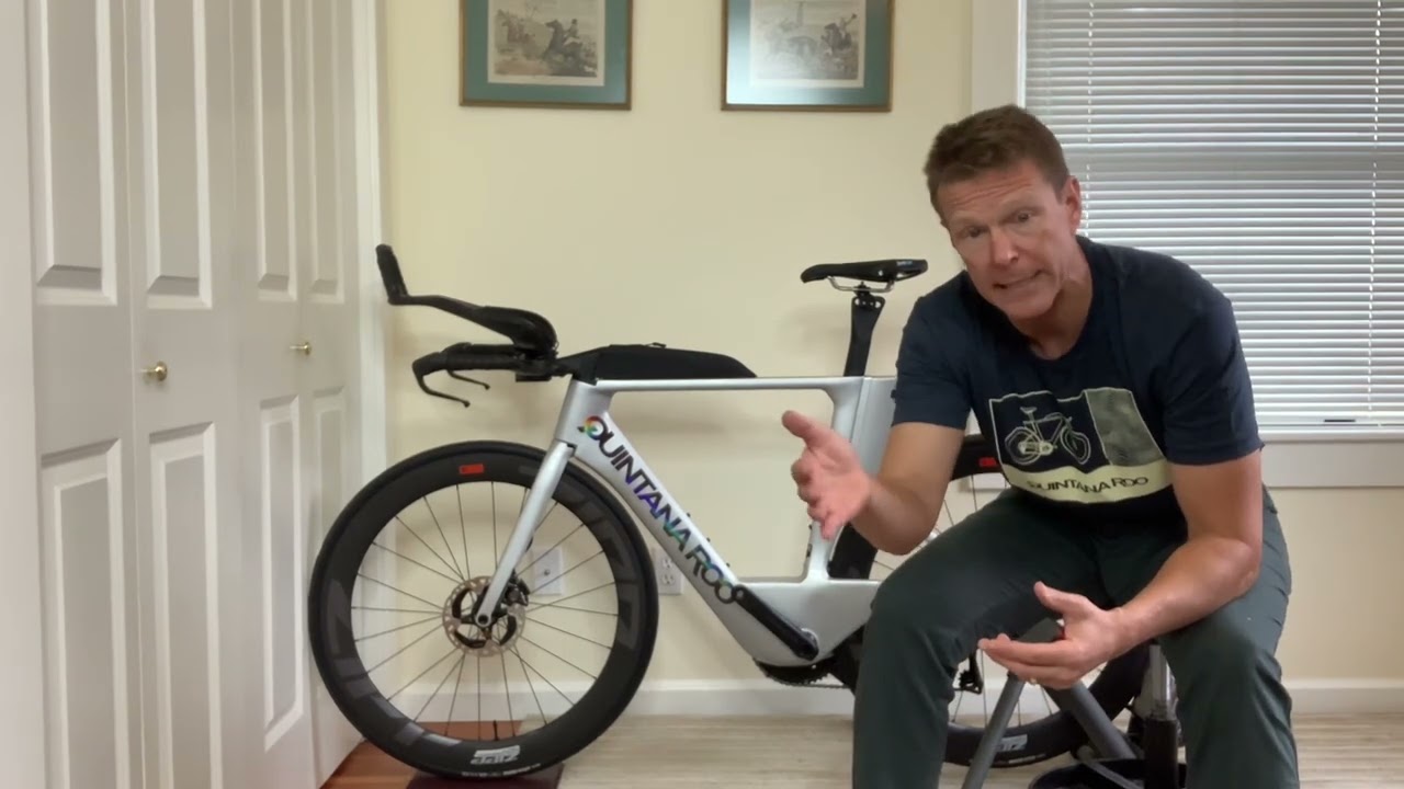

If the “reference an old bike” approach intersts you. Take a peek at this short video as to how you’d do it.
