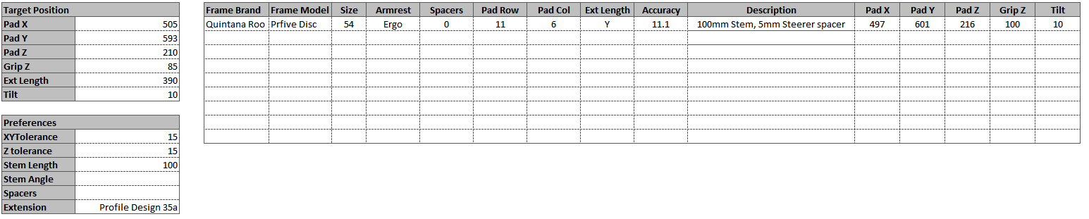

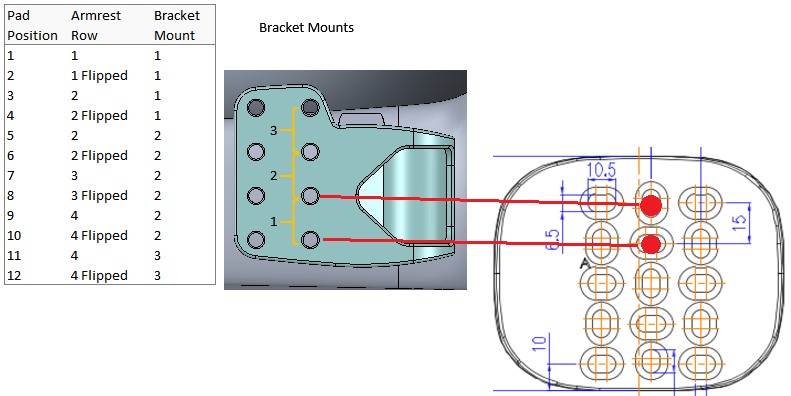

Your target position can be fairly closely matched on the 54 PR4
(PR4 is same geo as PR5, I just haven’t added it as a separate name in my database yet)
5mm steerer spacer means one of these with no other spacers: https://speedandcomfort.com/collections/top-caps/products/copy-of-5mm-top-cap
Pad Row 11 means the 2nd most forward config
No need to worry about pad col as you’re happy with width
Note that I modified your Pad XY to be to the rear of the pad
Basically you need the bars fully slammed and nearly all the way forward. You’ll likely need new extensions if your bars came with T4C (definitely if they were cut) as the new generation ones are longer, a 400mm extension gives a max length of 376 (on x axis, so will be fine on diagonal).

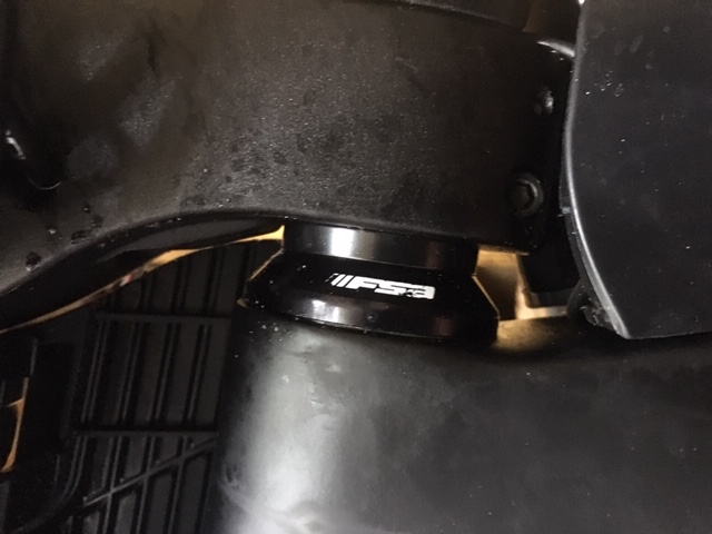

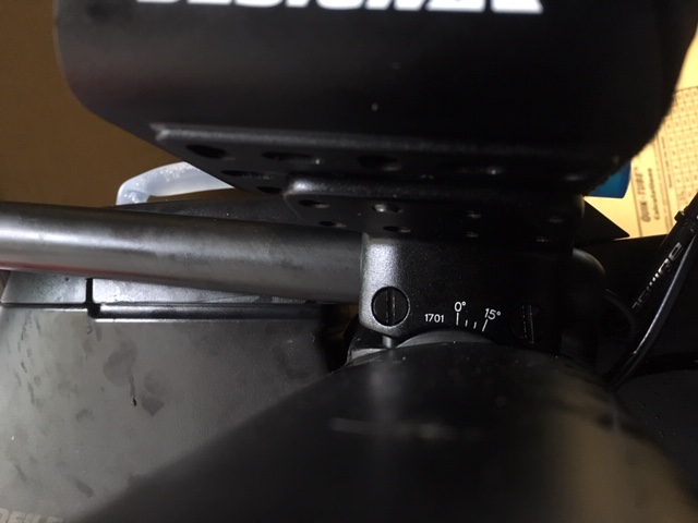

Thank you, cyclenutz! I appreciate your help. The 400mm bar extenders makes sense to achieve the proper reach. I’m still not sure how I can lower the stack from 650 to 600. The current top cap appears to be 15mm (photo attached), so a new 5mm cap will lower the stack to 640mm. There are currently no spacers on the bars (photo attached), so it seems to be as slammed as it can go. I’m not sure how to achieve the final 40mm in drop with the AU bars. Thank you again for any assistance.
Greg
At this point I’m going to suggest that you remeasure the Pad Y. The only way I can see that setup being at 650 is if the frame isn’t a 54.

Yes, that was it. My measurements were way off. Thanks again!
Thank you, Ian. My poor measurement skills were to blame! It’s where it needs to be.
