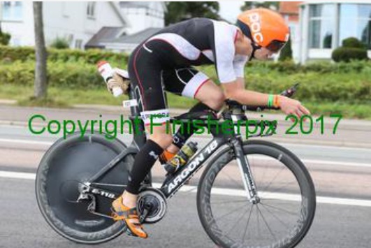

Thanks for the amazing service provided here - much appreciated. I’m looking for some advice on a P3x. Doing 70.3 and 140.6 events.
Coordinates taken from current bike, Argon18 E118 (2012) with 172.5mm cranks. Crappy pic attached for reference. Note that I moved saddle up by probably 10mm vs when the picture was taken.
Pad Reach 420 (to back of pad)
Pad Stack 610
Pad Width 240 (outside-outside)
Saddle height 760 from center of BB
Height 178cm / 5’10
As can be seen in picture, most comfortable position is when I don’t hold my extensions but let my hands hang loose (I know, the aero disadvantage is real…). Holding extensions or tilting my hands upward in general seems to put some pressure on my shoulders. I can for sure hold it, it’s just not super comfi. Probably means non-tilt position on P3x cockpit would be preferred.
Curious as to your advice - thanks.

The reason tilting you hand up puts pressure on your shoulders and makes you uncomfortable is because you’re tilting your hands up. Tilting your hands is not the point, is not what you’re supposed to do. Like, my hands are high, but not because I raised just my hands up. High hands is besides the point, an output not an input, a symptom not a cause. As it stands, you’ve got a late 90’s or early 2000’s world tour TT position. No need for that, we’re not limited by UCI rules in Triathlon. There’s a hack you can use.
What you need to be doing, or rather, what the point is, the objective, is that you want to open your shoulder angle by adding reach. As you open your shoulders your hands indirectly and naturally come up. It’s a byproduct. Then, the bike holds you, instead of you holding the bike.
At your current given stack and reach you’re barely on a size M in PX series bike, almost off the back end. But if you were to agree that what I’m suggesting is the thing you’re actually trying to do, you’d be at Pad Stack of 610 (still) and a Pad Reach of 460mm at least, which would put you in the center of the range of a size M or in the bottom left quadrant of a size L. You’ll need to tilt the pads of course to catch you and to match the open angle of your shoulders and your forearms.
Make sense?
E
Makes perfect sense. At least in the abstract I get the anatomical implication of higher hands by increasing pad reach. On paper I would be very curious as to how ‘in control’ I would feel on my bike – I’m not the best bike handler tbh. Probably what you were referring to with your comment me holding the bike and vice versa. Also curious how supported my upper body would feel with pads not directly underneath. Like, “hanging in your skeleton” like now versus requiring constant tension in abdominal muscles to hold position (which is how I felt last time I tried sliding the pads forward). But then again, I can see how that relates to your point of tilting the pads to ‘catch’ me. Something I would have to try out and feel.
Probably the open shoulder angle would give some aero advantage as well, as it may allow me to tuck my head a bit more.
Anyway, my take-out is that size M is the safe bet here. After which I can start playing around with pad reach and tilt. Nice!
