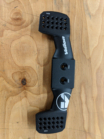

I have attached an picture of the adapter.
Kevin, can you confirm if this is for the EX10 monoriser, it looks like it is.
That’s definitely for the EX10, the bolt orientation and shape of the P5X one are different.
It’s indeed for a ex10 riser. A nice platform to mount other semi custom extensions on it

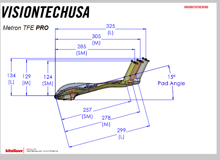

The TFE Pro is not UCI legal. The Pro would be 124mm to 134mm depending on the size of the extension. The TFE would be be below the 100mm UCI limit. It falls in the 75mm range.
Kevin
The height measurement, per UCI regs, is taken from the center of the pad, not the rear, as shown in the diagram in a post above. If the diagram is accurately depicting the measurement as taken at the back of the pad, then there should be no problems with the UCI regs, if you are okay with taking a little off the ends.
My measurements are accurate to the UCI regs and not the diagram.
