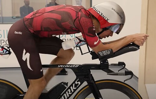

Another example of current bike’s limitations. This stem is crazy long, can’t imagine how the bike will handle.
source: VL wind tunnel testing
Shiv TT is a baby sized frame, VL would be better going with a brand that cares about Tri.
Bikes handle surprisingly well with long stems, esp on TT bars.
The steerer tube has always made me nervous in those situations tho. The lever arm is very long
Concur…
Long stems are not an issue at all. The bikes handle just fine. The concern are long carbon steerer tubes and custom aluminum parts fatigue cracking due to torque stress.
Buy yes, frames today should be at least offered in a long reach option even if only in size medium.
I actually snagged one of these for AliExpress for my road bike (the other way round, negatove 12deg) Only time it gets awkward is standing up to climb, but once you’re used to it it’s okay. Otherwise it handles exactly normally. Tbf I paired it with 35mm bars, so the distance hand -to-steerer isnt too different than a normal stem on 40’s
I’ll be in pro crits with it this summer and have the slightest hesitation about when the front wheel squirrels a bit in corners, but that’s a bridge to cross when we get there.
