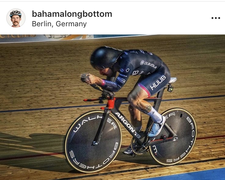

Assuming it attaches properly here’s AL in Berlin on his new Argon 18 EP. If not, here is the link to the photo. https://www.instagram.com/p/Bqs1nNLFMuD/?utm_source=ig_share_sheet&igshid=1kxsty1wu3elp
I’m not sure their association with Argon but they have said it’s faster than the T4. Looks like Victoria Pista Speed tires, Giro empire or Bont shoes depending on the rider, suits of their own design - maybe made by huub(?), various Wattshop custom cockpit goodies (saw a wind tunnel photo of a mono riser but everything else is still two risers), Rule 28 socks, SRM Track cranks and maybe a Notio Konect?
