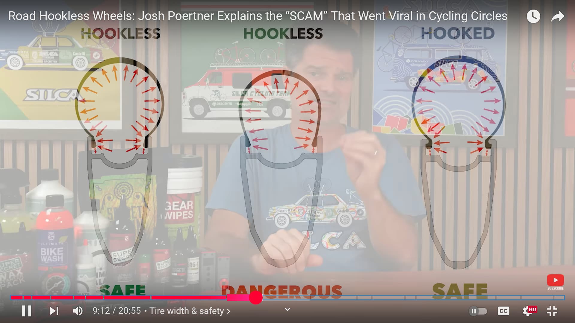

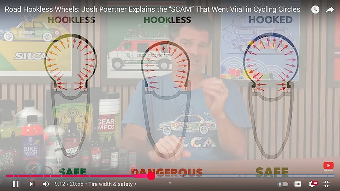

Video description (edited):
Are road hookless wheels safe?
In this video, SILCA’s Josh Poertner explains why he believes hookless road rims:
  • offer no improved aerodynamic benefit,
  • carry tubeless blow-off risks, and
  • push the limits of ETRTO safety margins.
He also responds to the cycling media coverage following his Marginal Gains Podcast statement that hookless road rims are a “scam.”
Josh’s claims (road use):
• No Improved Aerodynamic Benefit: No measurable real-world aero gains over hooked rims; in some cases, aero performance is worse.
• Safety Risks: Tire blow-off risk at pressures as low as 78–80 PSI, with narrow safety margins and tire/rim compatibility concerns.
also covers: • The tire width vs. rim width rule (Rule of 105, ETRTO guidelines) and why it matters
• [asserts] the need for at least a 5mm tire-to-internal-width gap for safer hookless road use situations
• Tire sizing inconsistencies between brands that complicate safe fitment decisions by consumers
Watch the full Marginal Gains Podcast episode where Josh made the attention-getting statement here: link

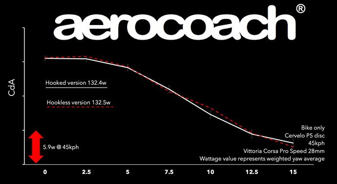

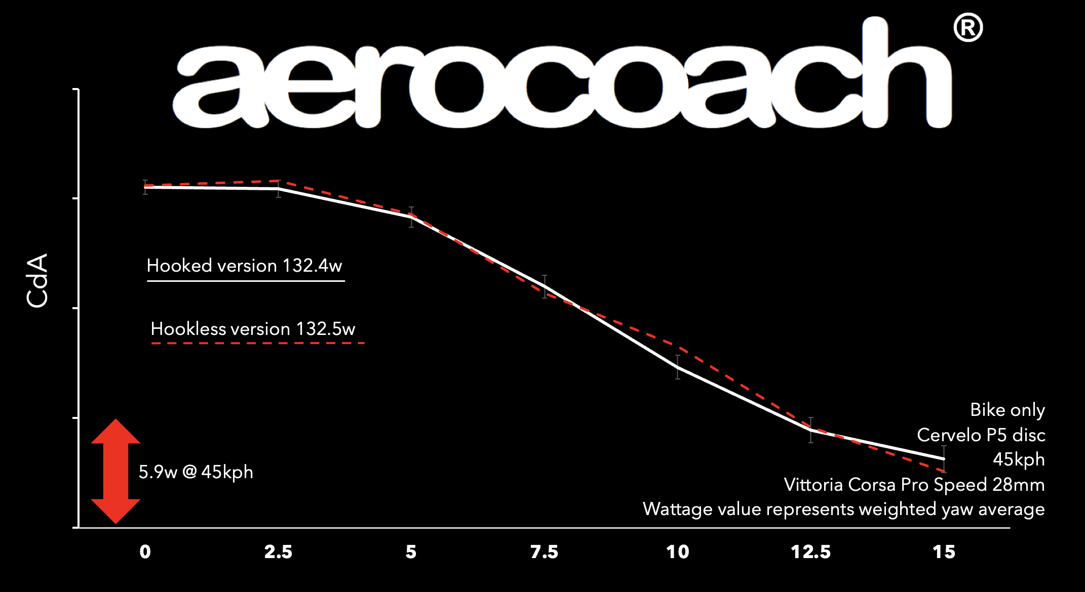

Just to add some data to this, we’ve also found no improvement in aero with hookless rims. Here’s a bit of data from an upcoming wheel we’re releasing, hookless and hooked version:
I’m guessing a good clarification for that graph would be how you made it hookless; did you remove the hook (making a wider internal width and hence slightly wider tyre), or did you fill in material below the hook (same internal width and ~same tyre width)? I’m guessing the former since the test would not be super relevant if the latter…
We kept the tyre bead in the same place internally, there’s a tiny tiny change to the lower corner inner radius when you do that for the hooked version but for the hookless obviously we removed the hook. Basically we did what we would do if we were making a hookless version of the wheel, aha
