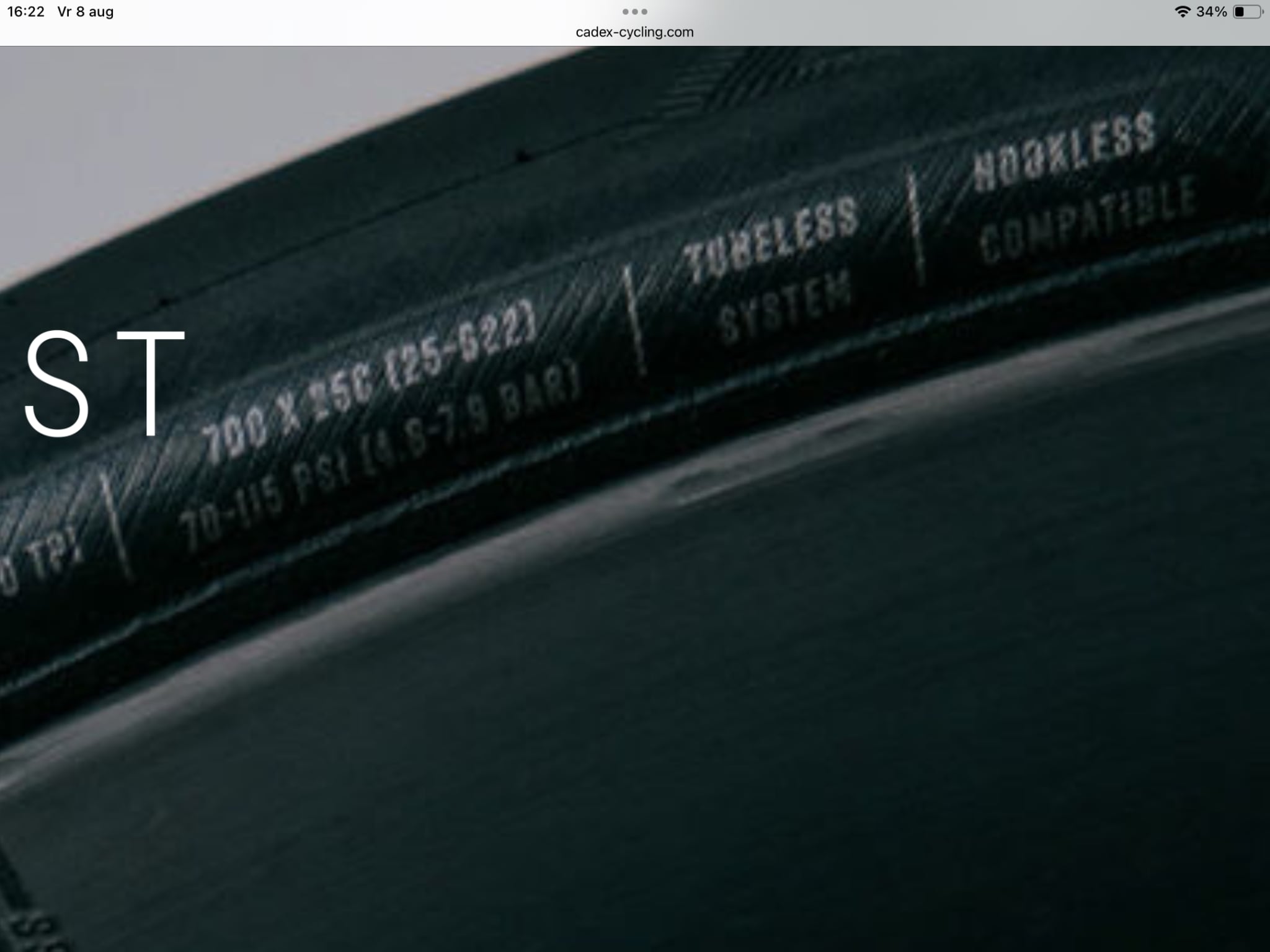

You see what that tire reads in your picture, ‘tubeless system’ not ‘hookless system.’
Like any brand Cadex wants to make tires that fit all wheels, hooked or hookless. They are not built for exclusive use on hookless wheels.
Hooked wheels that uses these tires can have higher pressure. That is faster, we have explained you that as often I assumed you understood by now and the tire can handle that, that is what that means, hookless cannot. That why it only reads ‘tubeless system’ and not hookless system on the tire. And the new tires have, hey, look at that, an extra piece of text…hookless compatible.

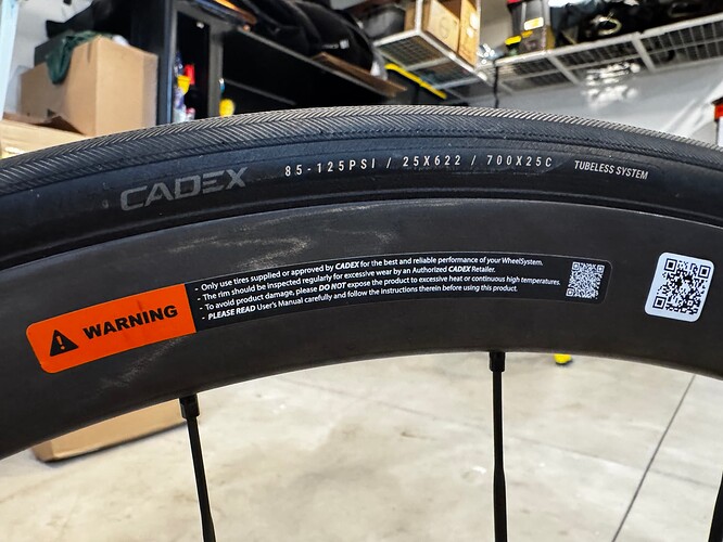

1. Please note that the stated MIN pressure on many current CADEX tires (e.g. 85psi for 25C tire) was originally defined based on a durability test with a 120kg load at 1.5 times the regulated distance. CURRENTLY, for all CADEX tires this minimum (MIN) pressure can now be defined as 70 psi (4.8 bar) for 23C & 25C tires, 50 psi (3.4 bar) for 28C tires and 45 psi (3.1 bar) for 32C tires. Never inflate to less than the MIN pressure.

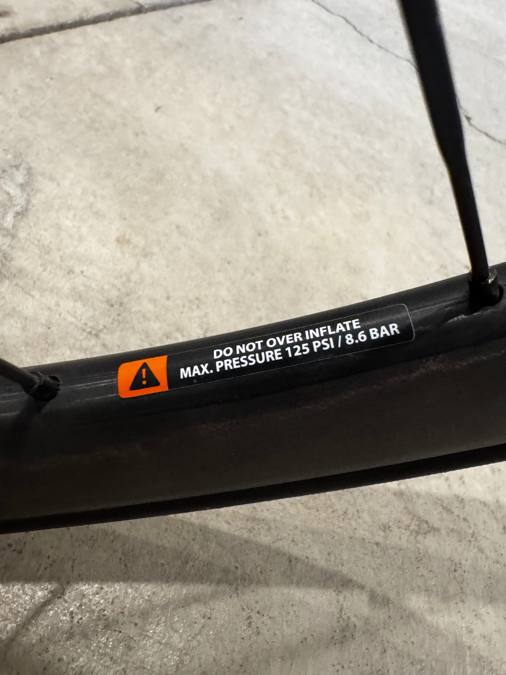

The decal on the rim, as I was once told by Cadex, is to make sure people don’t go over this pressure to get their tires properly seated.

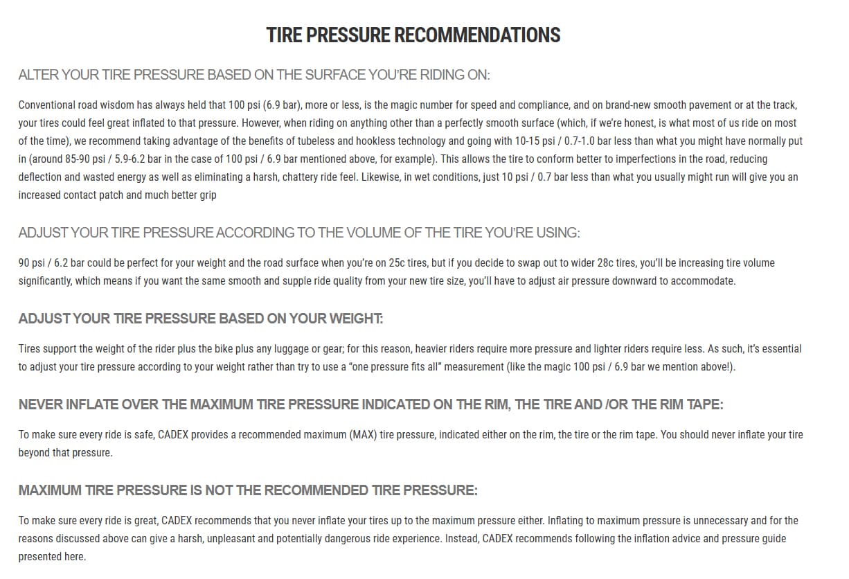

See how it reads Tire Pressure Recommendations and not Hookless Tire…

Hookless… CADEX Wheel… Max Tire Pressure 125 PSI
CADEX Tire… Max Pressure 125 PSI

You read it as if you can apply that pressure to a hookless wheel which you can’t, obviously, very big safety hazard, but I’m not going to rewrite the post again.
