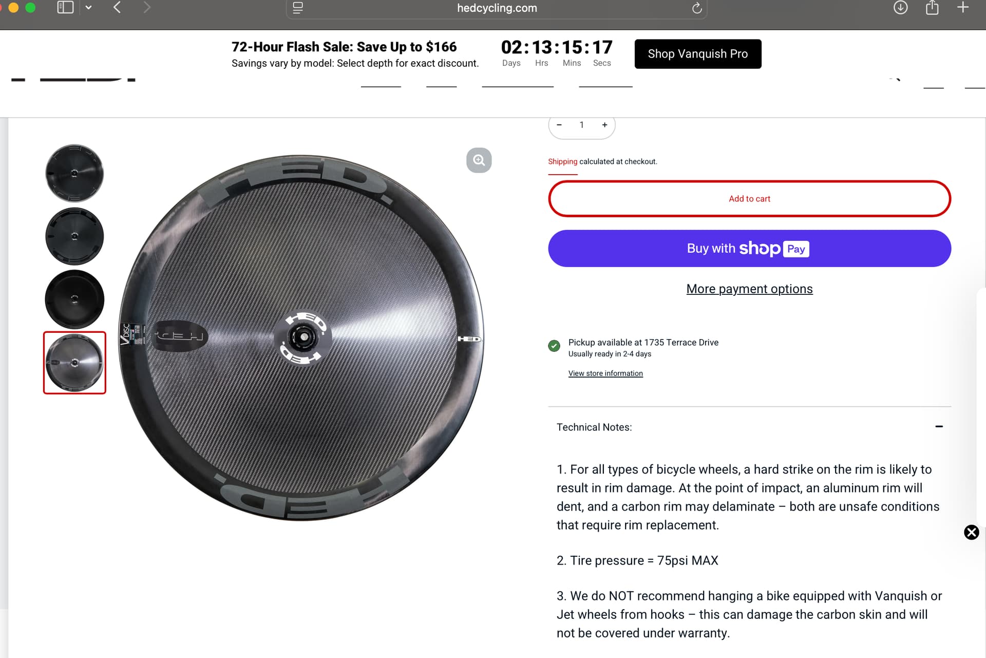

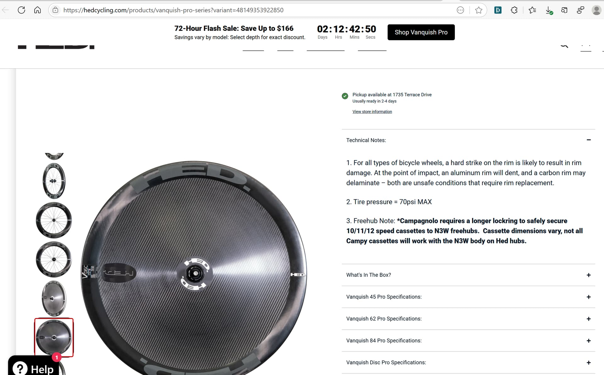

Vanquish pro( Vanquish Pro Carbon Wheels | Made in USA – HED Cycling Products):-
Max Use:
25mm tire: 70 psi / 4.8 bar
28mm tire: 67 psi / 4.6 bar

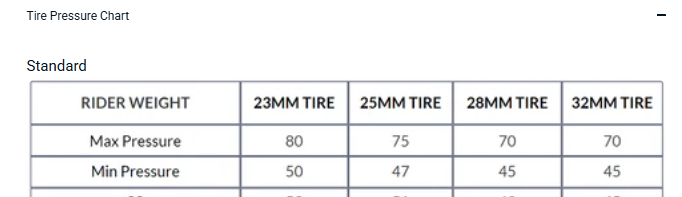

Non ‘pro’ are max 70psi for 28s, 75 for 25s.
Unless there’s an error on HED’s website (or I’m misreading) in which case it cost them a possible sale. (actually, no 75/80 still too low for what I was wanting to buy), 90 for 28 would have been ok, not that I wanted to run at 90, but that was my criteria to buy.
This is what I was going off…

And this is what I was going off
If you zoom in it even has 67/70 in the picture you’ve posted from Vanquish Pro Carbon Wheels | Made in USA – HED Cycling Products
Not arguing with you, more that HED’s position on pressures/ HED’s website is a hot mess.
