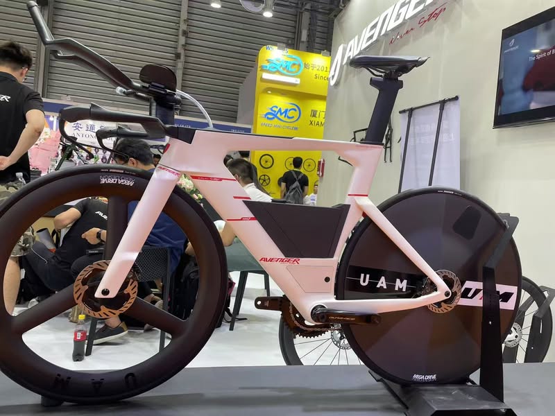

HongFu Avenger Tribike 2025
Seen at the Shanghai Bike Show 2025 on now
Canyon+Trek+BMC (all rolled into one by the looks of it)
Saw it on a facebook feed, can’t find any other info on it.
A touch of QR VPRi too!
Good looking bike
Is that an enormous hydration bladder inside the triangle? Also has a toolbox integrated in the triangle.

They responded with some more pictures and a geometry chart.
What do you guys think of the geometry?
Top tube and reach look longer in comparison to other frames.
I have had an open mould before. ! have always found them a little on the heavy side and put that down to extra carbon layer-up, instead of R&D.
Did they give any info on frame and fork weight?
Yeah, I thought the same about the geo, but given that everybody is trying to get more reach. The long top tube a steep STA seems pretty modern?
I’m definitely no expert, I have zero experience actually riding a TT-rig. Would love some insight from the actual experts on the forum.
Regarding weight. I asked about weight, tire clearance, handlebar setup and the storage box and only got the geo chart and some pictures back. This is why the communication is so difficult and slow with these companies :sweat_smile:
Yes. is what everyone is looking for, so it is good in that respect.
Also that the frame hydration tank is removable, which will be beneficial for shorter distances if you only want to race with bottles.
And no idea on price?
I just looked at their site and the previous model frame-only is going for $1800 USD. I’d guess $23-2500 USD for this one, but that’s purely speculative.
